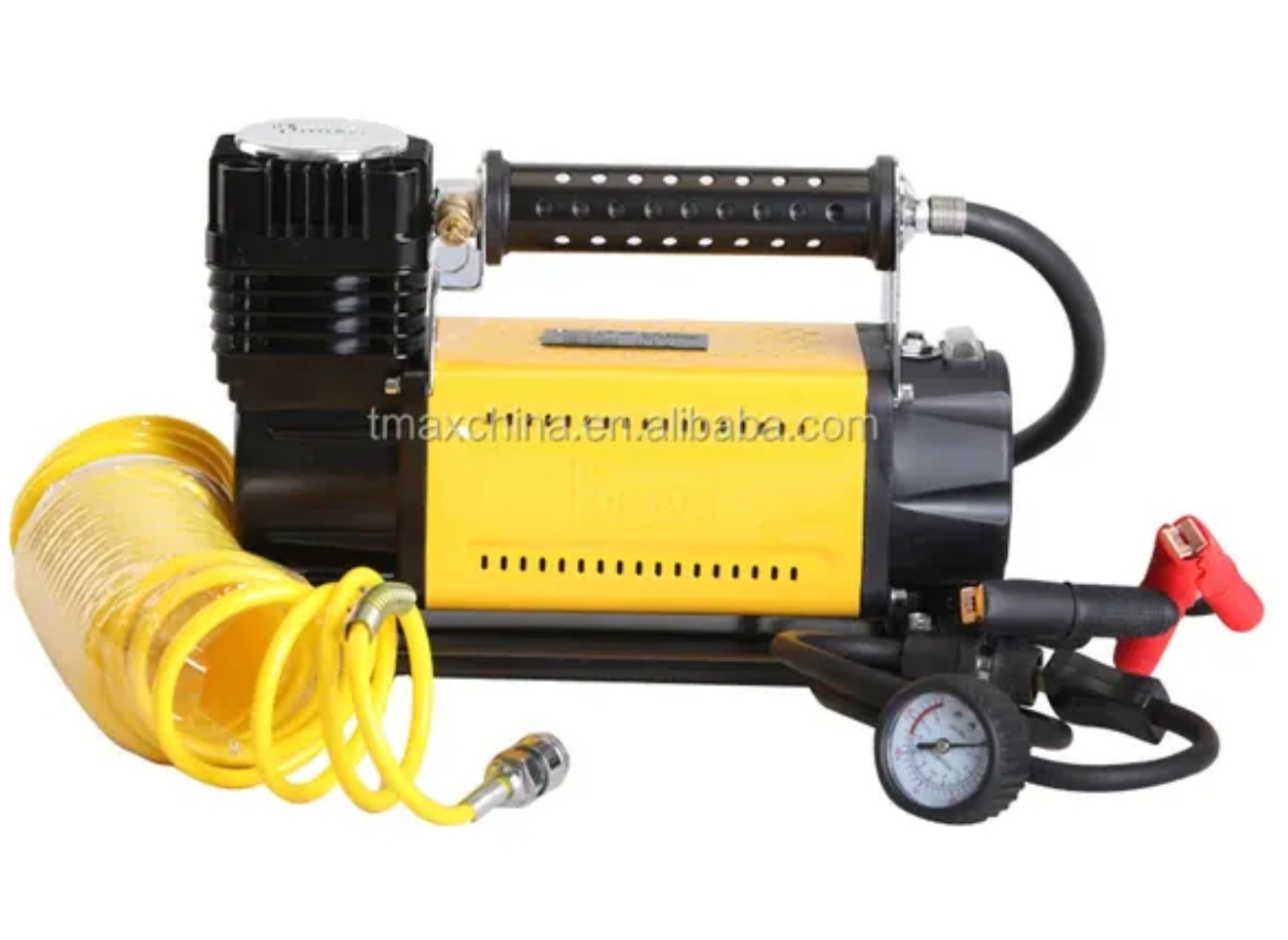

I use one of these Tmaxx compressors on the motorhome/landrovers/works etc ...
Not cheap,not light ...
BUT an absolute beast of a thing .

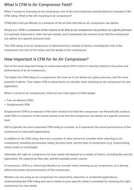

Fromwhat im reading not one of you understand compressors, as i stated the CFM is most impotant
So say a comp as normal will hit 125psi as most are set to, if the cfm is low it would take much longer to inflate a tyre, and will have a tiny electric motor.
And this will have to work hard and life span will be short doing big tyres, always look for the highest CFM when buying a pump, it will have a large motor
And very heavy electrical leads, probwont run of a cigy lighter socket,it willhave to be croc clips direct to the battery.
Many comp shops never tell you the CFM but state a tank size,this is a hoodwinkdont fall for it.
