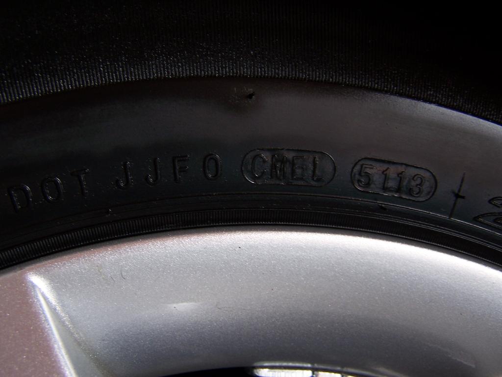

They should look similar to this, it is 5113 which equates to the 51st week of 2013.
It might be on the inside wall of the tyre if it`s been fitted that way round.
I always tell the tyre fitter to make sure that date code is on the outside then it is easy to find and read.
