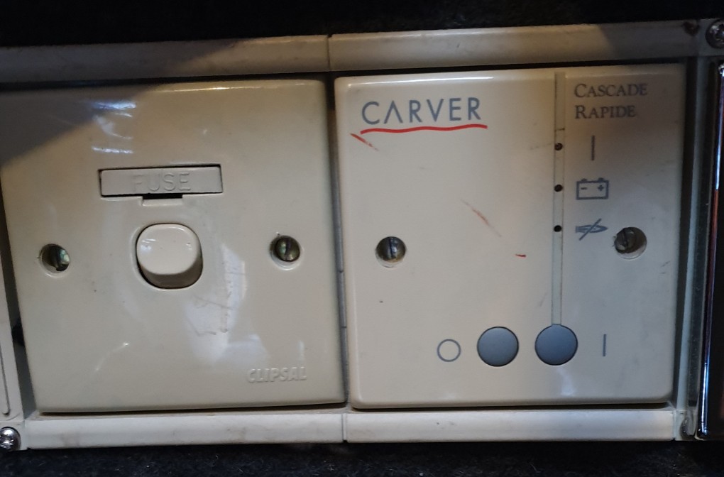

Have a Carver Cascade in the Mercedes, seems to work alright on 240V but can't get it to work on Gas and not sure where to start. There is 12V Going to Unit and Gas Supply but not sure how the ignition would work.
Here's the control

Dont know if this might help Raw, but it's been a good many years since I worked on a cascade, when I used to own a Swift Challenger caravan 😃.
  • Thank You
Reactions: RAW
I seem to remember vaguely that dust rust and crap had fallen over the burner and was stopping the ignition of the gas. Phil
  • Like
Reactions: RAW
Is it like gas fridges with spiders webs stopping them as well? Clean burner and flu as Phil mentions?
  • Like
Reactions: RAW
Just like Phil and Nabism I had similar problems with dirty igniters and gas jets, hopefully all that yours needs Robert is a darned good clean, I also pricked out the jet using a very fine bit of brass wire. Can you actually hear the piezo igniter working which should be a click, click, click sound?
Phil
  • Like
Reactions: RAW
Phil
No click or anything - No lights on the control on 12v - whereas there is on 240V
Think I need to go through the wiring again and then give it a good clean by accessing from outside as advised
Thanks for all the help guys

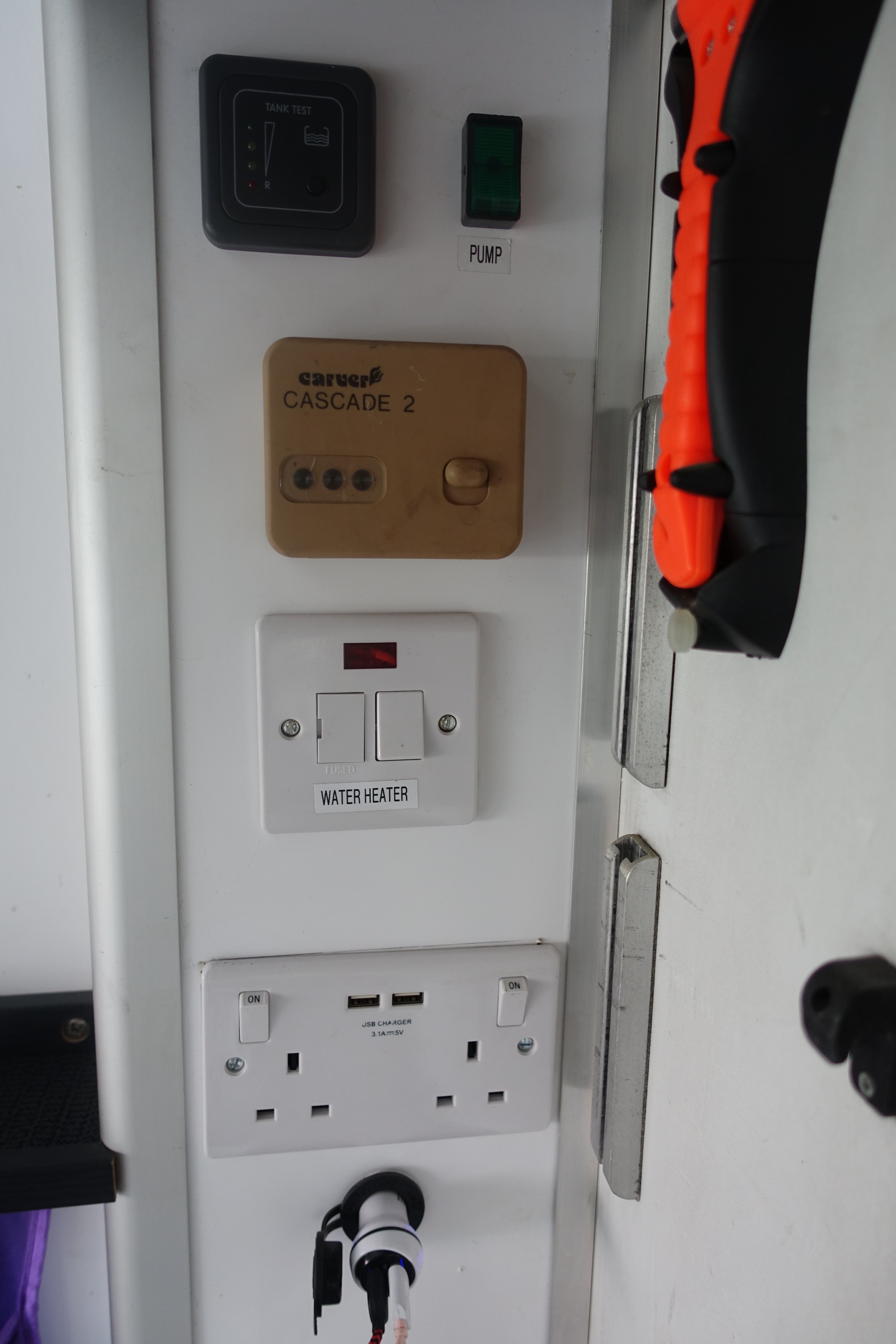

hi. i don't have the 'rapid'. mine is the '2' and the gas ignition control is the brown box. 3 lights, red for fault, amber for ignition, green for working. never ever failed. even on electric 700watt element works fine. don't give up on it. good luck
