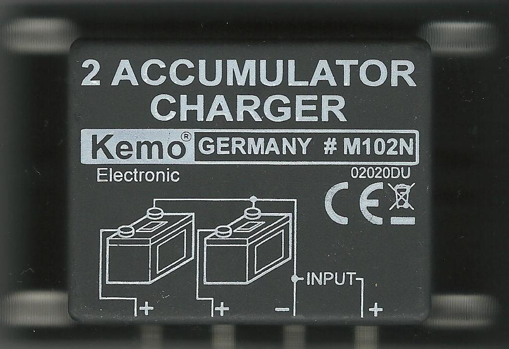

i use one of these split charge units from one charger.from ebay about £15
