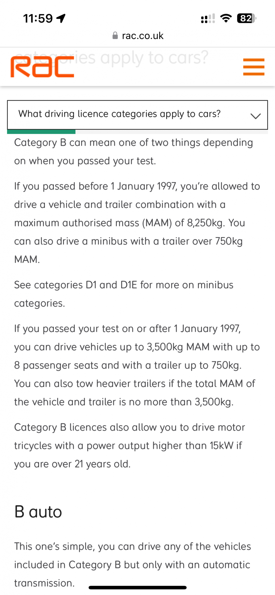

Can someone settle a disagreement I have with a friend?
He has a 3500kg motorhome but because he tows a trailer, he thinks that the trailer is part of the gross weight of the vehicle and therefore, as he is over 70, every 3 years he has a £120 medical to keep his 7.5 ton license!!
Surely you can tow a trailer up to the permitted towing weight that the motorhome allows without an upgrade in license?

Category BE​
You can drive a vehicle with a maximum authorised mass (MAM) of 3,500kg with a trailer.
The size of the trailer depends on the BE ‘valid from’ date shown on your licence. If the date is:
  • before 19 January 2013, you can tow any size trailer within the towing limits of the vehicle
  • on or after 19 January 2013, you can tow a trailer with a MAM of up to 3,500kg within the towing limits of the vehicle
Nope, he needs to look at the gross train weight (on the slam panel) and if it is OVER 3.5t with the trailer he needs the medical etc

No, nothing to do with the plated weight, it's the physical weight, if the 3.5t plated weight is actually (unlikely) only say 2t then in theory if his licence allows he can tow up to 1.5t
I'll be another who thinks he is wrong.
My understanding would be. You can drive a vehicle with max 3500GVW + a trailer up to the vehicle GTW, but no more than 8.25 tonnes.
Most 3500 kg vehicles (certainly not the ones many MH's are based on) wouldn't a GTW as high as 8250 KG though.
That’s my understanding but Pudsey seems to think it is just a total train weight of 3500kgs. I am quite confused!!😩😩

Category BE​
The only thing he missed is that for unbraked trailers the trailer MAM is 750 kg irrespective of your licence date.

My MoHO is MAM 3500 / GTW 5000, my unbraked trailer 500kg
As I said (I think) it depends on his licence if he doesn't keep it he will be limited I let mine go but if I had kept it my GTW would be 7.5t with a 4 wheel braked trailer, or was when I drove a 3.5t sprinter with a 4 wheel braked trailer almost every day, maybe it's upped now.

"Category BE
  • on or after 19 January 2013, you can tow a trailer with a MAM of up to 3,500kg within the towing limits of the vehicle"
"Towing weight and width limits
Most cars have a maximum weight they can tow. It’s usually listed in the handbook or specification sheet.
Alternatively the vehicle’s ‘gross train weight’ may be listed on the vehicle identification number (VIN) plate on the car. This is normally under the bonnet or inside the driver’s door.
The gross train weight is the weight of the fully-loaded car plus fully-loaded trailer and must not be exceeded.
If your VIN plate does not list a train weight, you should not use your vehicle for towing.
Maximum width​
The maximum trailer width for any towing vehicle is 2.55 metres.
Maximum length​
If your vehicle’s maximum authorised mass (MAM) is 3,500kg or less, you cannot tow a trailer that’s longer than 7 metres."
