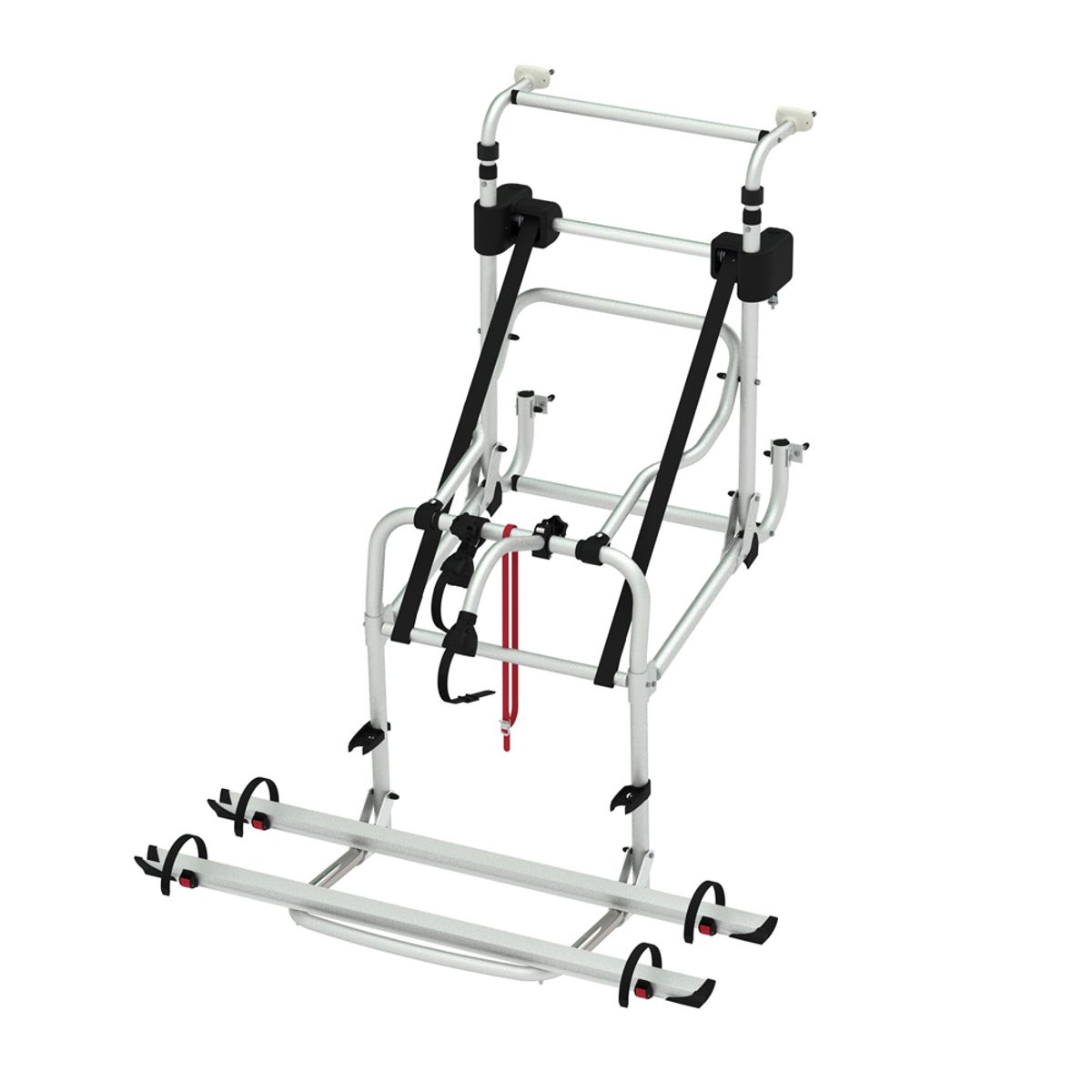

What you might need to be careful of Graham with a tow ball mounted rack like the one above if its very close to your spare wheel cover is how much it moves when on the go. Going over speed bumps, rough roads etc. I've seen some of these on the road and the ones I have seen (might not be the case with the one in the photo) do bounce around a lot and if its an inch or two from your wheel cover it could possibly damage it. I still reckon an adjustable slide out slide in one on the chassis will be best.
The spare wheel would be a good back up anchor point for the rack (I use a strap from the top of the bike to the door mounted frame). This stops it moving at all...

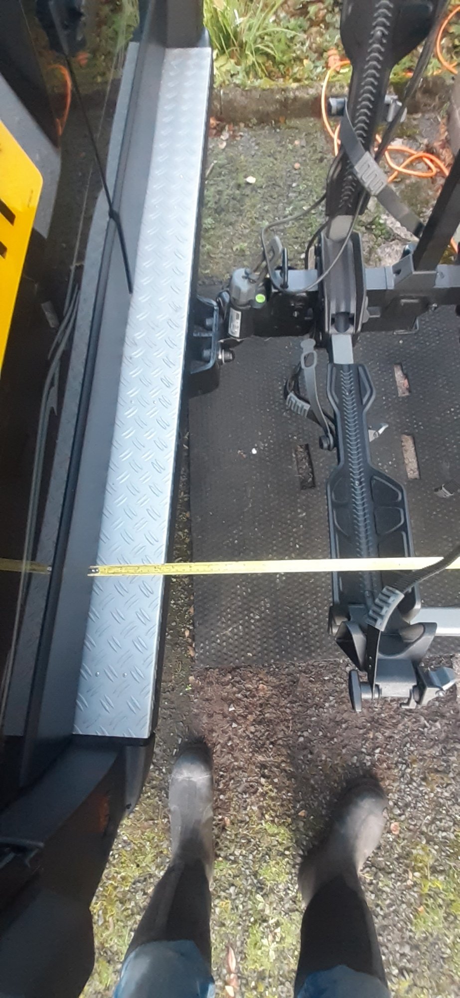

Just taken a pic of the rack with no bike on. This is on a citroen relay.
The distance from the face of the back door to the centre of the bike wheel 'track' is 40cm, so you could work out what space you have, given the 'thickness' of your bike etc...
hope this helps.
Swaying concerns me too Barry. I have yours in mind but I suspect a rack on the tow ball will be much cheaper (Can you PM me with the cost of yours?)
