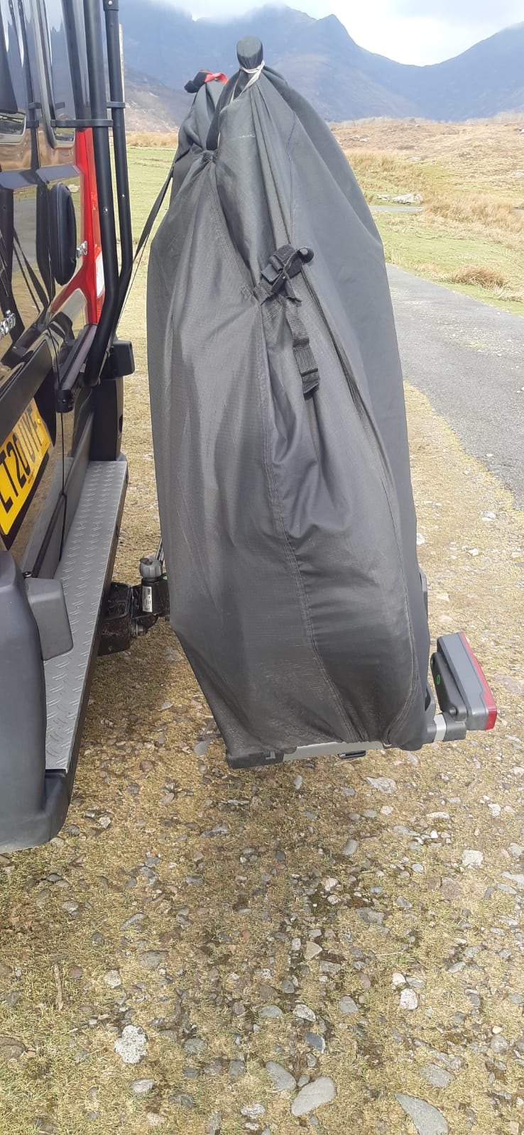

See Picture, but I reckon there would be clearance for a wheel, and there is no reason why the rack cant be angled (left / right) to give more clearance for the wheel mounted on one of the rear doors... In my pic, I have 2 Cube electric bikes (I always turn the handlebars 90 degrees so they fit easier).

Can the rack be locked in a non up-upright position? Slightly off upright by maybe 10/15 degrees?
What you might need to be careful of Graham with a tow ball mounted rack like the one above if its very close to your spare wheel cover is how much it moves when on the go. Going over speed bumps, rough roads etc. I've seen some of these on the road and the ones I have seen (might not be the case with the one in the photo) do bounce around a lot and if its an inch or two from your wheel cover it could possibly damage it. I still reckon an adjustable slide out slide in one on the chassis will be best.
No, it locks in the vertical position (for safety I suppose)..otherwise it swings down to, say, 45 degrees. (There is a catch you release to lower it)
