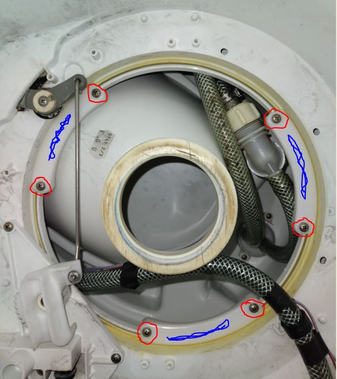

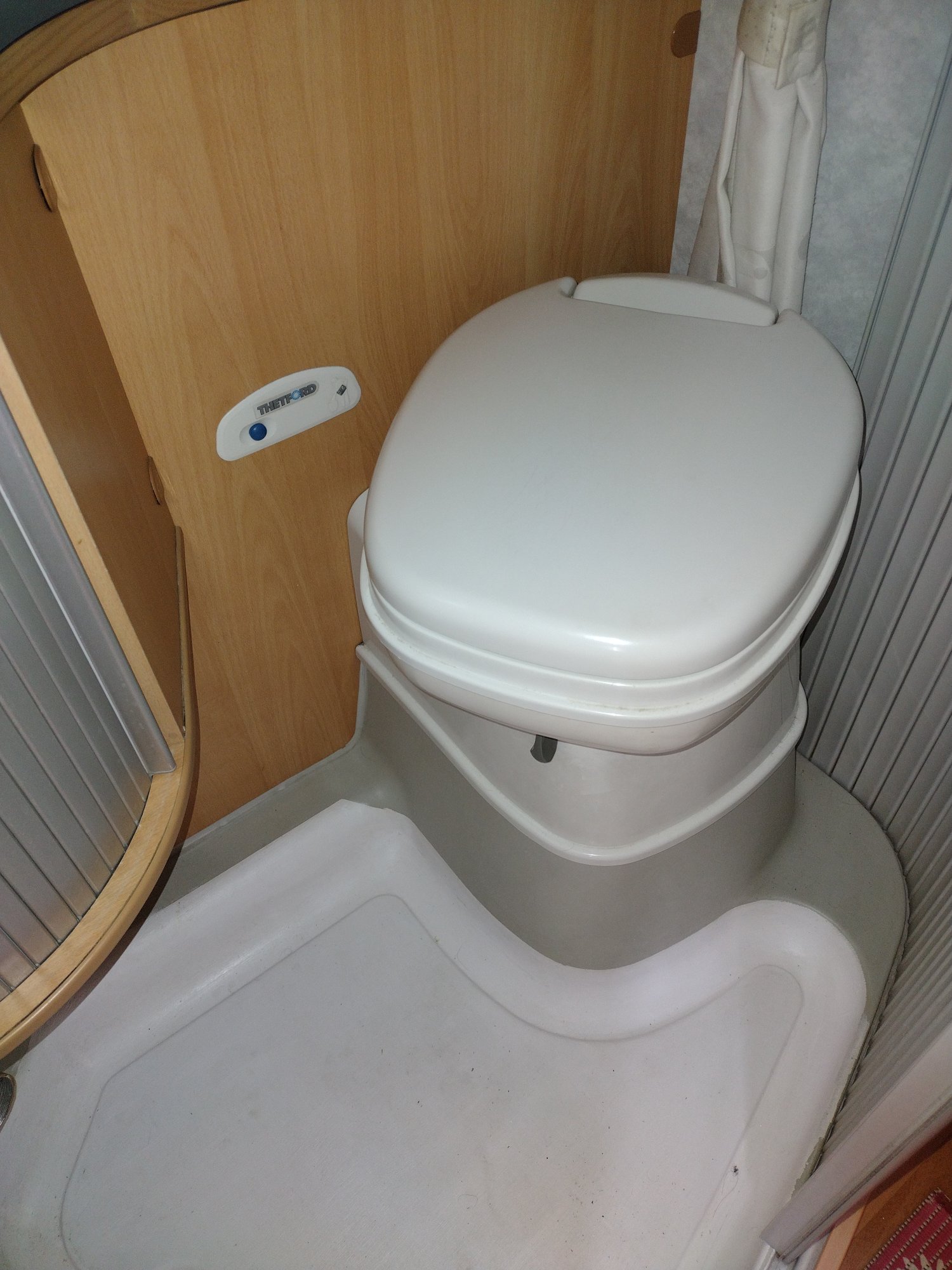

There is water in the toilet cassette locker. Luckily it is fresh water. It appears to be coming from the pipework / connectors under the toilet bowl - possibly from where the red arrow is pointing in the photo. The solenoid valve will be in there somewhere as well. The solenoid valve is working as it should - no water going into the bowl when turning a tap on and water going into the bowl when the toilet flush button is pressed.
The photo is looking up at the underside of the bowl in the locker, i.e. a worm's eye view.
I think if I remove the four screws circled in blue in the photo I should be able to get at the pipework / connectors / solenoid valve and find the leak.
But before I do this any thoughts?
It is a Thetford C200 C/CS where the flushing water is direct from the campervan water tank pump.

From my 'cardboard test' definitely leaking from the area around the arrow in the photo in my first post. I have some other jobs to do so it will be a while until I get my screwdrive out.
I will then send an update.

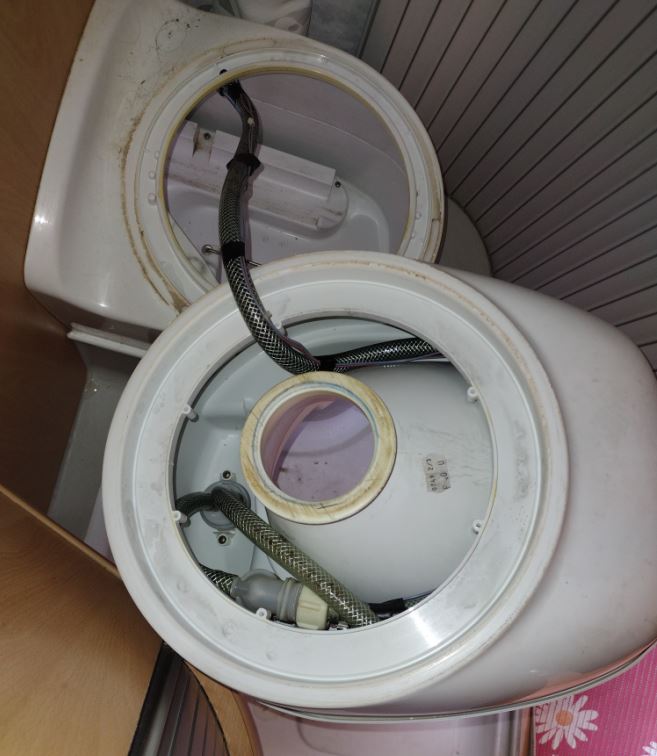

I have now had a closer look at the leak.

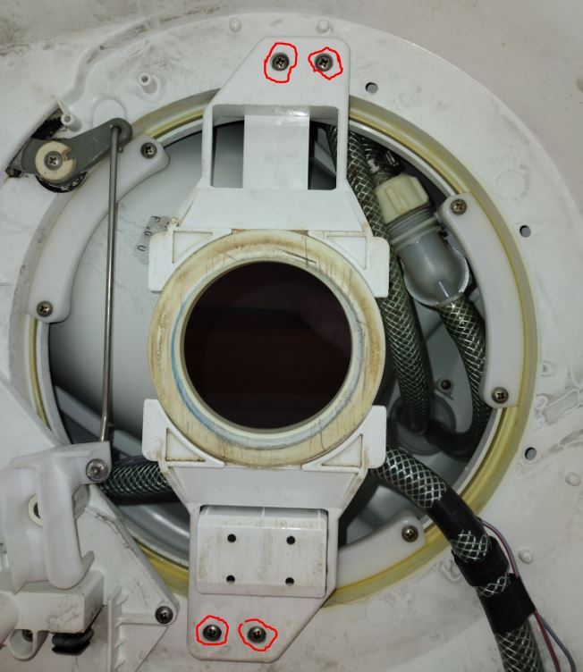

Removed the four screws marked in red to release and remove the two bowel retaining brackets.
Removed the screws marked in red and the three plastice pieces marked in blue to release the bowl.
Once released the bowl can be turned over to access the vacuum breaker and the electric valve. I connected a hose, not shown, to the flush nozzle and ran this outside through the locker door so that I could operate the flush without flooding the shower.

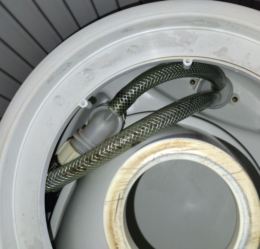

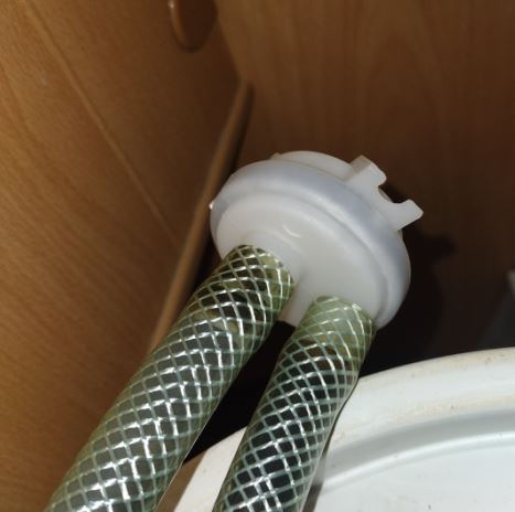

Electric valve on the left, vacuum breaker on the right.

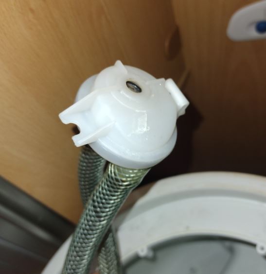

The vacuum breaker removed from its mounting. When I first used the flush with the vacuum breaker still in situ a lot of water came out. Since removing it each time I have used the flush only a few drops of water come, so maybe it is sensitive to being moved.
However as there are no leaks from anywhere else and the there is water coming out of the hole on the bottom of the vacuum breaker I think it's safe to assume that this is the source of the leak.
The solution is a new vacuum breaker ~£15. Or remove the vacuum breaker and join the two pipes together.
Either way as it's a job that has to be done blind, I used a mirror, within the locker It's not something I want to repeat
So I am inclined to fit a new vacuum breaker.
Vacuum breaker replaced and toilet reassembled. Fingers crossed that's fixed the problem .

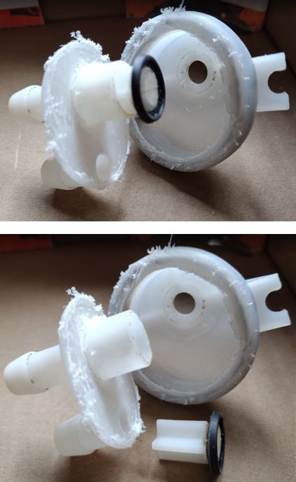

I opened the old vacuum breaker to see how it works. On the inlet side there is a plunger with a washer on the end. When the water flows the plunger / washer is pushed up and seals the air hole in the top. When the flow stops the plunger drops down. Presumably as the water in the outlet drops it draws air in through the hole. Not sure where the 'vacuum' would be.
I could not see anything wrong with the old one.
