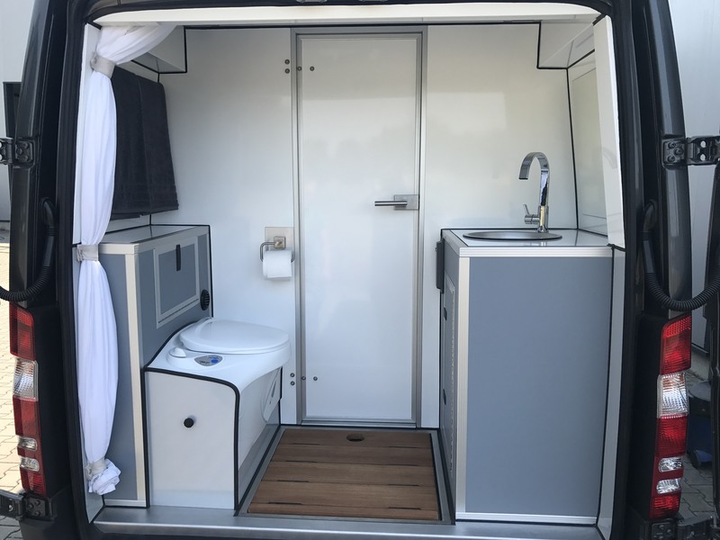

When siting the bathroom etc be aware there are chassis rails along and across under the floor.
I saw recently someone who done his own self build. He pulled out one of the dinette chair next to his sliding door to reveal a shower with tray, walls, mixer taps the lot It was genius !!
I never seen anything like that before, but he admitted he genuinely didn’t do a plan he made it up as he went along !

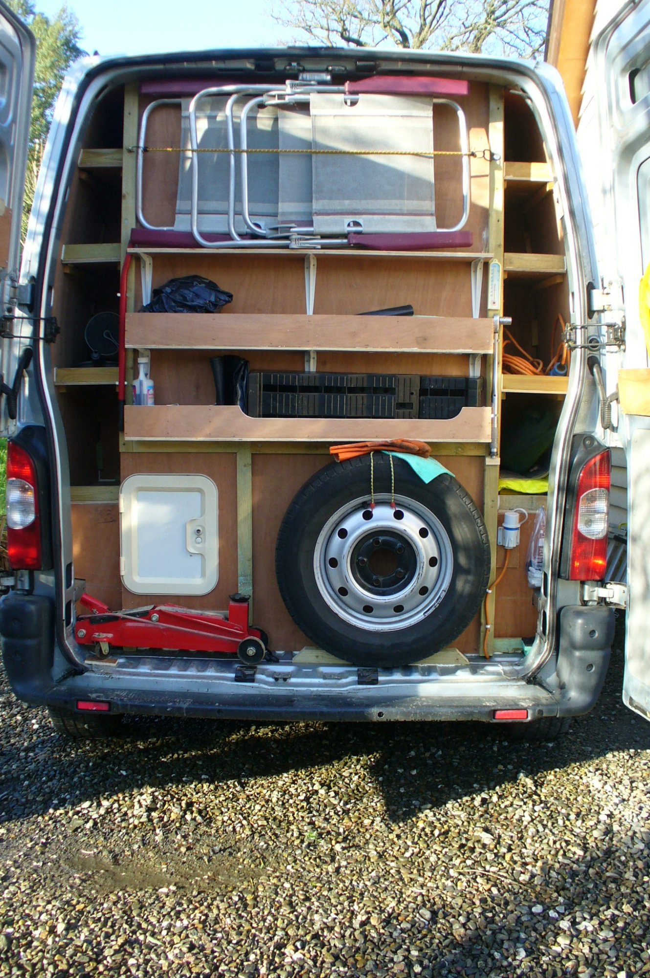

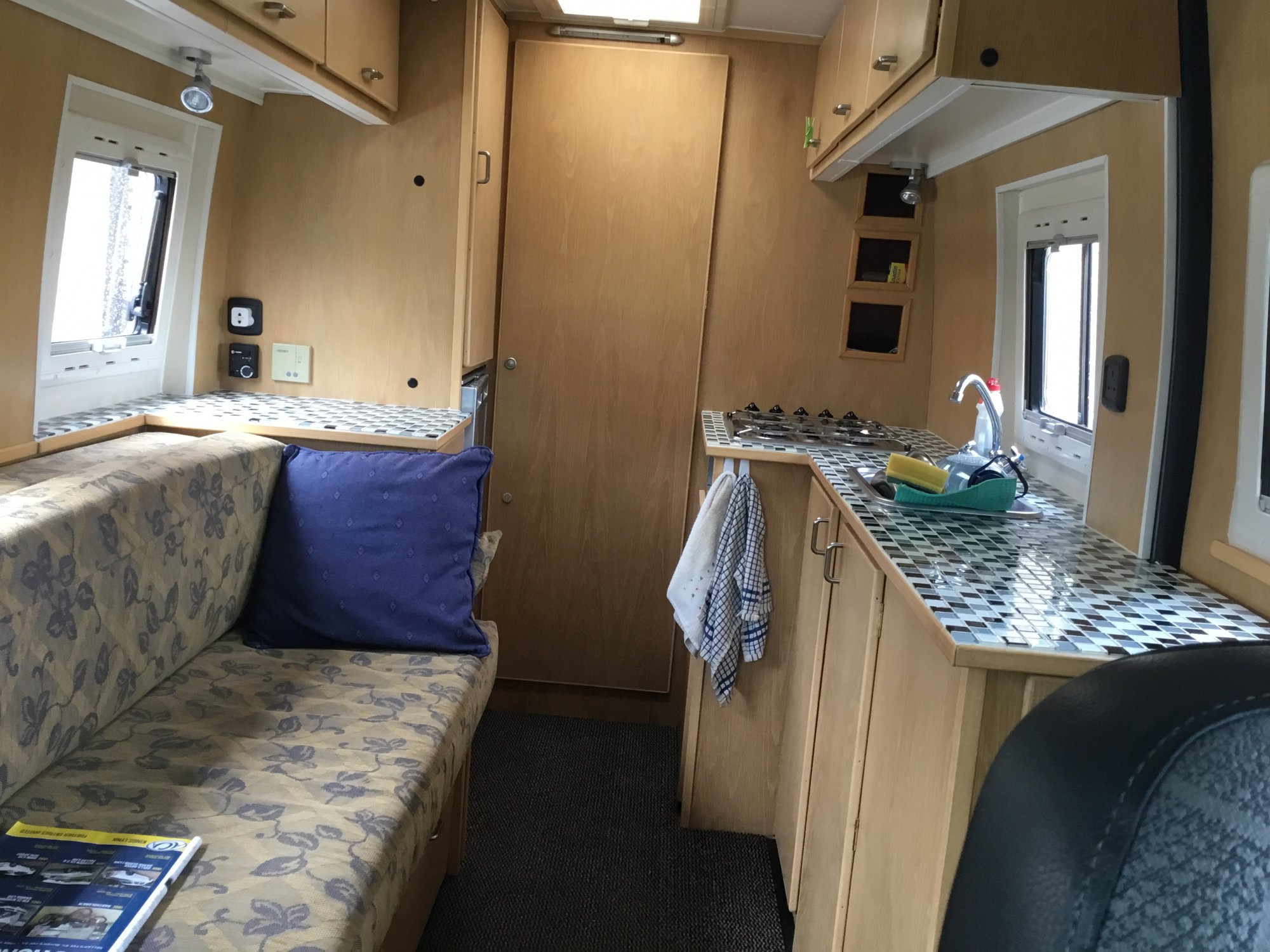

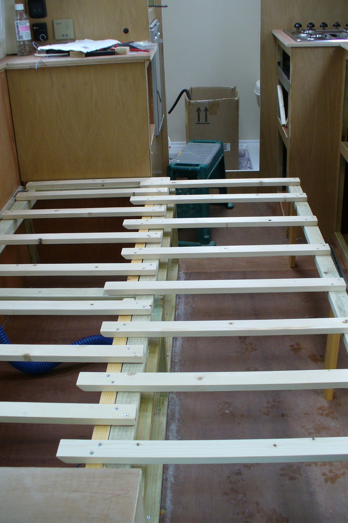

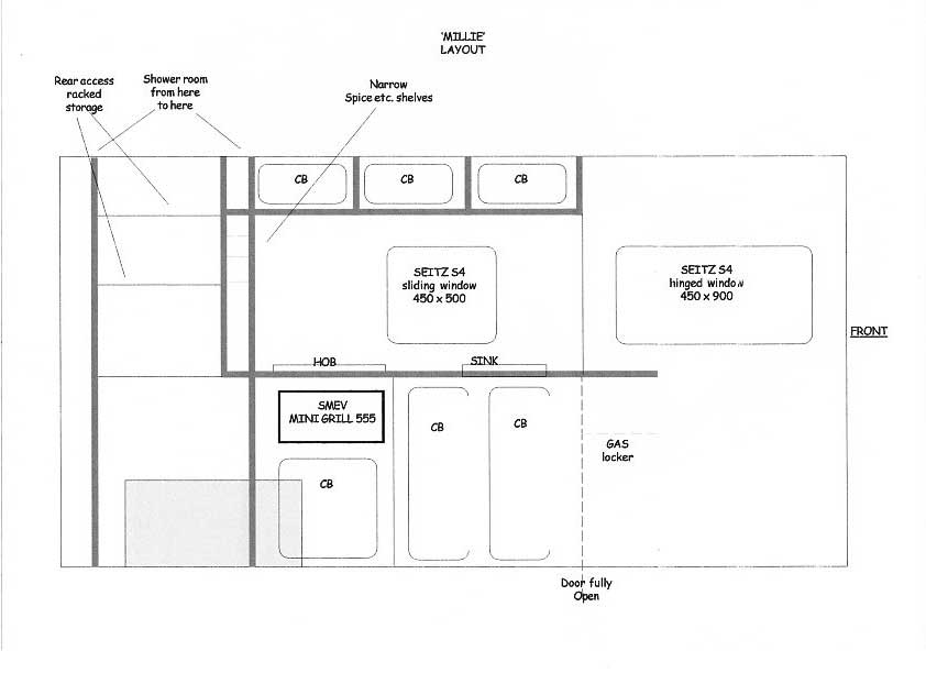

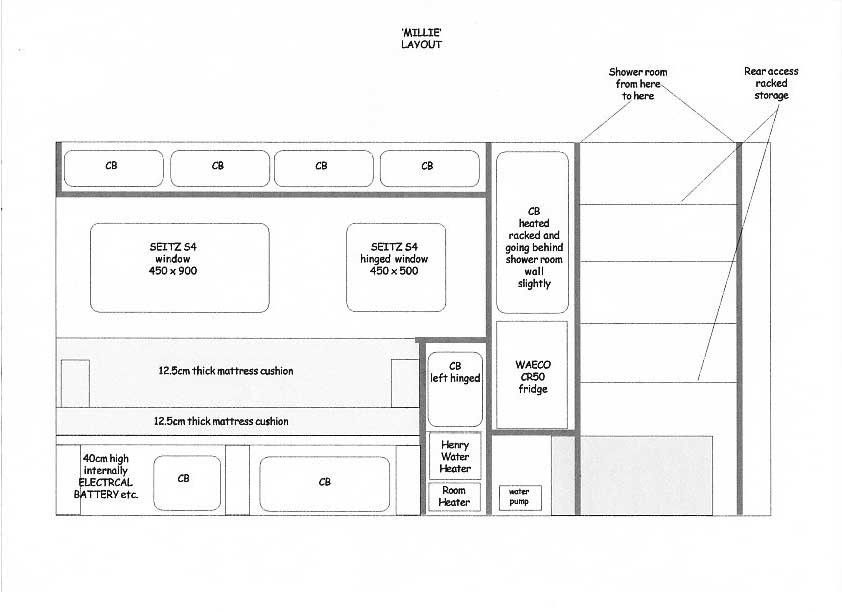

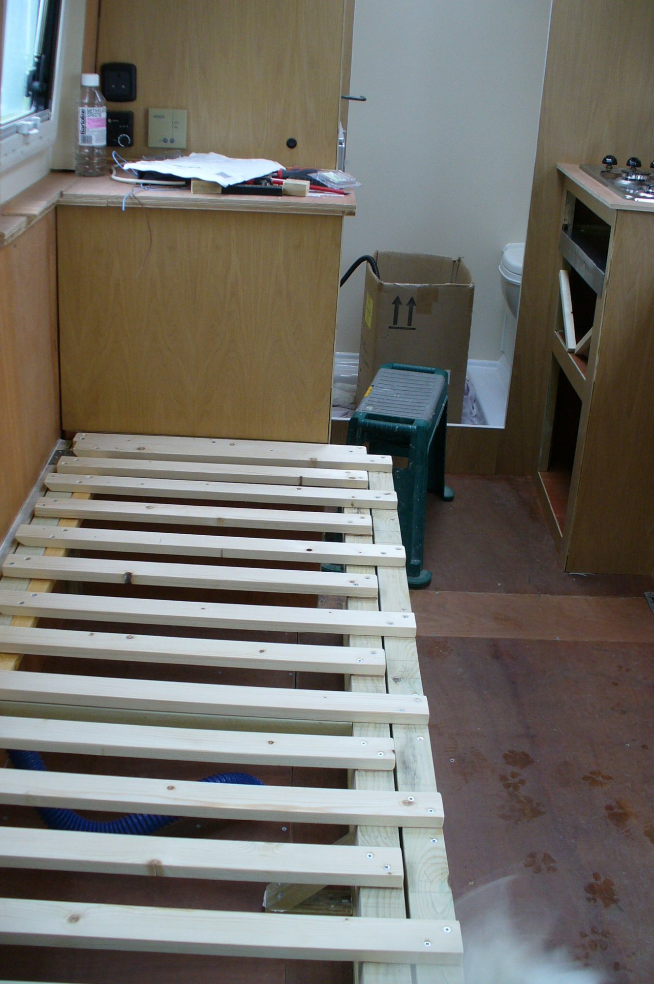

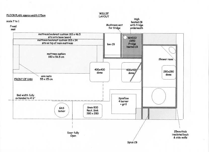

These are my plans, they worked for me as well as in excess of 70 self builders who have followed them since.
My No. 1. objective in my Master L3 H2 build was to ensure the greatest amount of storage space as well as the largest possible amount of day space.
The pull out bed takes us about 1 min. to make and is exceptionally comfortable.

Thanks for that.
Interesting plan, We looked at L3s but we decided it wouldn't work for the level of stuff we wanted and the storage for long trips, even with the L4 we were still short of space.
