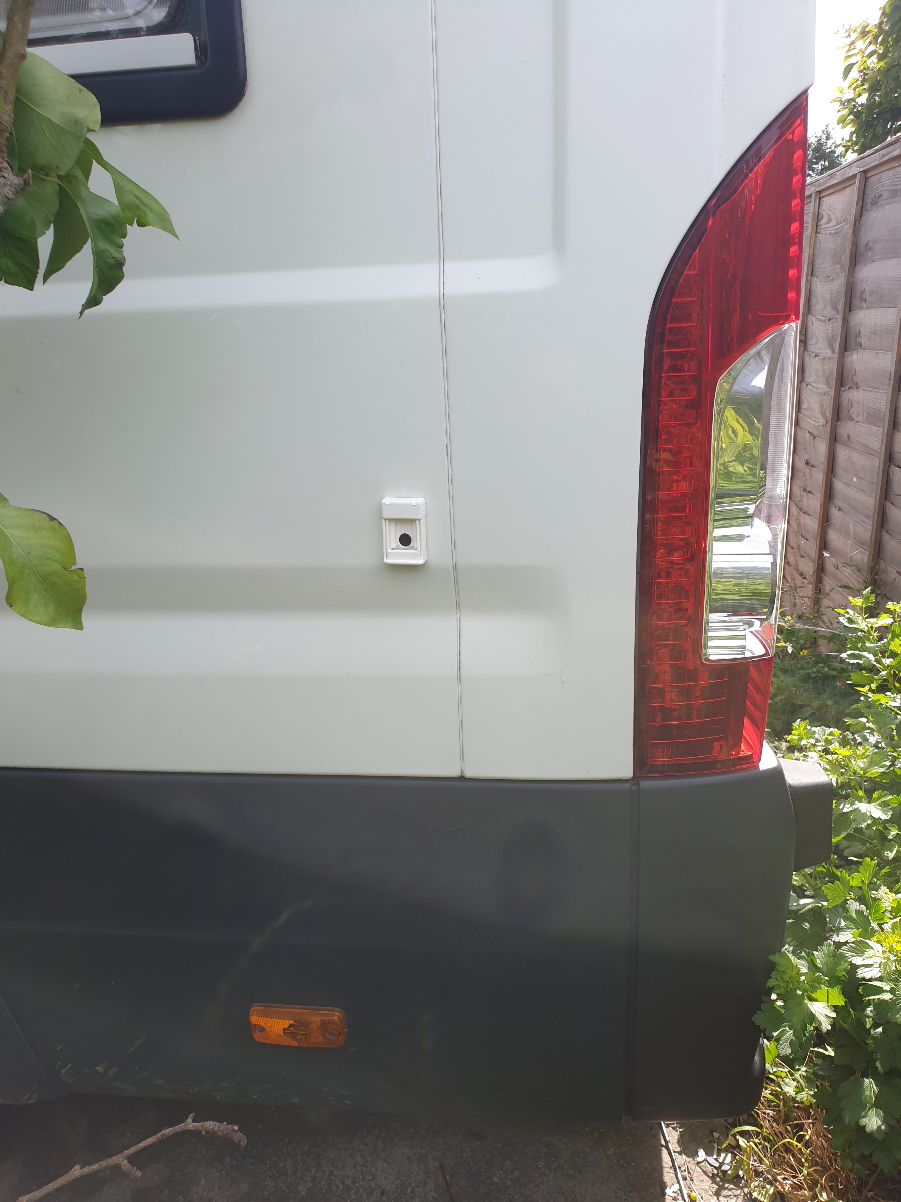

In the past I've always avoided these awning leg mounts that are screwed to the van side wall to allow the awning legs to fit into a plastic shoe and allows you to put the awning out when pitched on tarmac/ concrete areas.

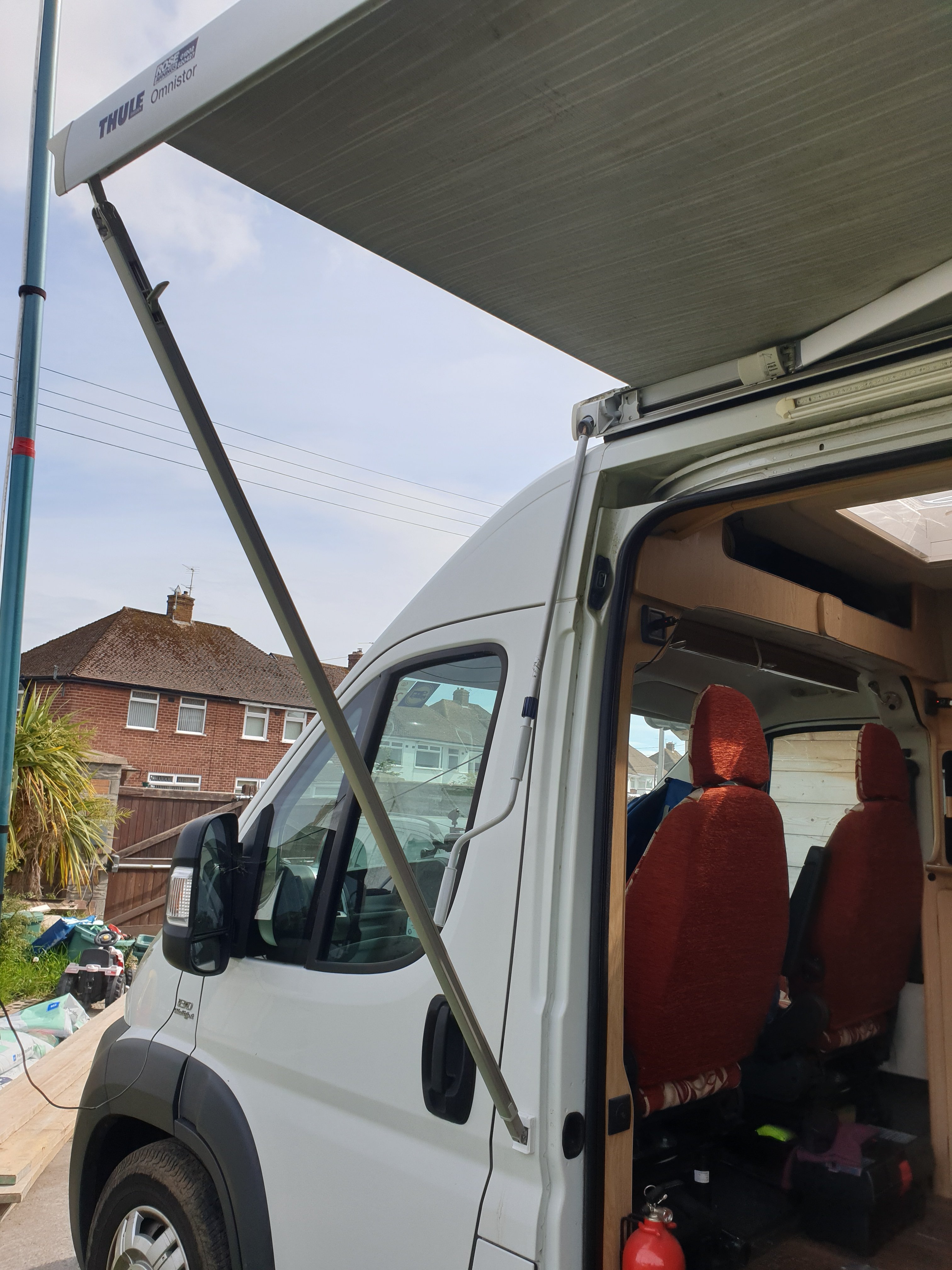

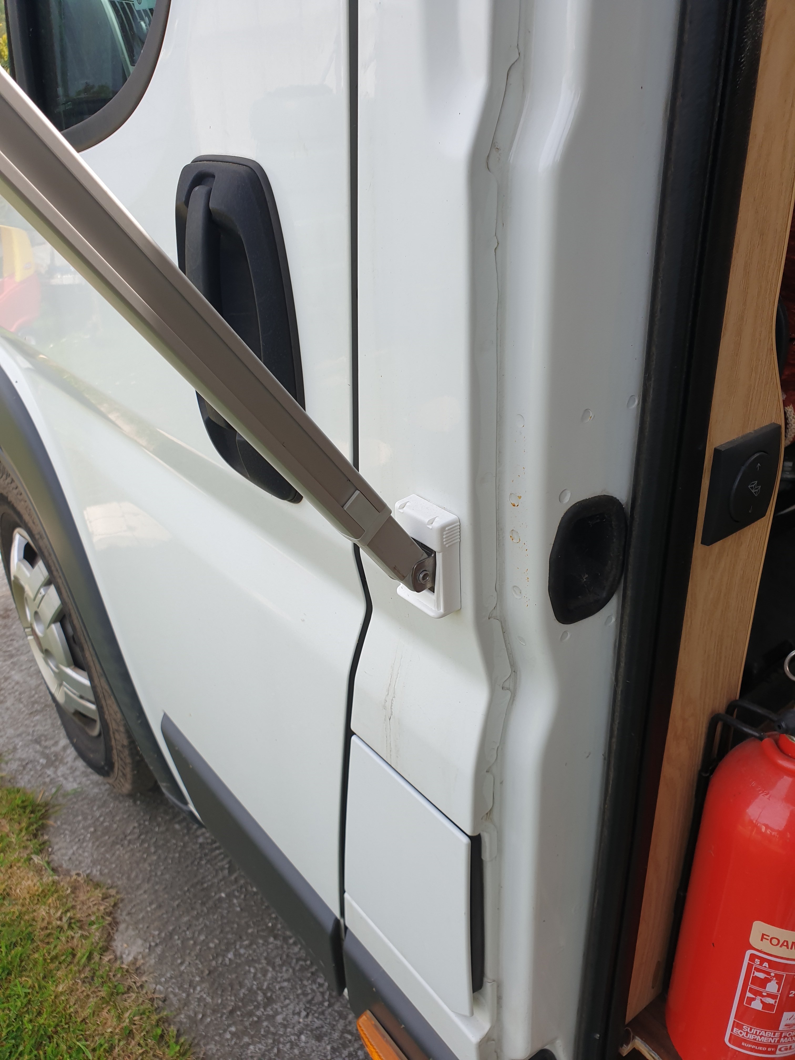

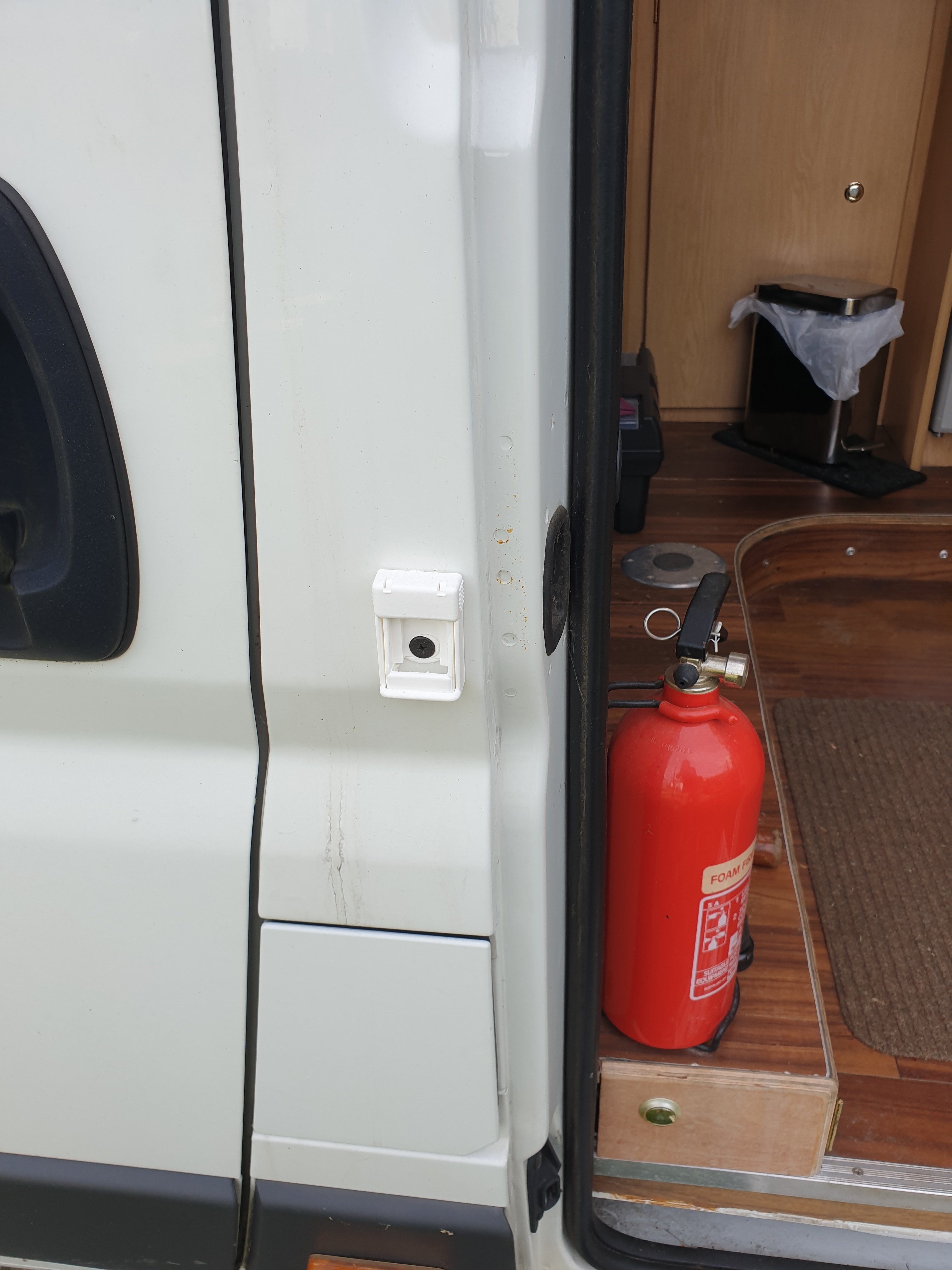

I have to say that on the continent in Aires I have often seen motorhome with awnings out and table and chairs with the awning legs attached to their van sides, even though the strict rule is no "Camping" in Aires. (It seems that again there is an EU rule that is ignored by the continentals but obeyed by the majority of Brits). However when I bought the Thule awning I did not fit the plastic shoes that were supplied with the fitting kit, and promptly stored them. During this lock down I decided that maybe I would indeed fit them and make my life easier when pitched on solid ground in breezy conditions, do you think that 6 years later I could find the dammed shoes "No" so I looked on the internet for them folk who were selling Thule accessories were asking £25 pounds for a pair " Sharp intake of breath" eventually found some on ebay for £10 free postage so I sent off for them, when they turned up they were exactly the same as the genuine Thule items. I fitted them and tried them out, it took me all of 20mins tops to fit them and I really wish I had fitted them 6 years ago, it makes a fantastic addition as you can have it fully extended or just 3 feet extended for tight spaces in Aires and not have to worry about the awning taking off in the little windy type thermals that tend to travel through the Aires and other places you might park.

Are you finding they are secure enough screwed into the side panel?
Just wondering as I have had the same dilemma about the van mounted supports and one reason put off is thinking (rightly or wrongly) they need a spreader plate on the inside.
But maybe overthinking it if your setup is nice and solid :)
That was my original worry, however I have glued and screwed as they say and with both types of fixing I feel that the polypropylene plastic mount would give before any damage would occur to the van wall or screws being ripped out. However I would not like to trust it in high to moderate wind conditions but then I would use my tie down straps in a situation like that and then only on a grass pitch. These are really only meant for light winds and thermals that sometimes happen when pitched up in a layby or Aire when parked up for a bite to eat or siesta 😁. Phil

The fiamma brackets are totally different Dave, the Thule brackets the outside slides up the leg foot is then inserted bottom first then top pushes home after that slide outer case back down and this locks the foot in place securely. Phil

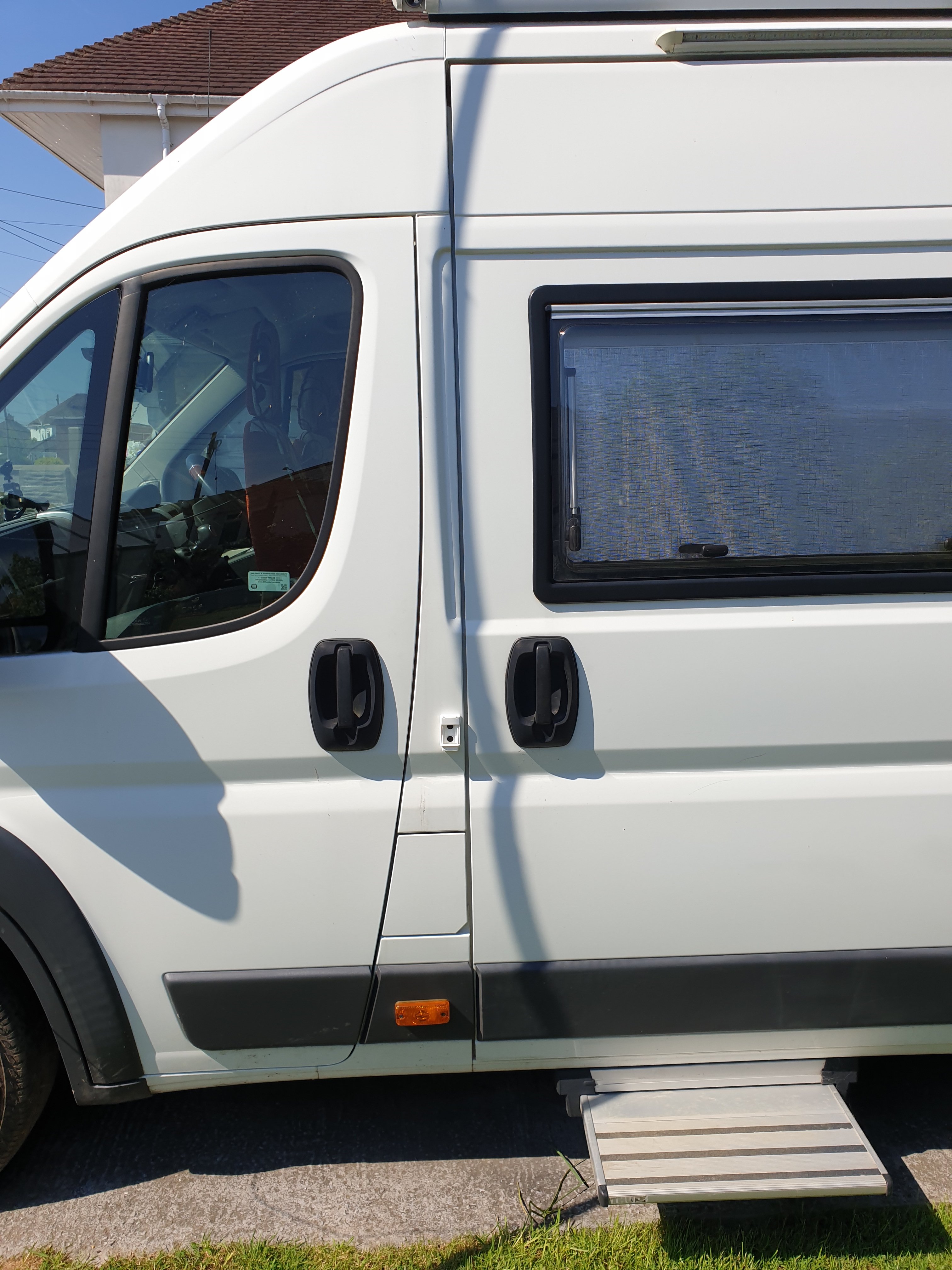

I haven’t fitted mine yet as by eye one wants to be where the gas locker door is. Now yours are on and you have used them do you think they would be okay at a higher level?
For full extension and partial extension to a point yes, best way is to get someone to hold the opposite leg from the gas inlet with awning fully extended then wind the canopy in decreasing the gas inlet leg in lenght holding it up to the side of the van till the angle gets to difficult for the canopy/leg position, (you will know what I'm talking about when you try it) a lot will depend on what van you have, a photo of where you intend to put the mounting would be of help.

This is where I have fitted mine on a Ducato, I've seen commercial companies fit them this hieght as well.
I think I could quite safely get away fitting them about six inches higher, dont forget the legs are adjustable so one side could be appreciably higher than the other they dont have to be attached at the same height.

Thank you for your article and great photos
I finally know how to put on the Thurle Leg Backets on the side of our van. I couldn't figure out which side to have facing up. Your photo showed me nicely.

Trouble for me is that when travelling on the continent especially in France, most Aires are tarmac areas and on a hot windless day its good to put out the Awning 1/4 to its full width (Depending on space available) and have a bit of shade. But every so often even on windless days some very heavy thermals can whip through and take you by surprise. Hence the side wall leg clamps become very useful. 😄 Phil.
