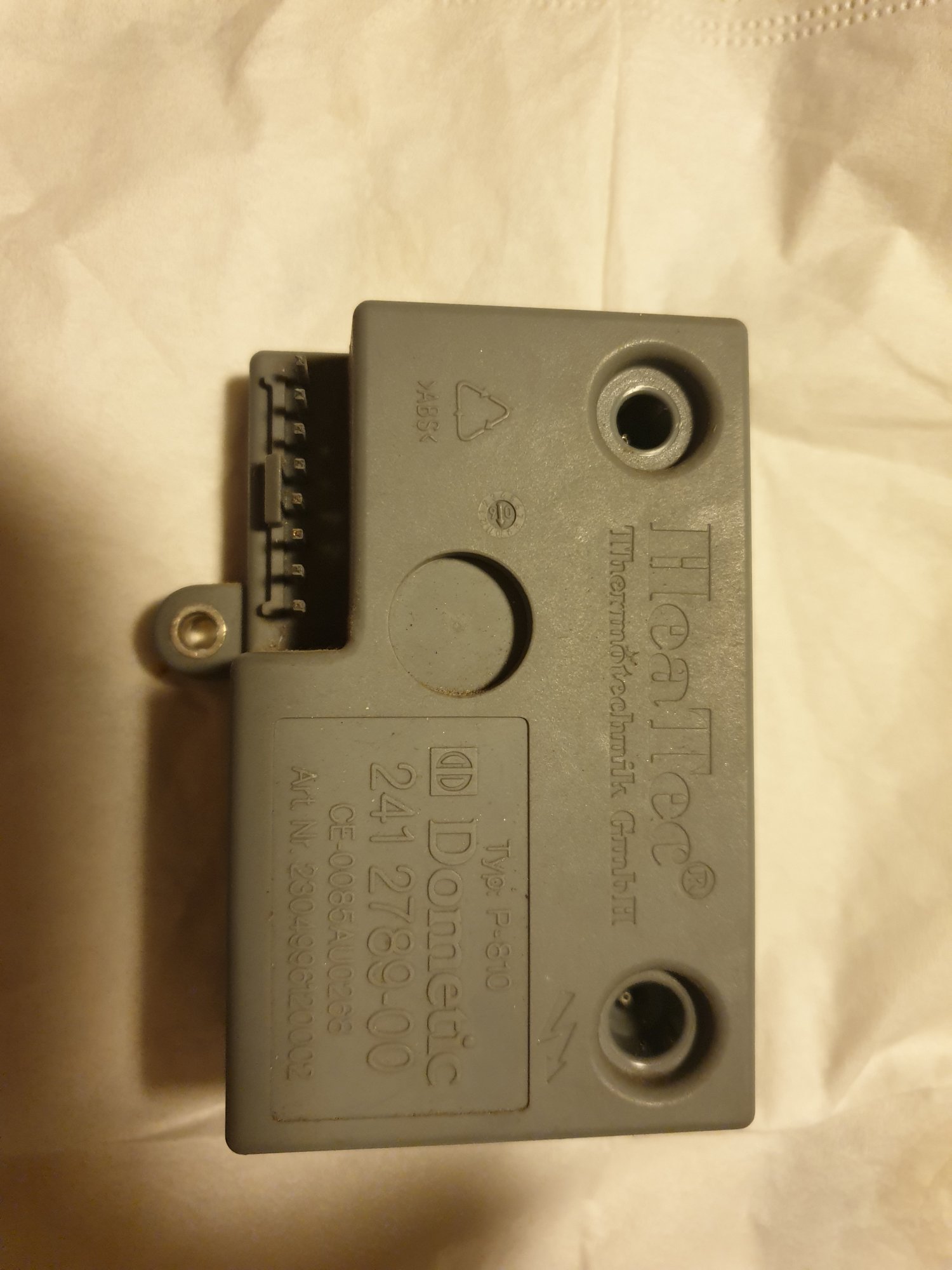

My fridge has been playing up on gas for the last year. Its now fixed (🤞). The problem was this part. A Dometic Burner Control unit. It would spark but would not let the gas through.
Hope this is usful to others struggling with a fridge which is fine on EHU and 12v but not on gas.
