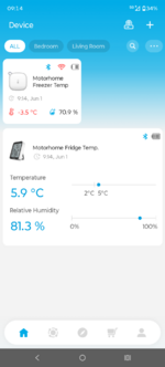

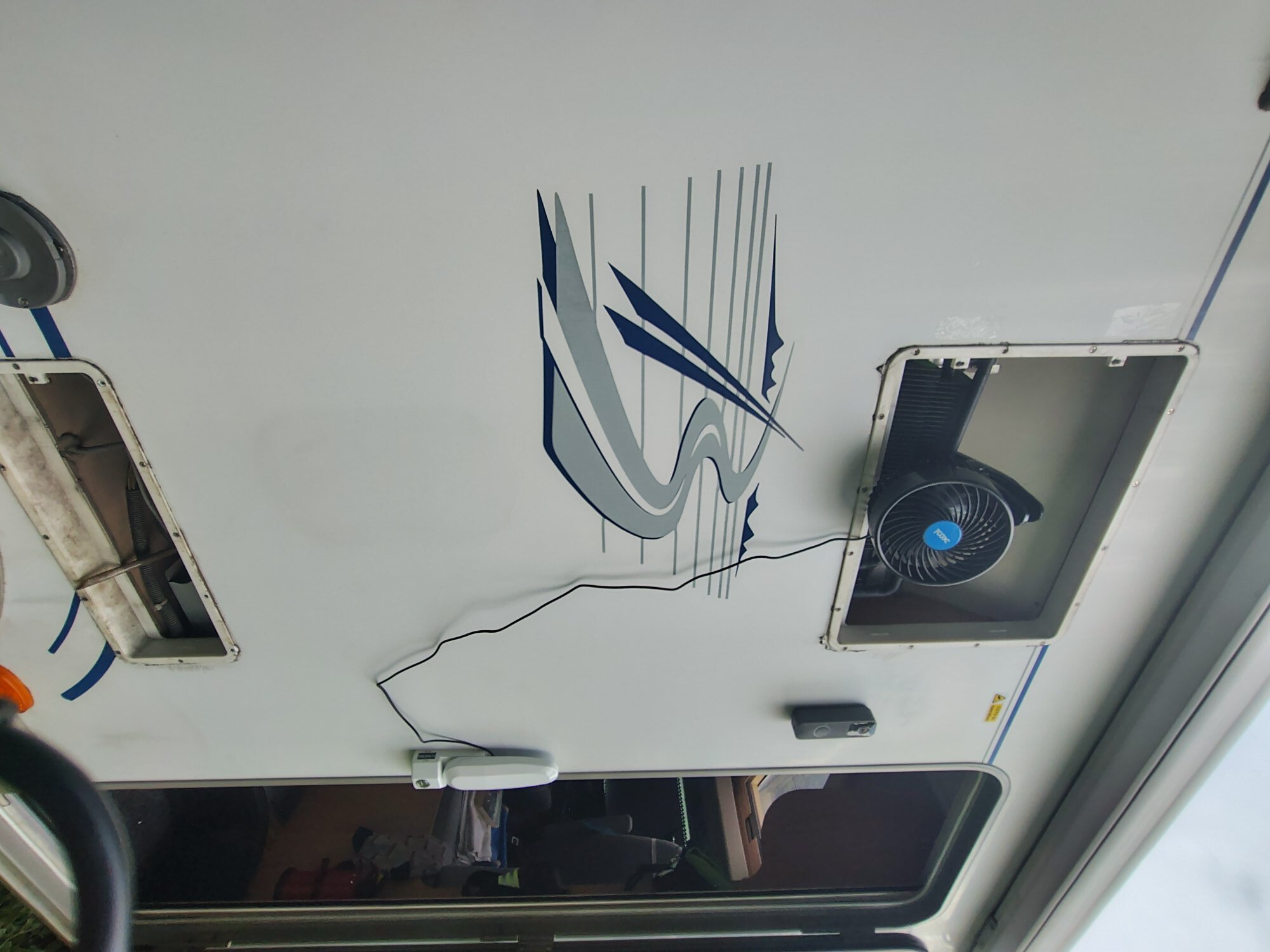

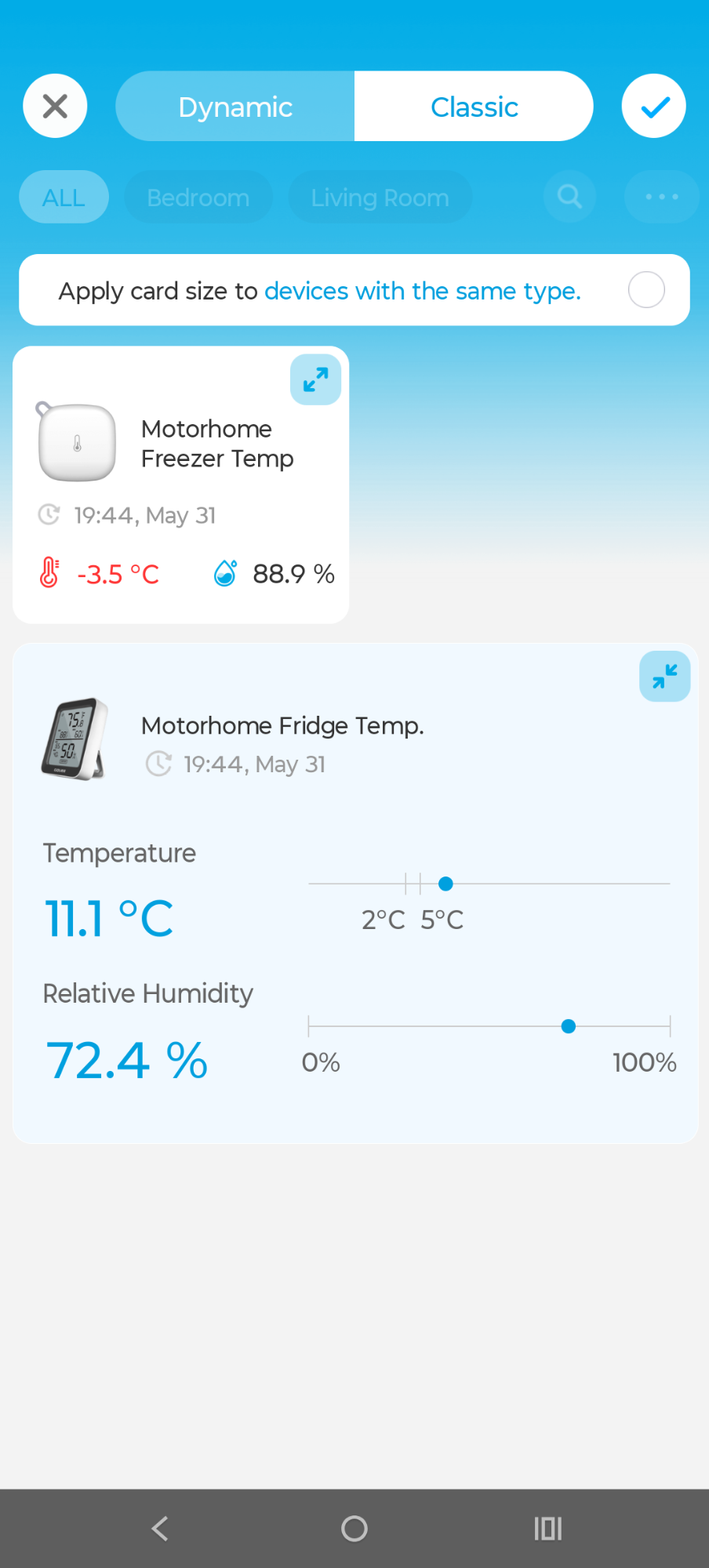

Hello friends, we're currently in Bonneville, France and our three way fridge ( on electric) is suffering badly in the 30° heat. I've taken the top and bottom external grills off and have a small fan extracting heat from the top grill. But we're still getting only -5 in the freezer and +11 in the fridge. Its fitted to our 2007 Burstner Solano and I s probably the original. Anything else we can do to improve things would be appreciated. Thanks. ☹️

Love stopping there, walk along the riverside with the padel boats. Old 3 ways aren't the best I found out too. That's about what my 2011 one would run at when it got hot outside 🤔
Gas is generally better at cooling. Are you at Bonneville near chateaudun, I didn't know there was electricity at the aire ?
Hi YeoBlade and thanks for the reply. Looks like it's for the scrap heap soon then. Carol brought loads of goodies that require refrigeration ( meat, milk cheese etc.) and not sure they'll be any good now, gutted ☹️.

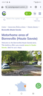

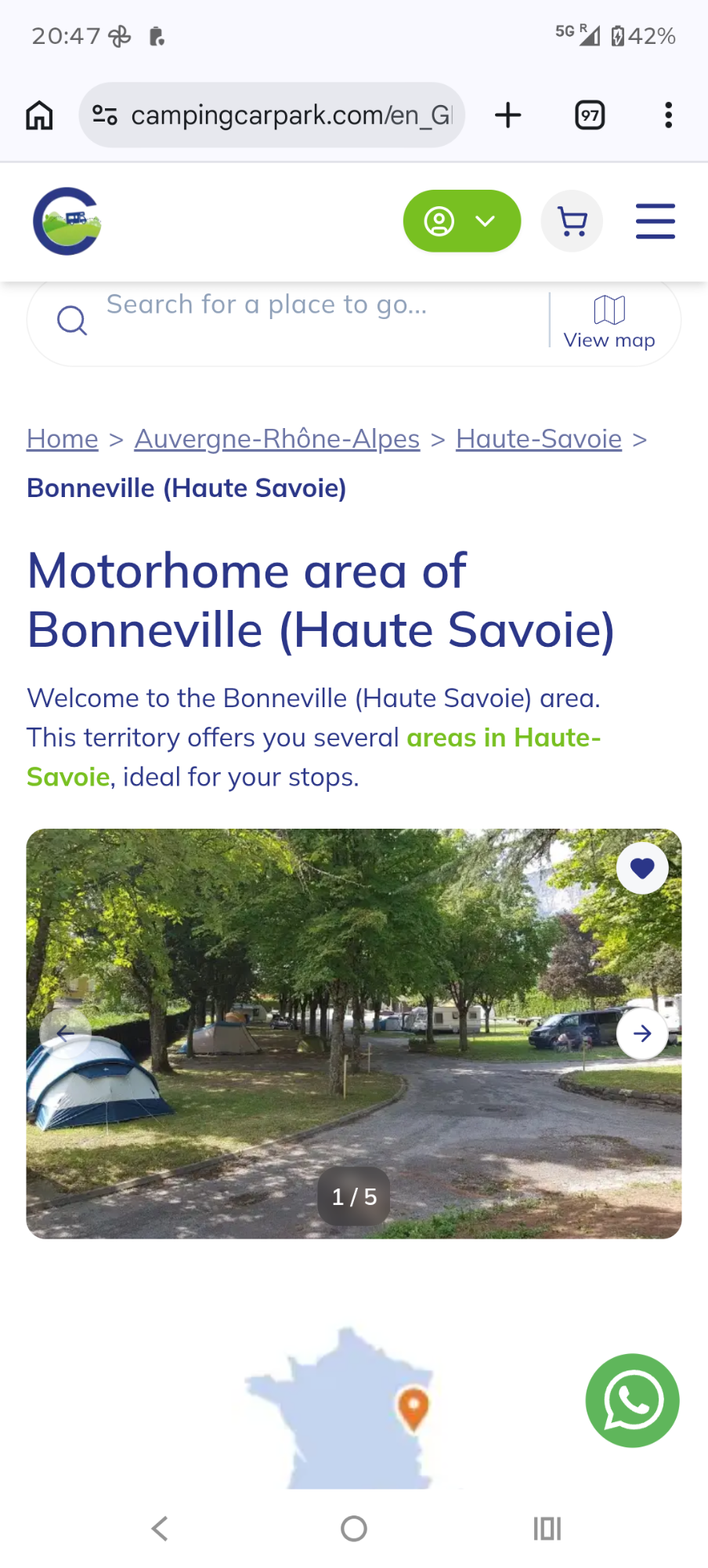

Is there a Bonneville near Châteaudun? I can see a Bonneval in the Eure et Loire (which doesn't seem to have EHU on the aire), but all the Bonnevilles in France (there are a few of them) appear to be in other départements. The Bonneville in Haute Savoie has a Camping de Mon Village (operated by CampingCar Park), which does have EHU.
It's this one...
That's the one we're on. Freezers down to -1.5 now, fridge at 10.6☹️, temp in m/home is 24° and outstanding temp is 22° 🤷☹️

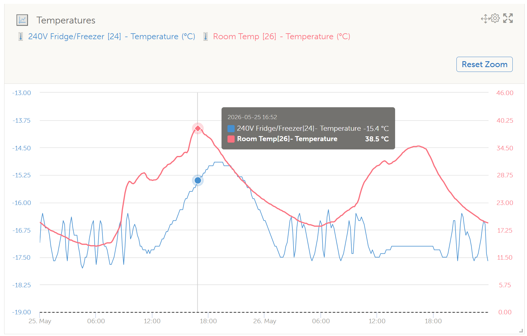

Just a snippet showing how you would expect a Compressor Fridge would work at highish temps ....
On the 25th, the freezer did go up to -15.4C when the room temp was 38.5C (usually the freezer is programmed to stay between -17C and -18C).
Definately worth considering changing if holidaying in high temps is a regular thing.

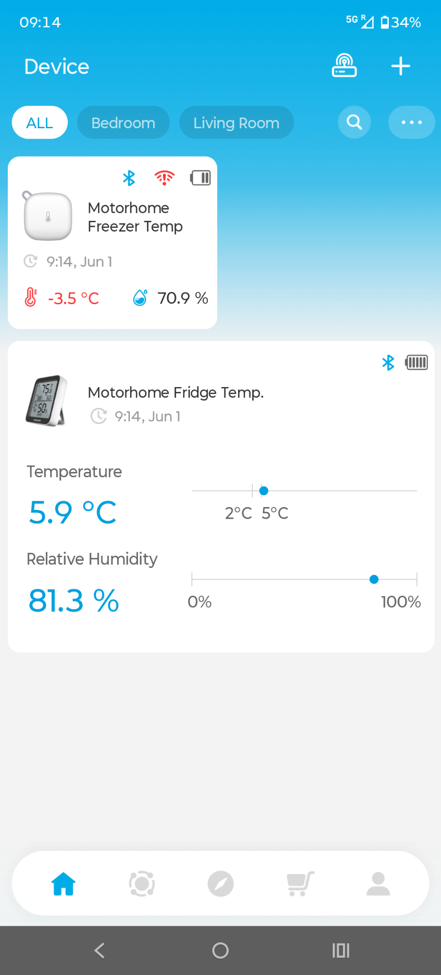

Well temperatures have dropped in the fridge and freezer overnight, so I guess unless the van has sunk overnight and we're now within the tolerance percentages, then it must be down to our fridge/freezer being old and generally inefficiency of a 3eay fridge🤷. Hope our stuff hasn't gone bad☹️

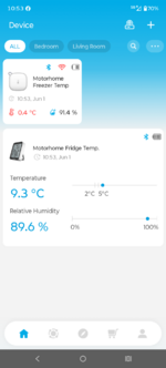

.....goong back up again now, temp rising outside to 20°+ so I guess it's scrap☹️

There's a strong possibility that the gas jet is blocked partially. I'd recommend cleaning this as soon as possible.
You could confirm that this is the problem by running the fridge on hookup. If it cools successfully on hookup the problem is with the jet.
That's pretty much how our 2011 thetford worked in France in the heat, fans didn't really make any difference, parking without the sun hitting that side of van was always helpful. I was considering upgrading it, then bought a new Motorohome, even though its still a 3 way its performing well in the heat. Its a large separate fridge and freezer. We'll see, off to France in couple of weeks .....
Hi, thanks. We've run it on both and it makes no difference whatsoever sadly ☹️
