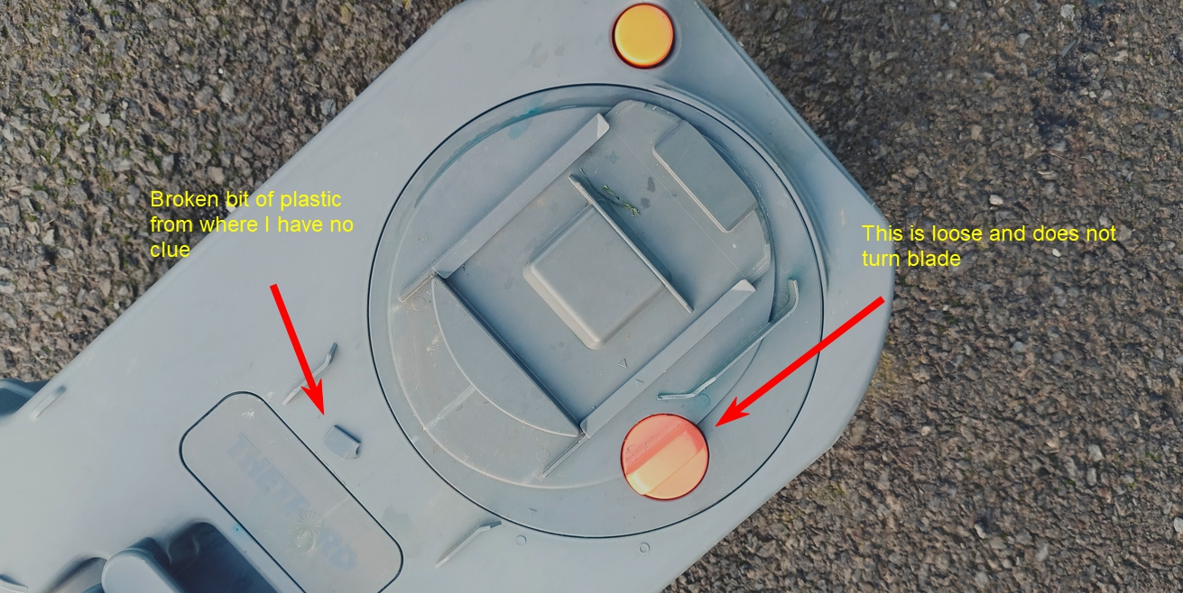

I think it might be the cassette thats knackered. I did find the cog in the video and it wasnt lined up correctly so I undid that and straightened it and tightened it up. However I stupidly thought there was a blade that opens and shuts in the loo unit itself on this one but of course thats not the case. The blade is in the actual Cassette toilet that you remove. I assume this large orange knob turns it open or shut. Anyway its loose. It just spins around so presumably the blade I moved with my fingers last night is disconnected and inside the cassette? I also found a broken bit of plastic but have no idea where that came from.
Would I be correct in deducing I need a new cassette or is it worth trying to remove the whole circular lid and attempting that repair? My gut feeling is not to dick about and just get a new C260. Assuming it is that.

It is the orange knob that opens and closes the blade. You may as well pull the circular bit out and see if you can fix it, will probably have to wait for a new cassette anyway. Sure I have seen stuff on YouTube for taking that bit out but it’s a different type to mine
I think you can get a replacement for the whole circular bit. We had a replacement ‘Kassettenmechanismus’ sent out from uk to Germany…took a week to arrive. You may get a ‘fresh up kit’ more easily as more stockists have these, it includes a new lid as well…whether you want it or not!
Thanks I have seen the video to replace the big circular bit but it looks tricky. £65 for that or £155 for a whole cassette and seat from the local dealer or £132 from Amazon. I might just take the van to the dealer on Monday as we are moving that day anyway across the road or I could just wing it and go and get one on the bike now. :D Its a big box mind. Wonder if it will fit on the Pillion.

Just so I am absolutely clear though when you rotate that knob in my picture with the cassette on the ground the blade should appear or disappear? Correct?
Yes, when the cassette is in place, that yellow knob sits between two uprights that then will turn the mechanism through 90°. If it spins freely, the cassette mechanism is bust not the bowl lever etc.
