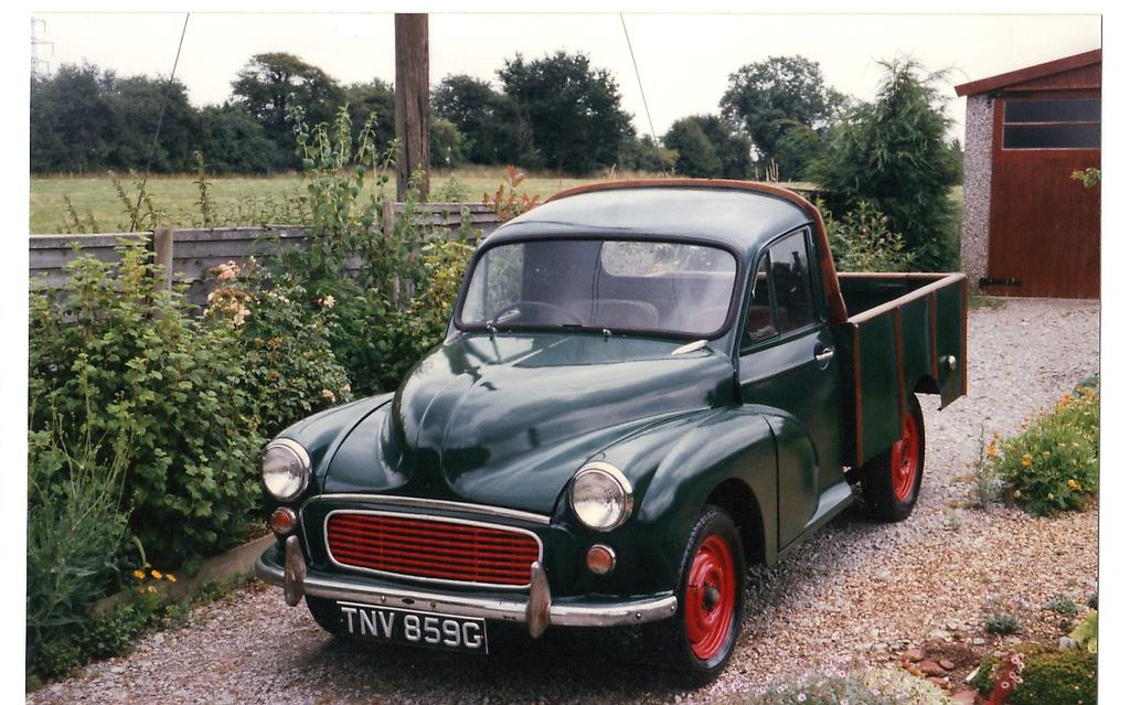

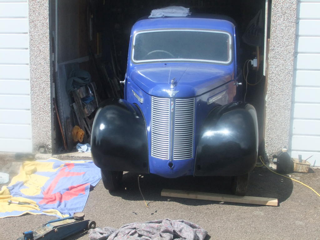

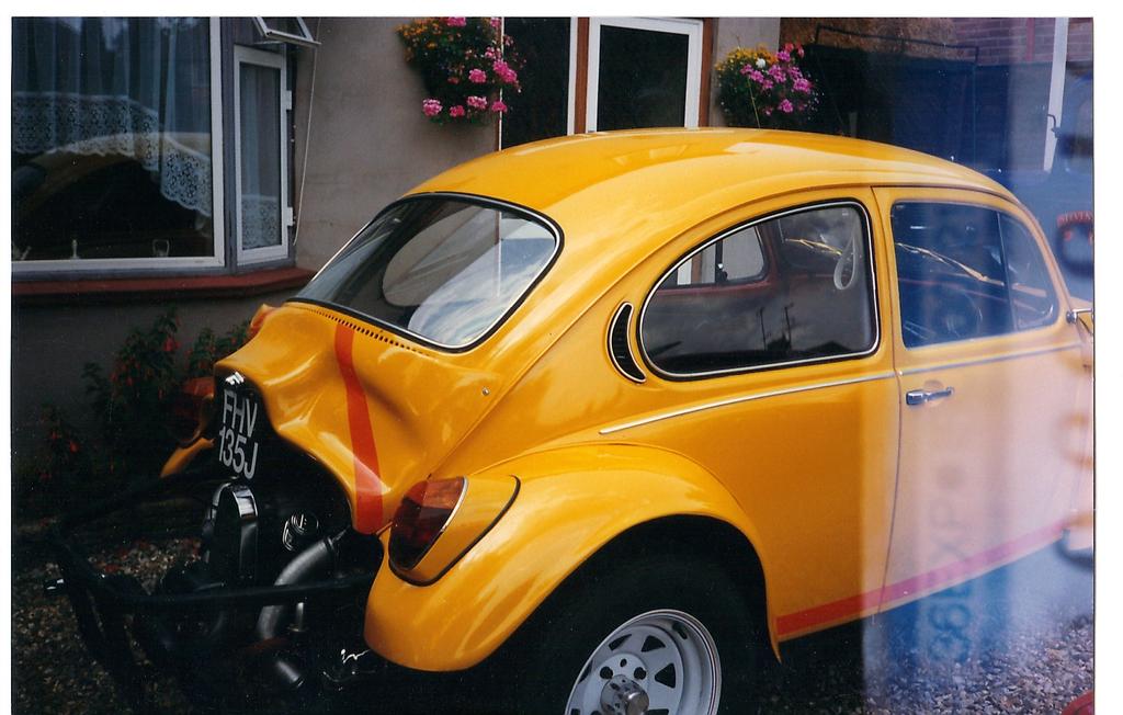

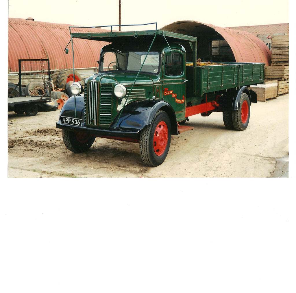

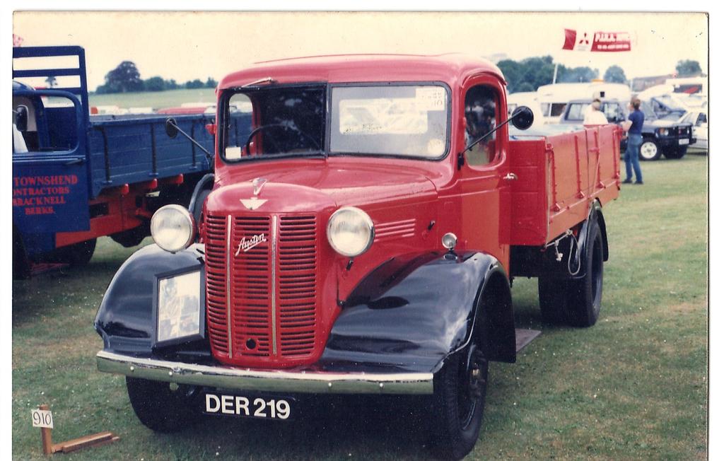

a few pictures of vehicals done with Tekaloid paint.
Will always give you a hand doing it if you can get it inside.
