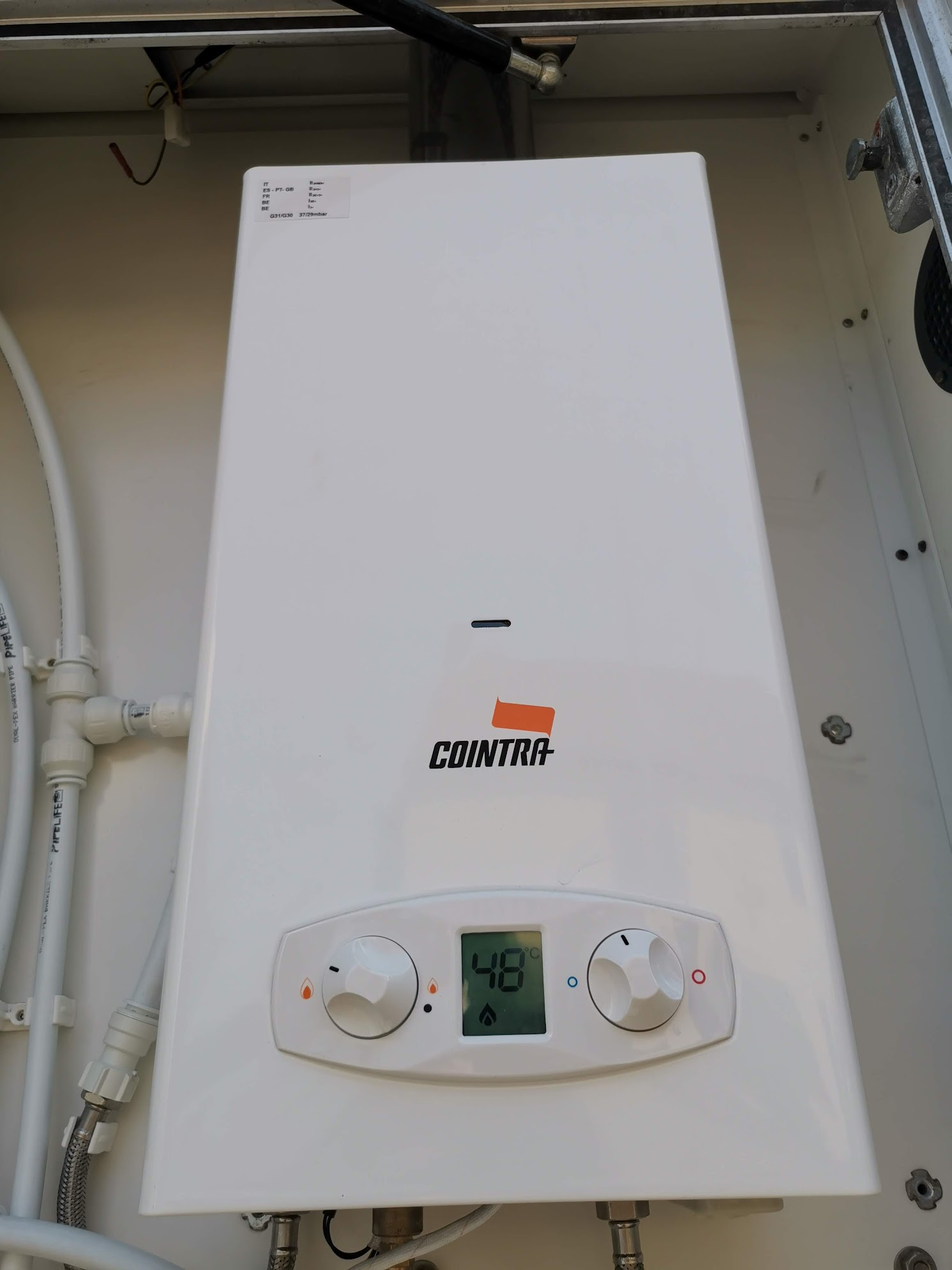

Got the CPA6 from hamilton gas products in an outside cupboard with chimney. Works perfect, I'd recommend them for anyone.
Also have the redring 6L electric and even though I have 600ah of lithium batteries, 1000w solar and live in Portugal I still use the gas heater as it uses such little gas and doesn't stress my inverter running a 1.5kw electric heater. I use 7.5kg of gas for water heater and cooking in 4 months. I just put valves on the entry water pipes to each heater so I can choose which one to use.

Now thats what I'm talking about... Well, kinda wont look as professional but yea, thats what ahm doin... Minus the chimney, ah'll use vents...
That looks a nice install...

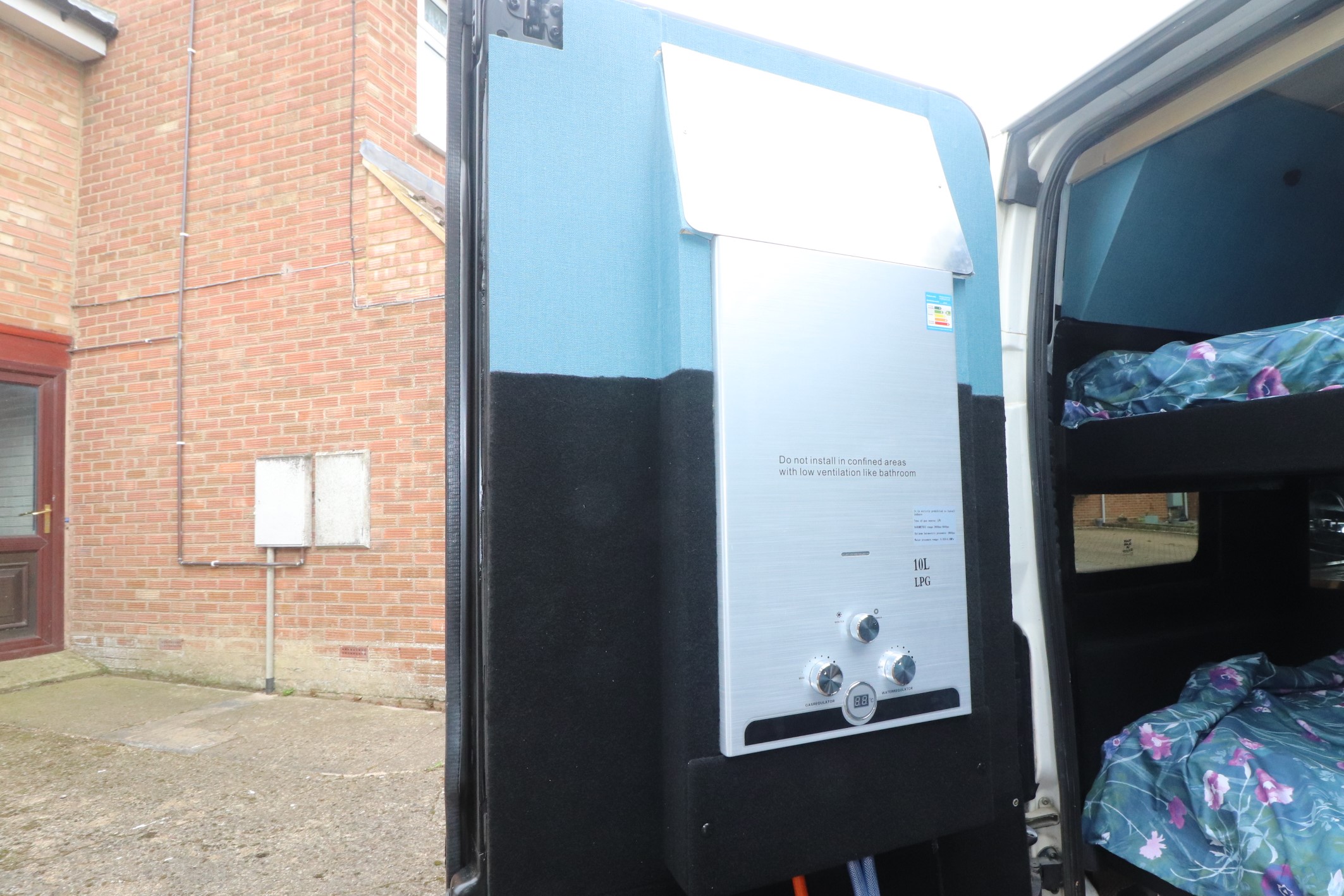

I mounted the heater just inside the back door on the right side of the van, was the only place it could go, literally, there is no other place it would fit. Timmered in checkerplate behind it and used insert nuts to provide the anchor for the water heater. Anyway, its in...

Ahv still a heat shield to secure over the outlet on the top, again, checkerplate, just need to put a bend in it and either Timmer it in place or put in inserts, have to ask the engineers how Timmer reacts with heat first although unsure how hot it will get.
