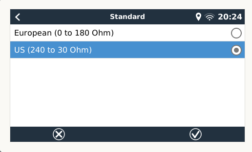

I found the level senders a daft price as well generally. That looks pretty reasonable. I would think 'Euro Resistance' would be right :)
The Victron setup is designed to be compatible with two different standards, and you chose which one you want in the setup. Below is a screenshot from the relevant part in the setup

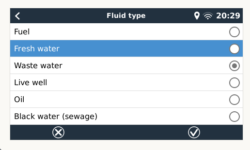

And you set what type of fluid in another setting option.

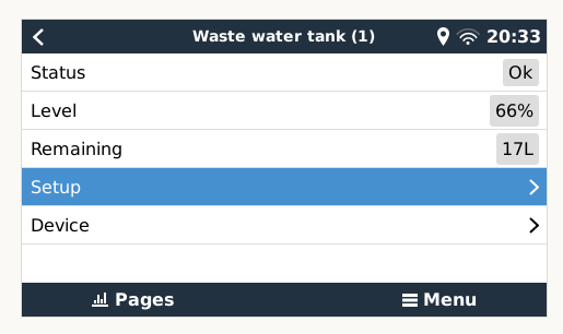

You set the maximum tank volume and then depending if it Fresh Water or Waste Water, it will tell you how much fluid/space has been used or how much remains (in the example below, the tank is 25L so has 66% space available. If it was Fresh Water, it would mean that 66% of the Fresh Water remains)
