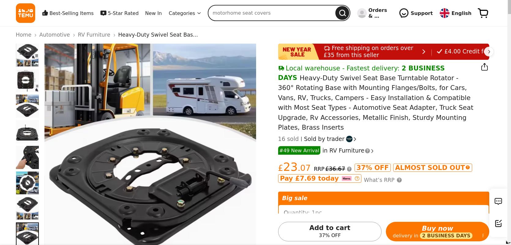

Found on temu, not a bad price.
I like the idea of these ,have you fitted these ,if so what to ?.Ive got a 2003 boxer avantgarde 200 its got fixed seats i might fit ,cum summer.

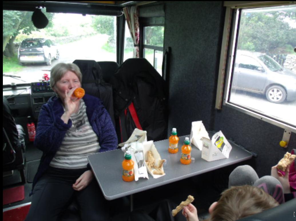

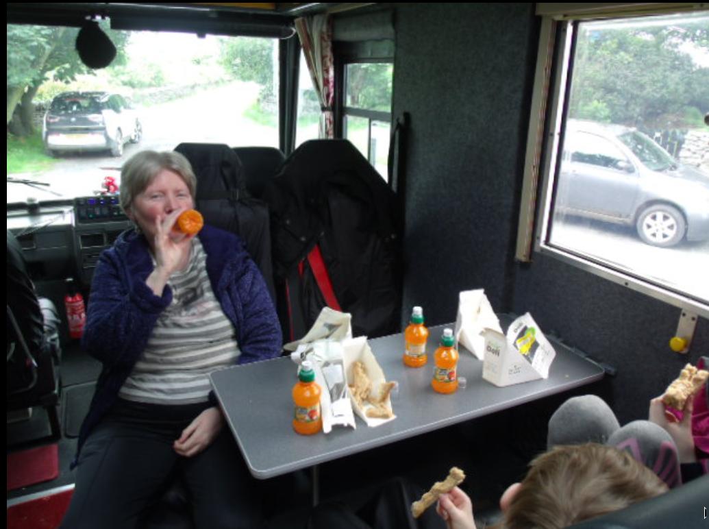

I got ones from a old ford and modified them for 2 seats in my 6 seater so 2 can turn round to face the dinning table, well worth doing.
Sod it i`ve ordered 2,hope they fit?? :rolleyes: 😁
Most must be modified, ie bolt holes on them or the old seat rails, there is no such thing as a straght fit, easy job mind you and worth it.
The ones i got from s yard i had to cut down mounting plate and cut a grove for reverse lock pin to engage.
Ones on line will have this as standard so dont panic.

It can be done, but it will require someone with a electric welder and some other tools to sort frame to swival mounting alinement
I am not a TEMU fan as most of the stuff seem to be poor quality copies of the real thing. And getting a cheap swivel plate is IMO asking for trouble. Even the better ones can have issues so god knows what a knockoff TEMO one is like!
I would say avoid like the plague and if anyone does get one, check it really well and see if you can break it - it needs to be able to withstand very high forces in a crash so if you can do it any damage before it is fitted, it should be binned!

It is very likely that you can get a swivel plate for your van and it is usually a simple job to adapt to suit the mounting positions.
something that should be considered - and more so if fitting on a drivers seat though - is the effect on the seat height. These can raise the seat by upto 3" and that can cause a problem with shorter legs reaching the pedals. Another possible issue is raising your eyeline above the window frame. which can be quite an annoyance.

Well the seat swivel plate has arrived and it`s quite a weight ,it`s probably heavier than the seat . I`m going to wait till it`s warmer to fit that ,do the passenger seat first, there`s more room and fitting the drivers side will be easier.
