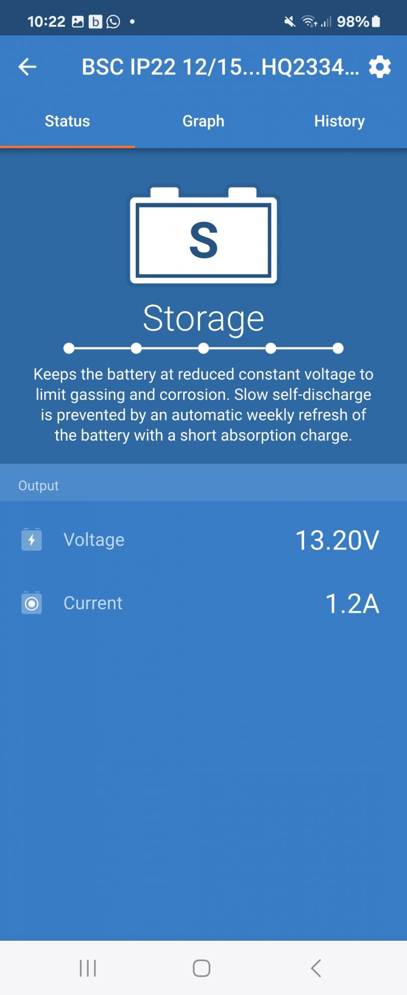

I set up the tempory cable from charger to leisure battery overnight .just run across the floor .I am now getting this reading and everything works on the temp cable .so deffo a problem with the original wire so will do the teats on the orig cable over the weekend as meri said .wildebus I am now getting this reading on the charger app with telp cable and battery shows good readings
Before you run a replacement cable, be worth checking all the fuses, including taking them out and visually inspecting them, including the contacts. Your motothome is fairly old and it could be something as simple as a bit of surface corrosion stopping contact being made.
Will take a look .thanks .the cables hard to trace but will use the multi meter .it won't show me where the damage is though .and majority of that cable is hidden .I have checked all the habitation bullet fuses in the fuse box and a main 30 amp fuse at rear of fuse box ..checked a fuse by starter battery also .just hoping not another fuse hidden somewhere I can't see .( Thanks for reply )will update after I get a chance to look over weekend .
