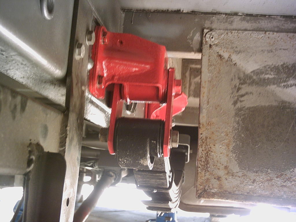

Lucky i have a truck chassis so a alloy shield is fixed which i am going to bolt on rubber flaps,you could do the same with angle screwed to floor and the mount the rubber flaps to that.

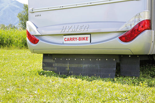

Another option may be to fit a full width "curtain" to the bottom of your rear "bumper". Dont know your van so not sure if its feasible
As Below

His prob is the spray is also coming of the wheels and socking the rear of the tail lights and floor section,as i said a bit of alloy angle bolted to floor with a rubber flap will work,i used on a wagon once a strip of old convair belt.
