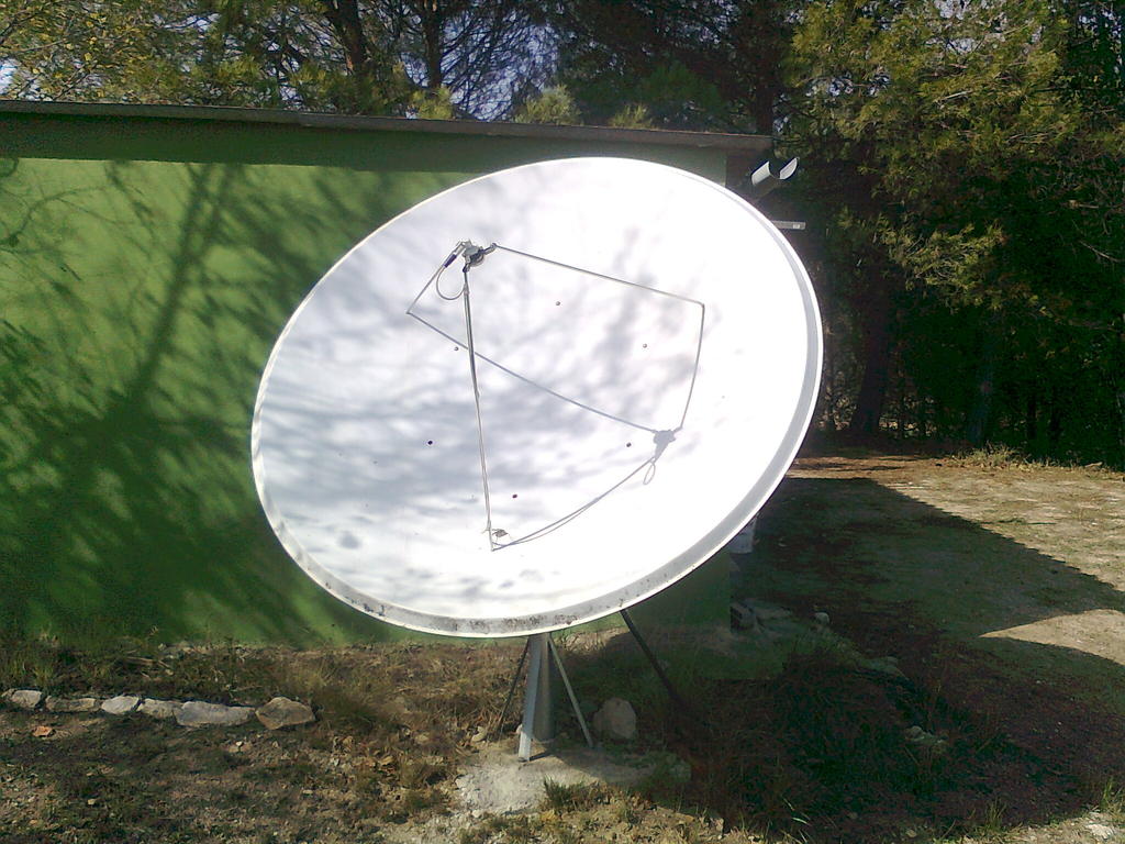

This is what we have to have in our summer house for the boys 2.8 Photo0867.jpg Think you need one of these John.:cheers:
