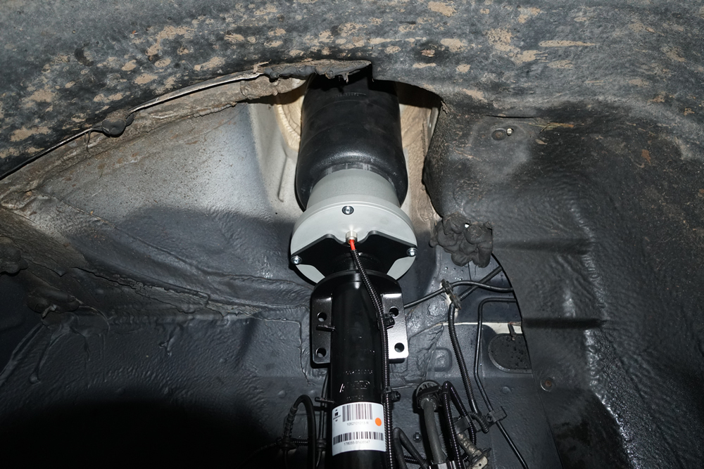

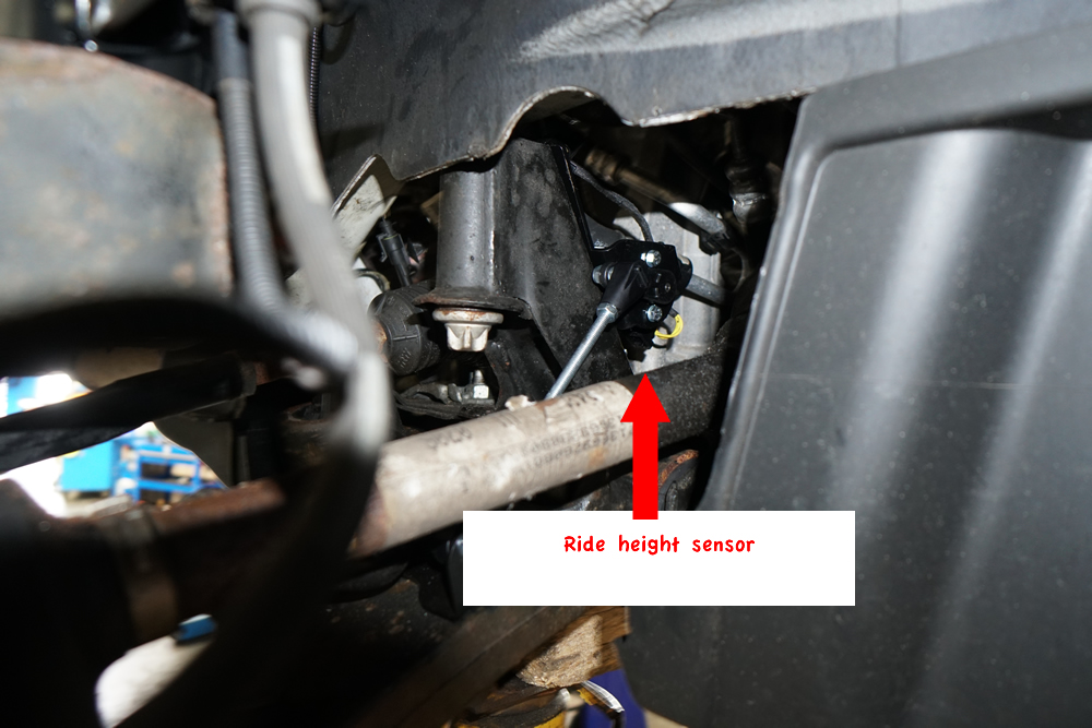

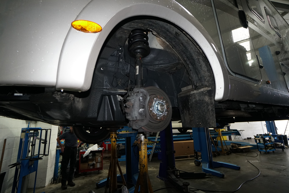

The front suspension was fitted yesterday and the water tanks and their carrier were removed. Today the rear suspension system and new subframe are being installed, they are also finishing off the electrical installation and the control system.

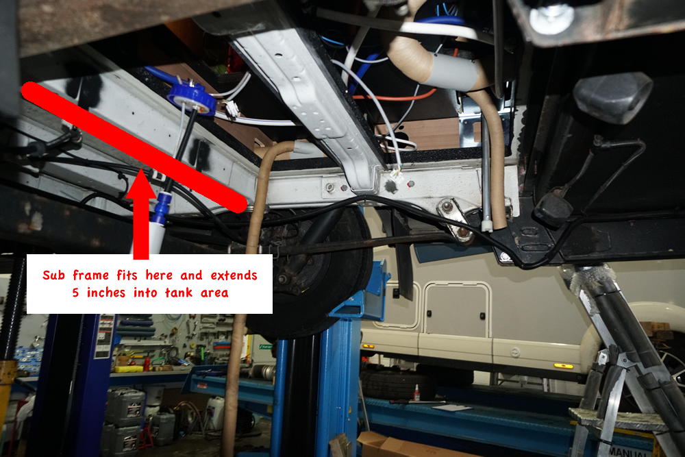

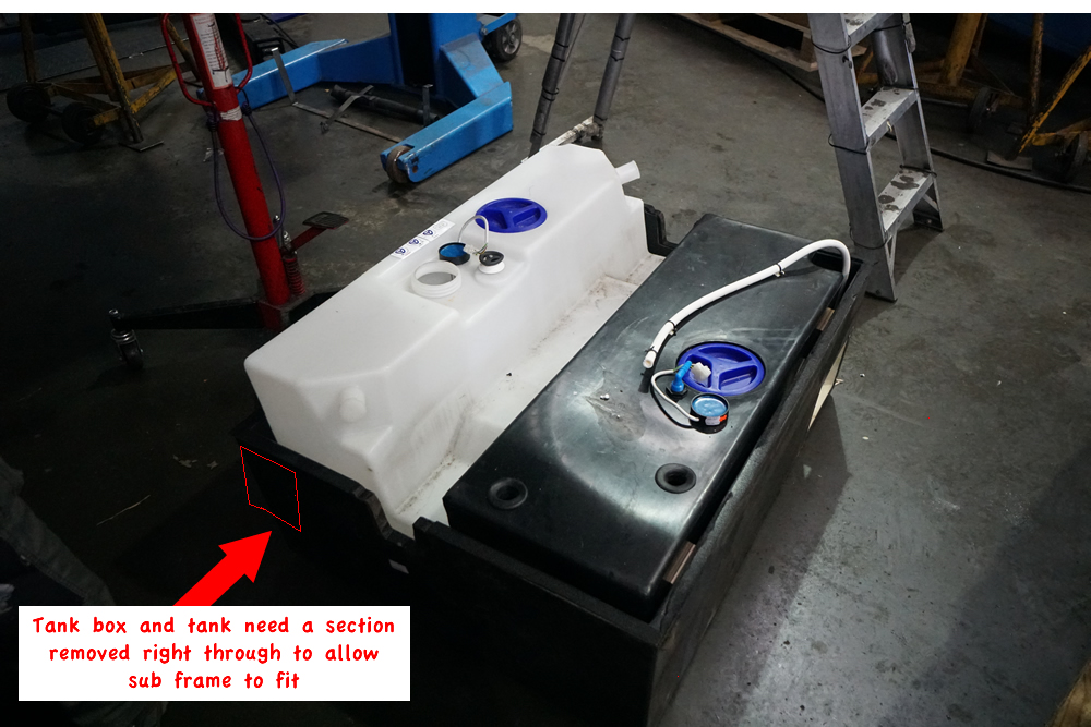

I had a chat with Mick this morning and he explained that the water tanks on my Hymer are going to be the most challenging conversion that they have done. The subframe for the rear suspension has to sit partially where the water tanks currently fit.

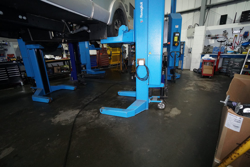

Phil tell them about the Lifts can you post a Photo of them.
Alf
I know what you’re talking about Alf they lifts are amazing. The big blue ones
Alf
At SAP they have several sets of these vehicles lifts. Each post is moved around separately and they are linked via Bluetooth. The blue ones in this photo lift vehicles up to 30,000kgs.
Whats great is that they can be used on anything from cars to HGV's. And you can position the vehicles anywhere.
They really are quite cool.

However, the water tanks look like they are going to be a lot of hassle, I am glad that Mick is sorting it. He is now banning Hymer B598 conversions :)

It surprised me that they don't you the vehicle body when lifting, they lift by going under the wheels and lifting that way, .... as you say Phil pretty Cool
Alf
