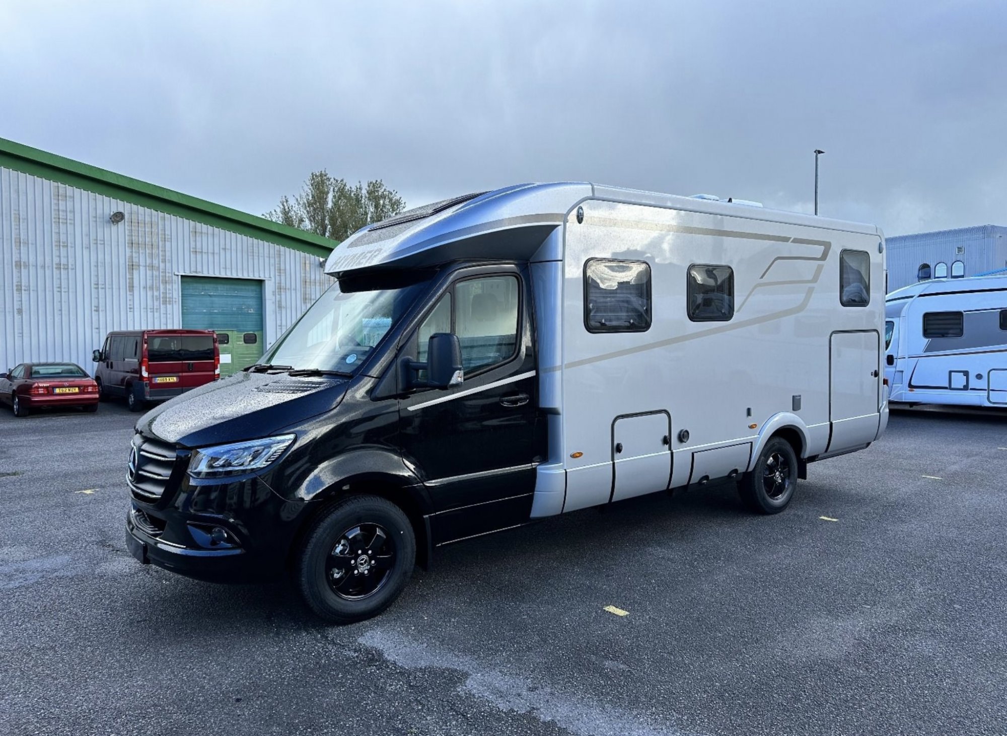

It is 7.39m long, Hymer BMC-T 680, but it does have rather a lot of vents & skylights up on top, it’s a shame I can’t find an aerial view to work from just yet. Here’s a taster
Here is an example of options .... This is my 6.7M and you can see the front cap is so curved it is out of bounds. Filled in the rest though :)

Something that is hard to find (and not succeeded so far) are panels that are proportioned to suit the in-fill areas. I ended up doubling up end-to-end to achieve that.
Also, you might find that you can route the cables from outside into the van without making any holes. Managed to fit a pair of Panels to Gordons Hymer without drilling a single hole in the roof or a single blob of adhesive (y)
