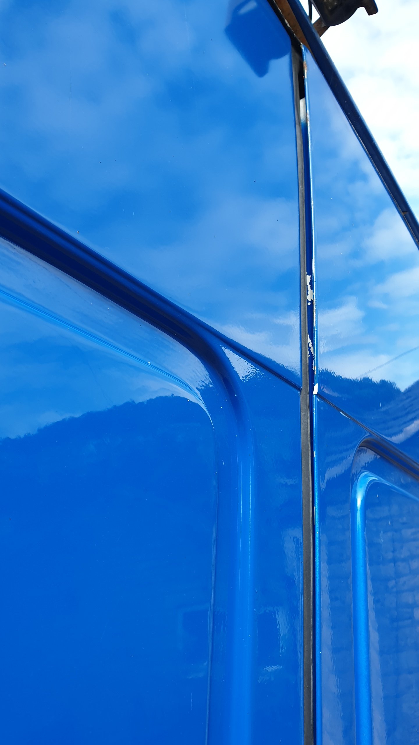

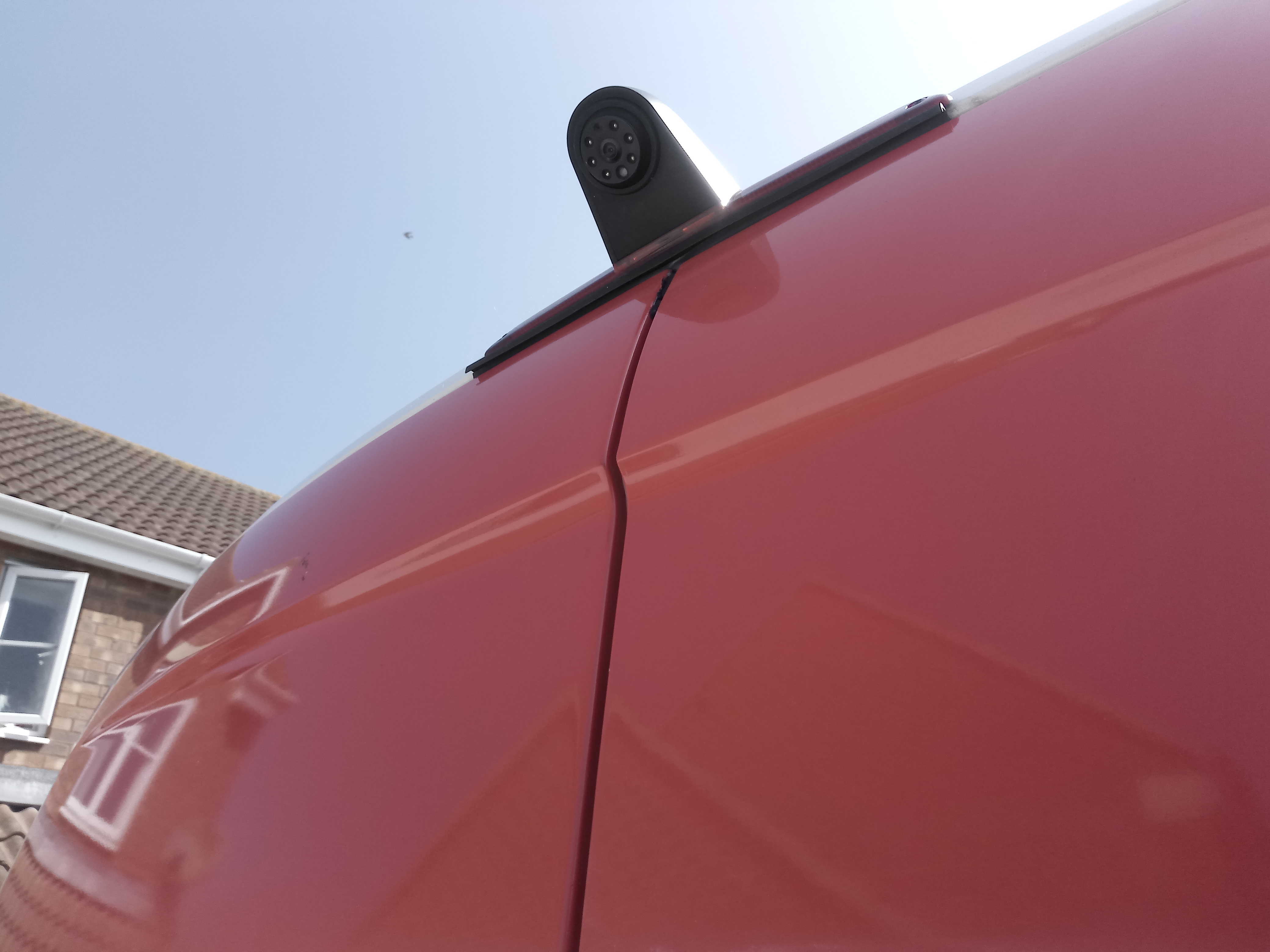

I have a few issues with the doors on the old Merc Sprinter 311Cdi 2000 Year
So the Rear door is not meeting properly at the top, have only noticed this recently maybe because parked in a different place to normal. See picture below.
The hinge bearings need replacing, mainly because Mercedes used nearside hing as offside hinge inverted and that causes more strain on bearing surface as hinge bearing on lower side when mounted that way. My son spotted that one and said it was a amnufacturing decision to reduce production costs but a bad decision mechanically. Saying that it is not the bearings causing the issue. Not sure how to fix, have thought about reversing up to a contained carefully with some batten or something similar to push the door in !!

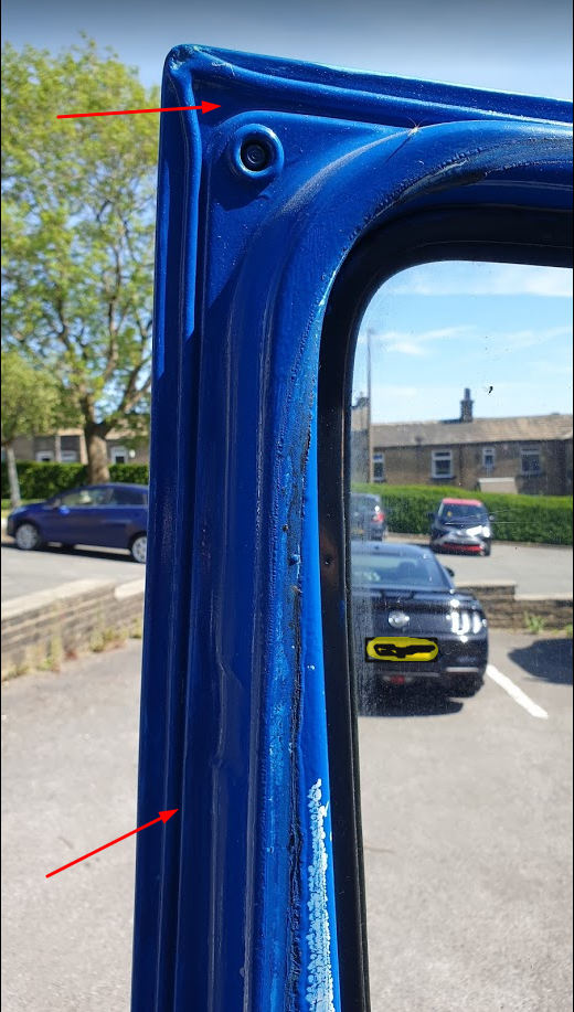

The other issue is the passenger door seems to still let rain in under windy conditions and I am wondering if it is to do with the fact that there should be seals where the arrow is but there are none. There are no seals on driver's door either but so far that has not let water in

Looking a the marks in the paint, I don't think the front door seal is mounted properly. As for the rear doors, I find you can often bend them to fit better.
This cab door seal/fit thing seems to be a very common problem with sprinters and the VW LT sister ship.
You can have a go at adjusting the hinges and try to bring the window frame in a bit closer maybe? I've adjusted both of mine to make them close nicely (they were poor before because the seller just swapped the green doors over with some white doors on another LT before the sale and never really set them up properly).

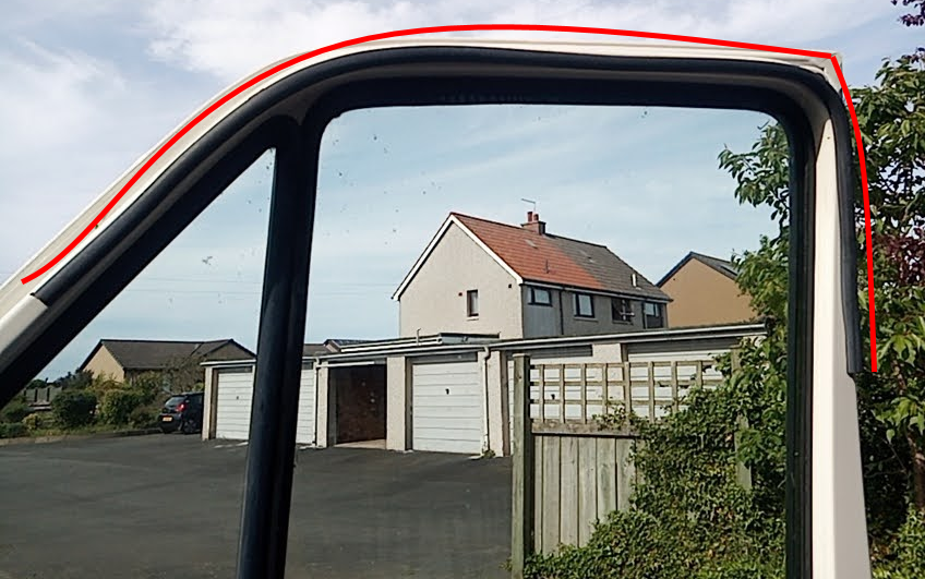

This is how the T5 door seal is added - maybe try something similar?

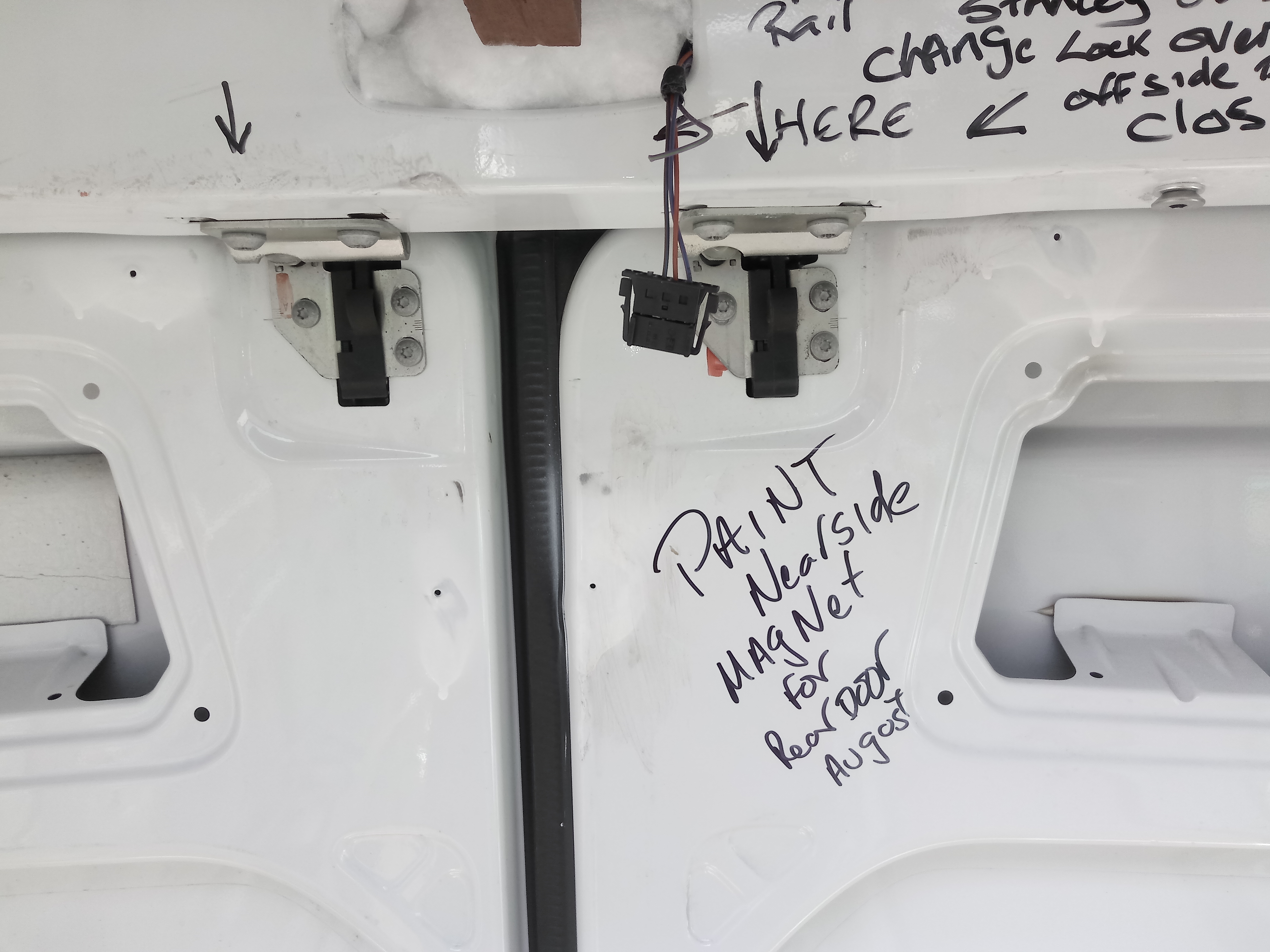

I've just had the same with rear top latch , just took latch off and put it on nearside and put nearside latch with good D on last closing door !

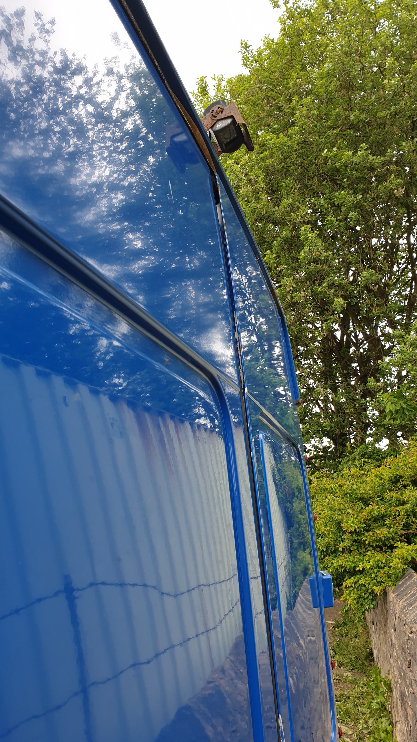

Have you considered that at some point in it's history some "low life" may have bent the door trying to get in?

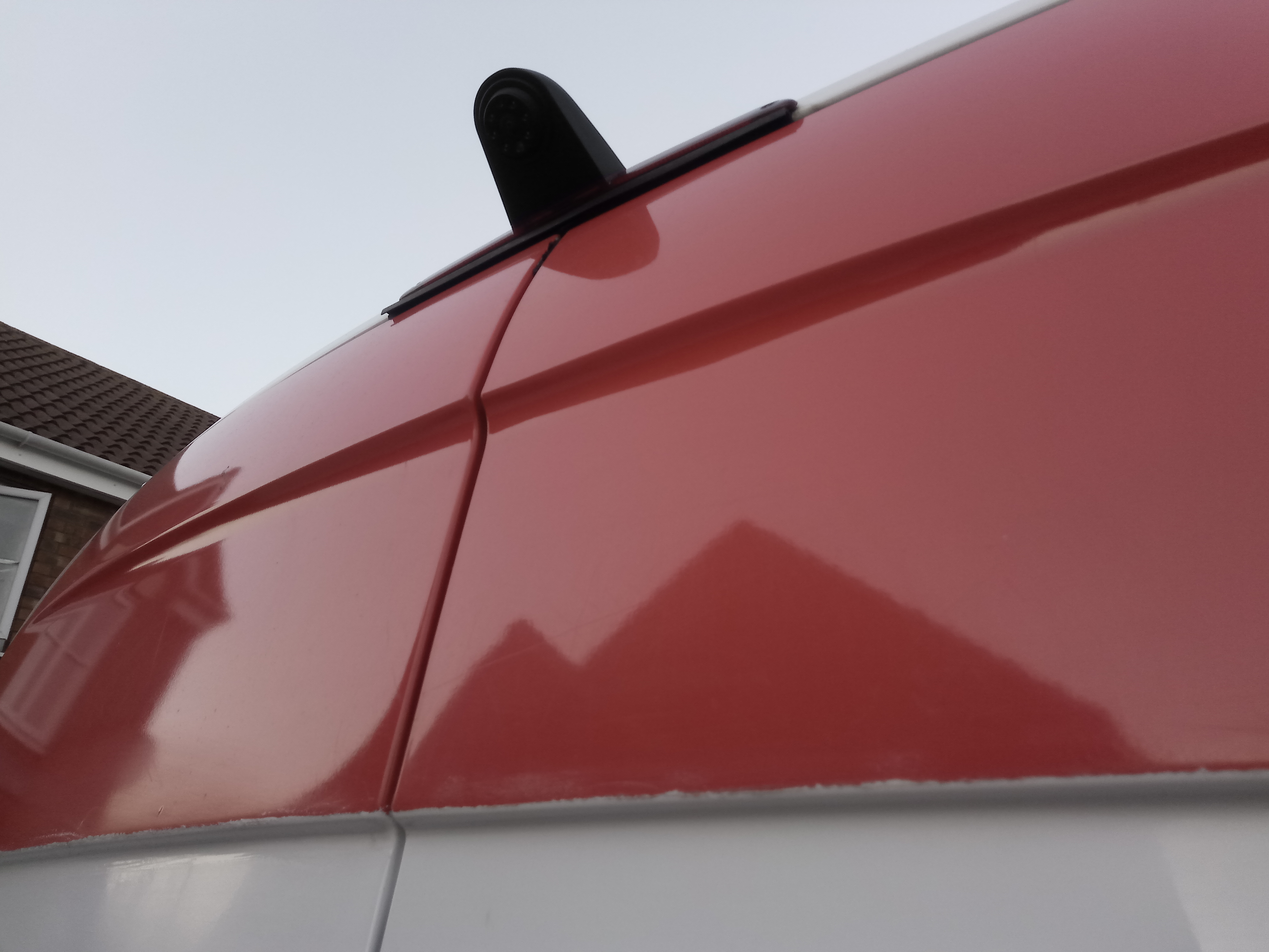

Apparently it (door gaps, not break-ins) is very common with Sprinters. One 'fix' is to mechanically bend the top frame in (as you would do if a gorilla bent the frame out to try and break in - I had someone do that on my Mitsubushi Lancer Drivers door)

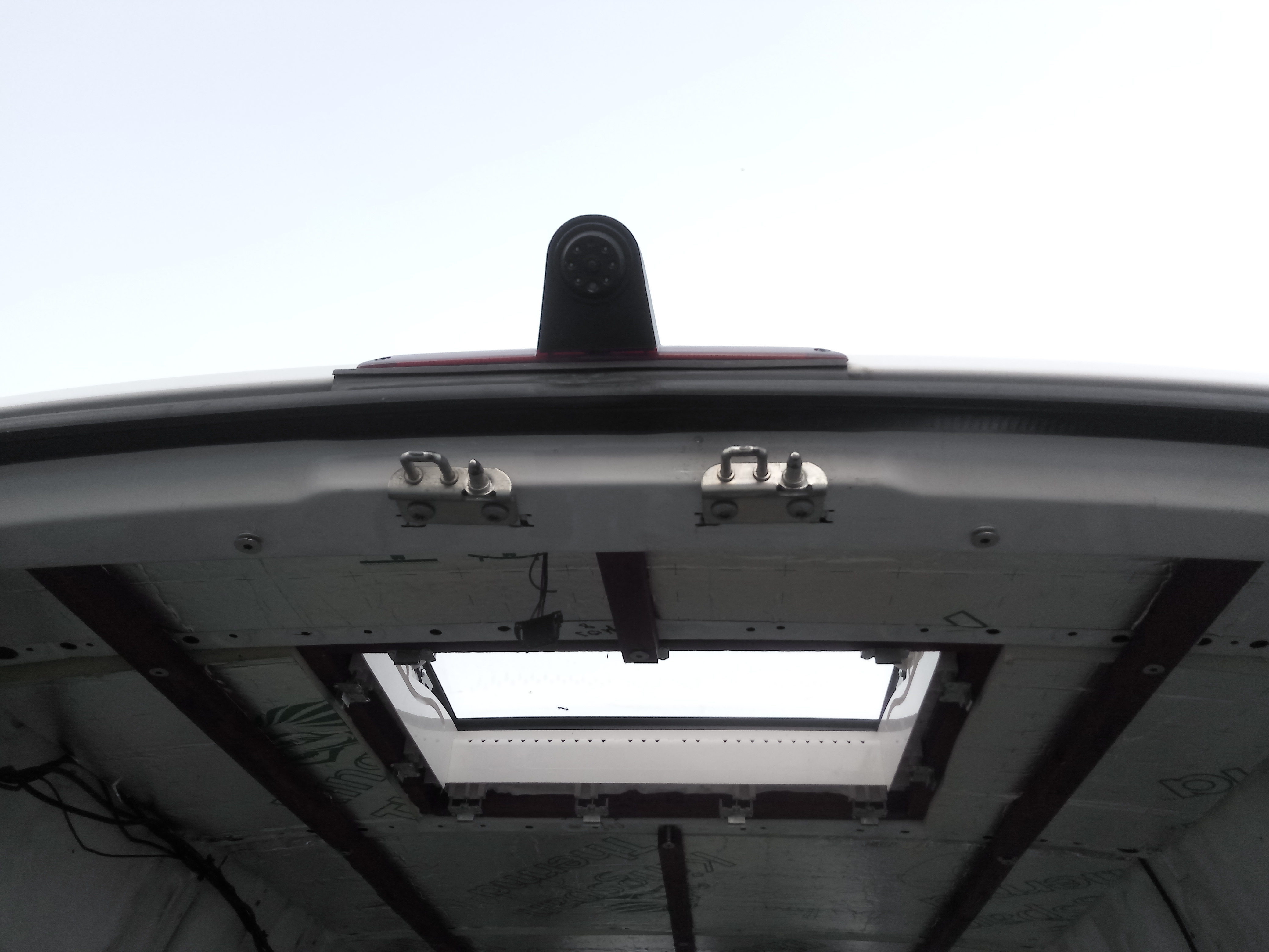

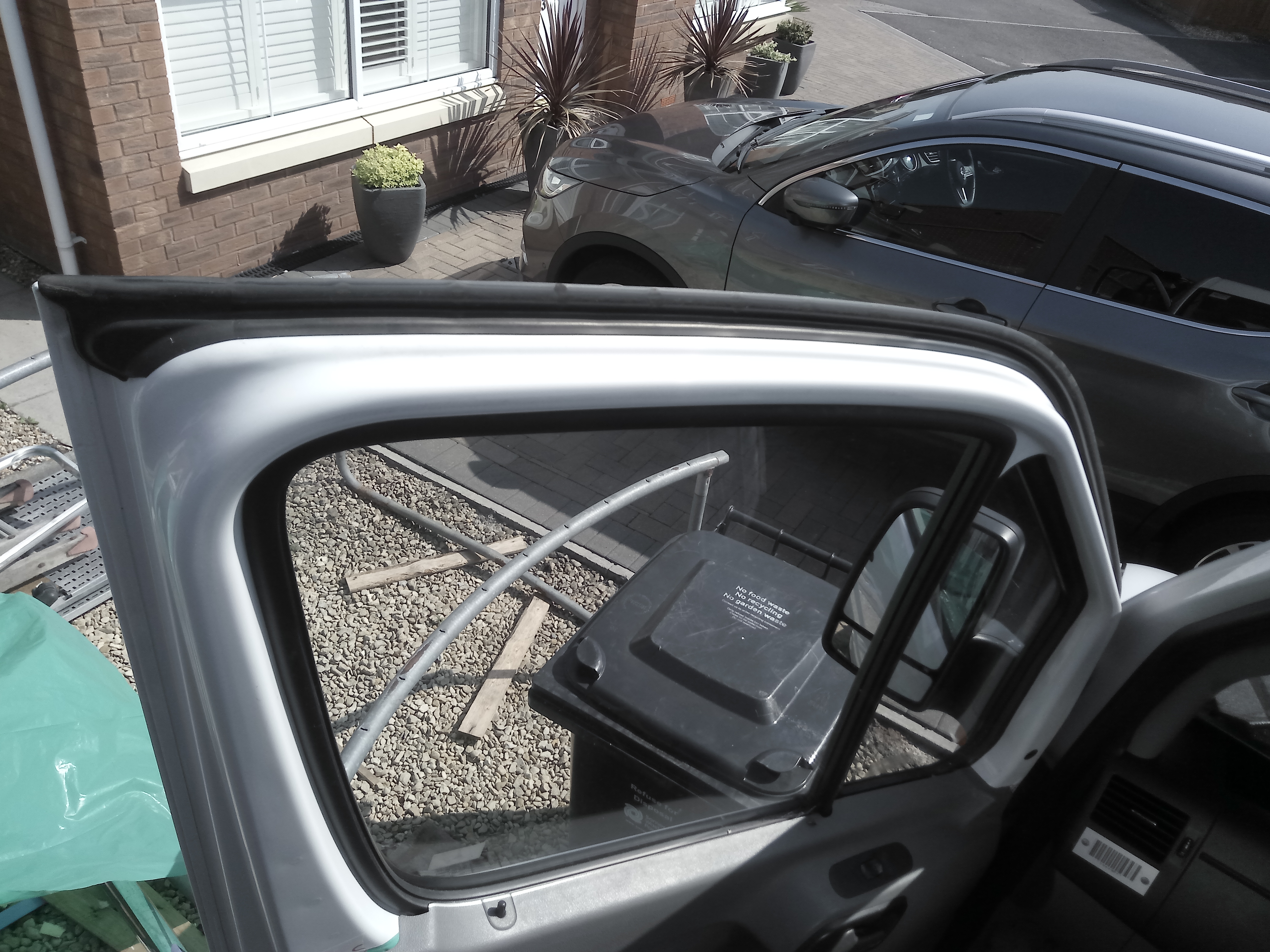

have a similar slightly worse issue on my Sprinter (year 2000 model)
Yes it's what's on the inside that counts

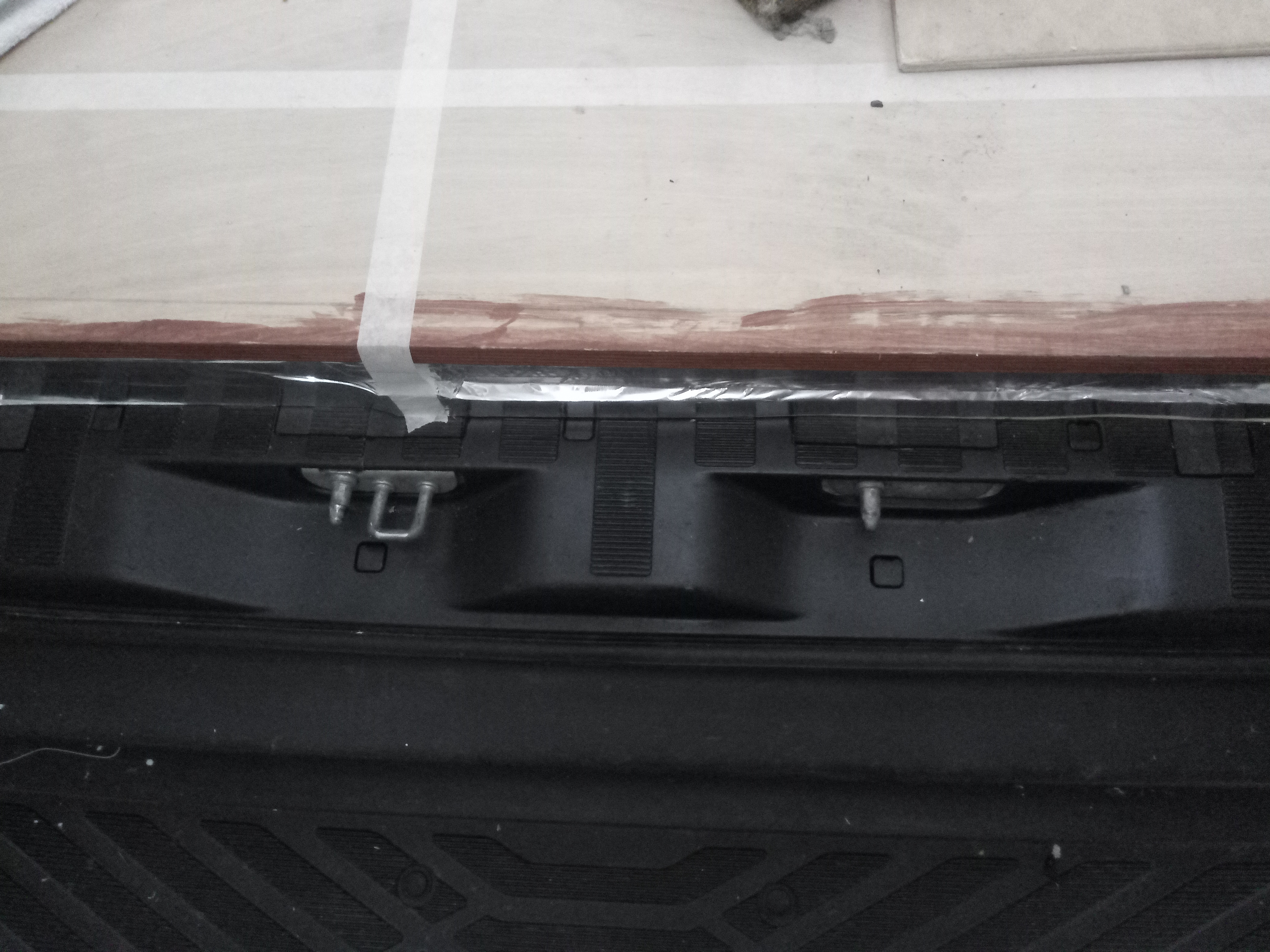

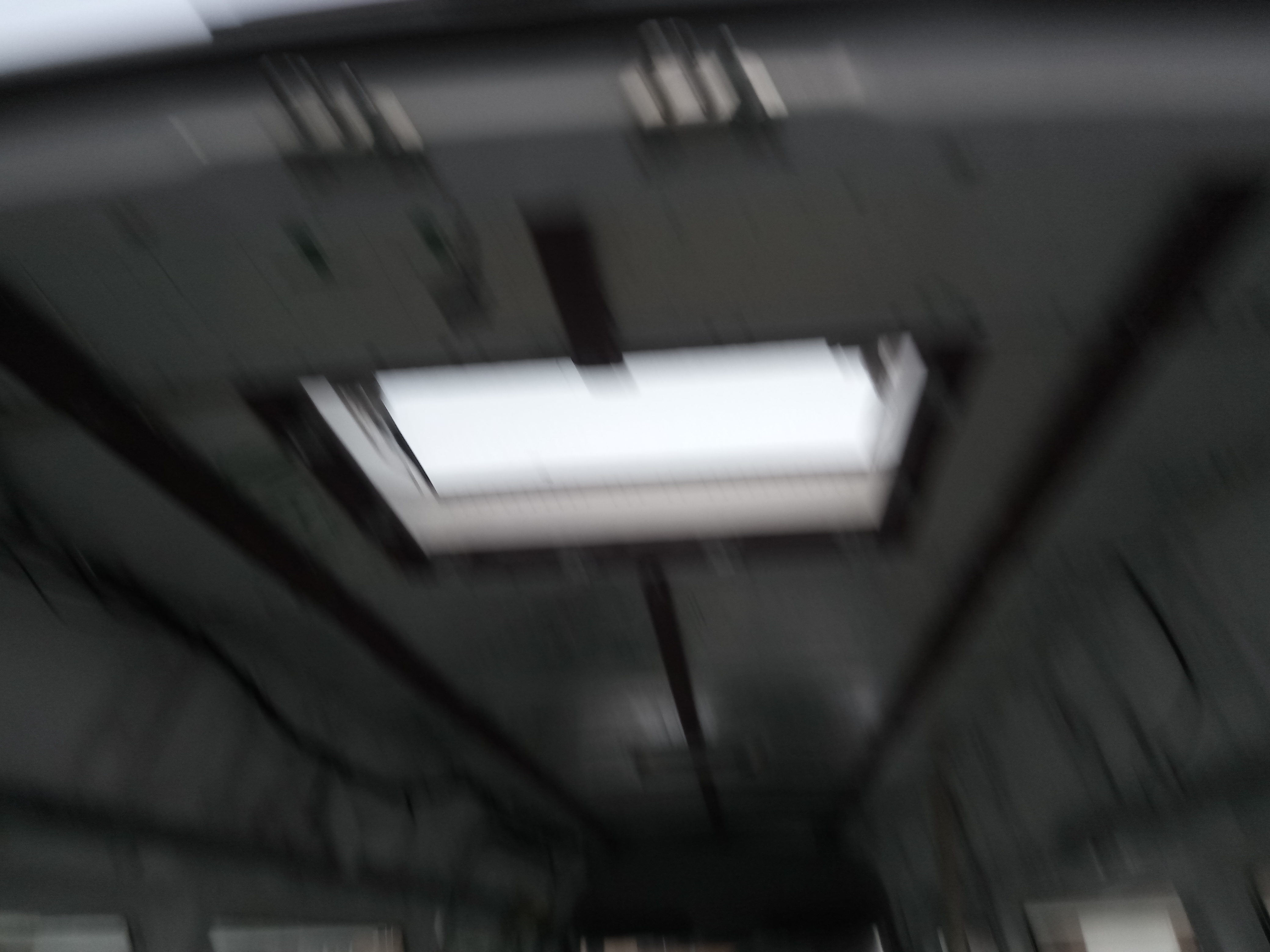

I have 3 D rings things . Loosened closed doors pulled hard at top of doors from inside, tighted star nuts from inside from inside.
Closed tight, and pushed on near side now as photography

What year is your Sprinter?
I have a VW LT from 2003 which is the same doors as the Mk 1 Sprinter I think, but have a quite different locking setup. Strange.
Are yours 3 point locks top middle and bottom with D rings ? phots. Mine is 2016 first of add blue. States it from 2008
2016? ah, different generation entirely. That would explain it. Your Sprinter is a different model to both mine and RAWs - we have the "T1N" version; you have a "NCV3" model.
