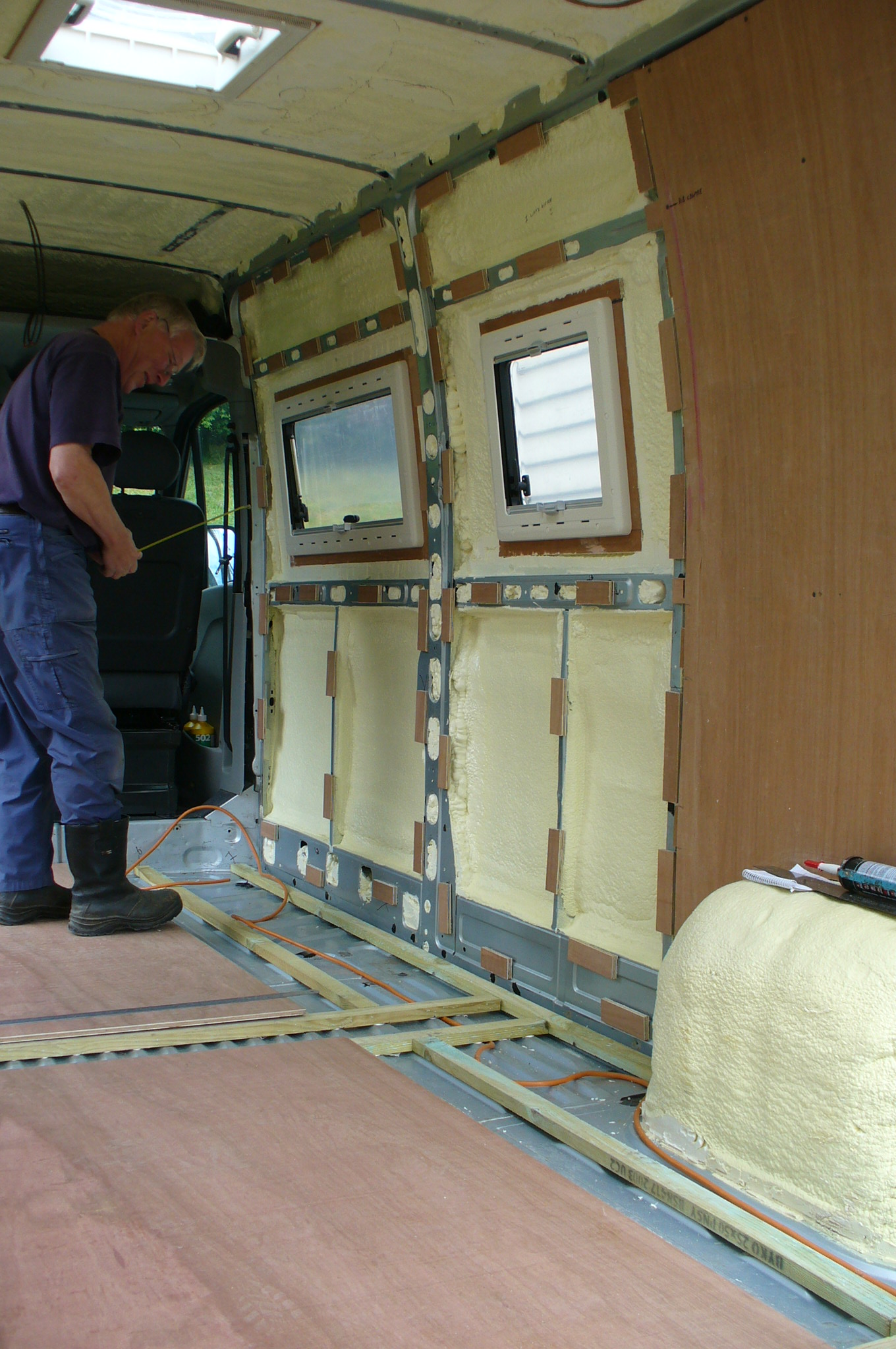

Almost without question, the best kind of insulation to be installed into any panel van or even lorry conversion is closed cell spray foam.
You can by DIY kits that several people I know of have used including @Kermavio who lives over in France, however these kits are expensive and the onus for getting the application correct is entirely on the shoulders of the persons doing the insulation and it isn't easy. As such the very vast majority of people who decide to go down the spray foam route end up going to time honoured professionals.
Arguably one of the most experienced of all these professionals in the UK is Adam at MPI Insulations, Church Street, Westhoughton, Bolton, Lancs. BL5 3QW
Tel: (01942) 811839 http://www.mpinsulations.co.uk/
When I was a member of the SBMCC I had 'Millie' treated by Adam and have never regretted it as it works so very well, keeping you toasty warm in winter months and cool in the summer months as well.
You will notice from the photograph below that I didn't have the floor done, my reason being the kind of layout/construction I had planned.

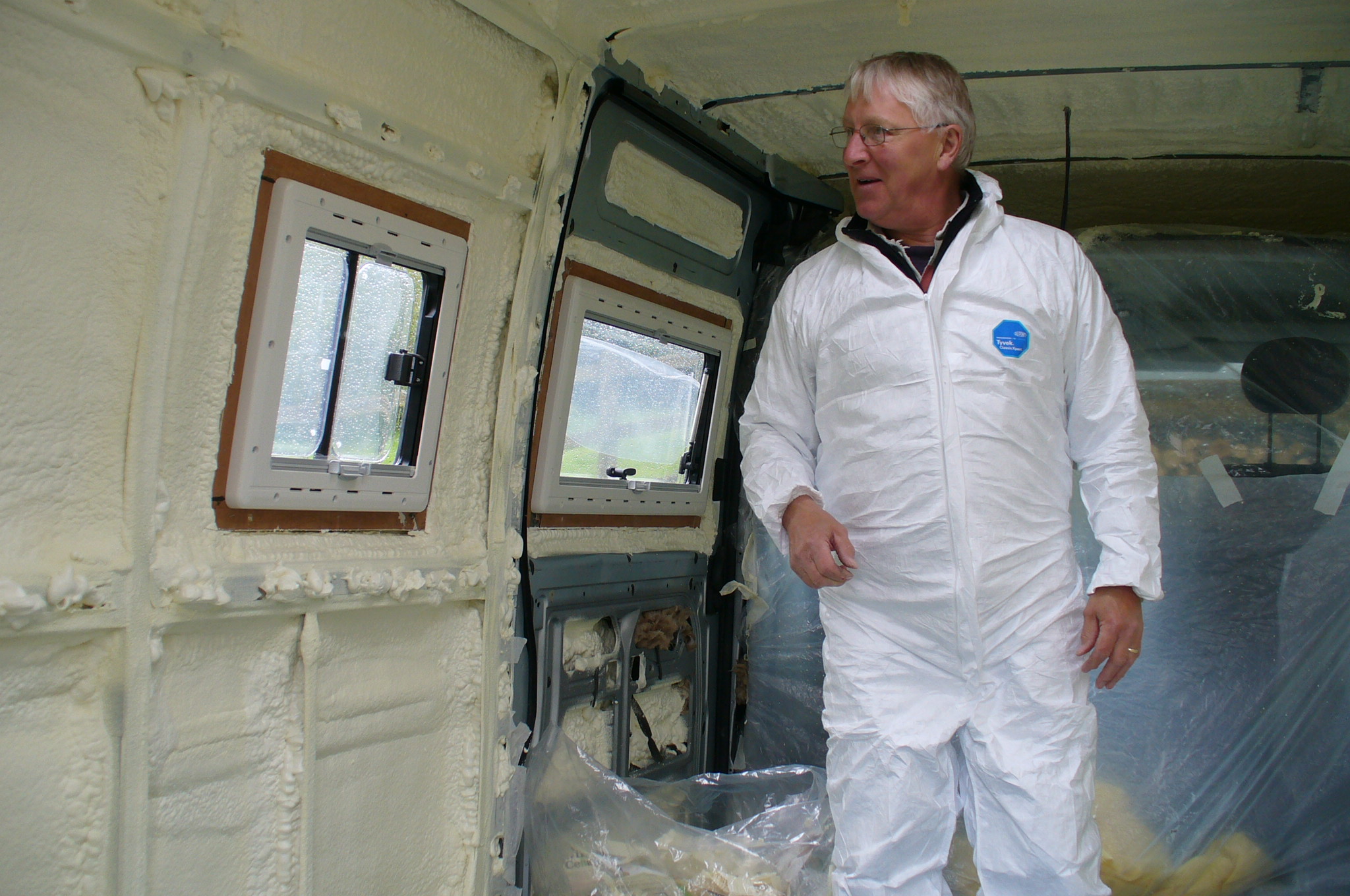

The one thing that you should look for when looking at any of their websites is how smooth the finished product is, the reason why I say this is that I know that properly and expertly applied, it is possible to get quite a smooth finish and that can only be achieved if the person doing the spraying regularly checks the temperature of the solvents as well as only giving the faintest misting with each and every pass of the spray gun.
If you do end up with a lumpy to very lumpy finish, then I can assure you it is a right royal and messy pain cutting it back to achieve suitable clearance for all the wall and ceiling panels.
Here below is an image of me suitably togged up (but in this pic. not showing the goggles, face mask or hood) when I was in the process of cutting my foam back, I hated it!!
