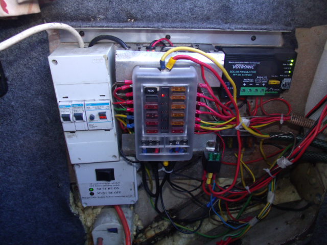

Simple, fit this before fuse box, green light if ok , red you flick the switch to reverse, all vans should have them fitted.
