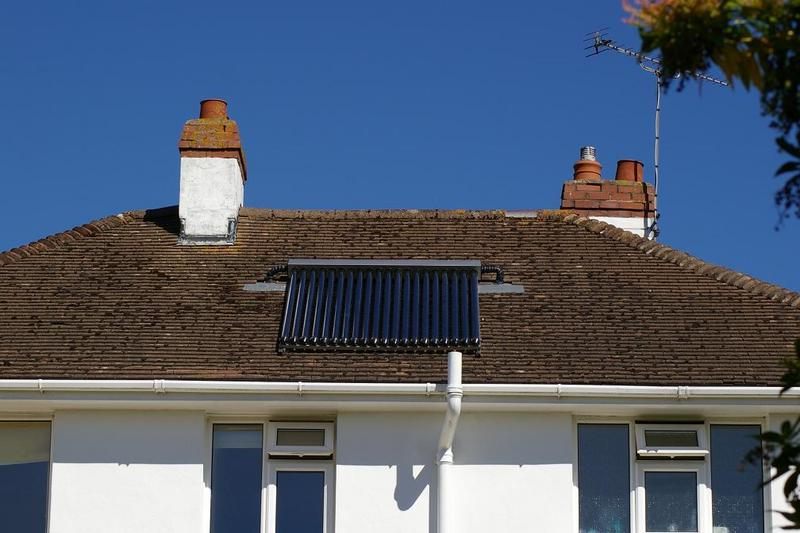

The general principle of using solar energy to heat water is a good one. This is the installation I had installed on my house in Devon:
But that is on the south coast, facing near enough due south and at an optimum angle. You won't get that on a vehicle.

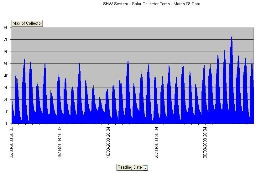

You can see how much the fluid got warmed up each day from this graph
In the summer, had loads of hot water and never used the boiler (it got bypassed automatically). In the winter, had a typical 20C increase in the water temp going into the boiler.

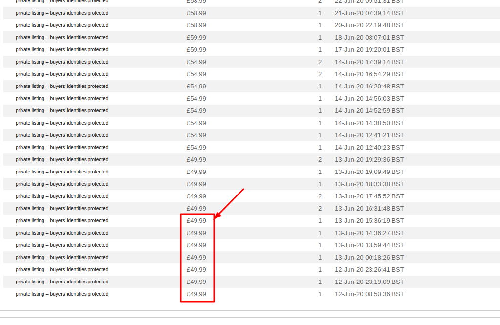

Were at £49.99 and now £120.99 - £80 price hike in under two months, I would not buy from that seller and look elsewhere. Nonethless an interesting way of creating hot-water via solar that could be mobile so thanks for sharing @Sprinter 1 cup :-)

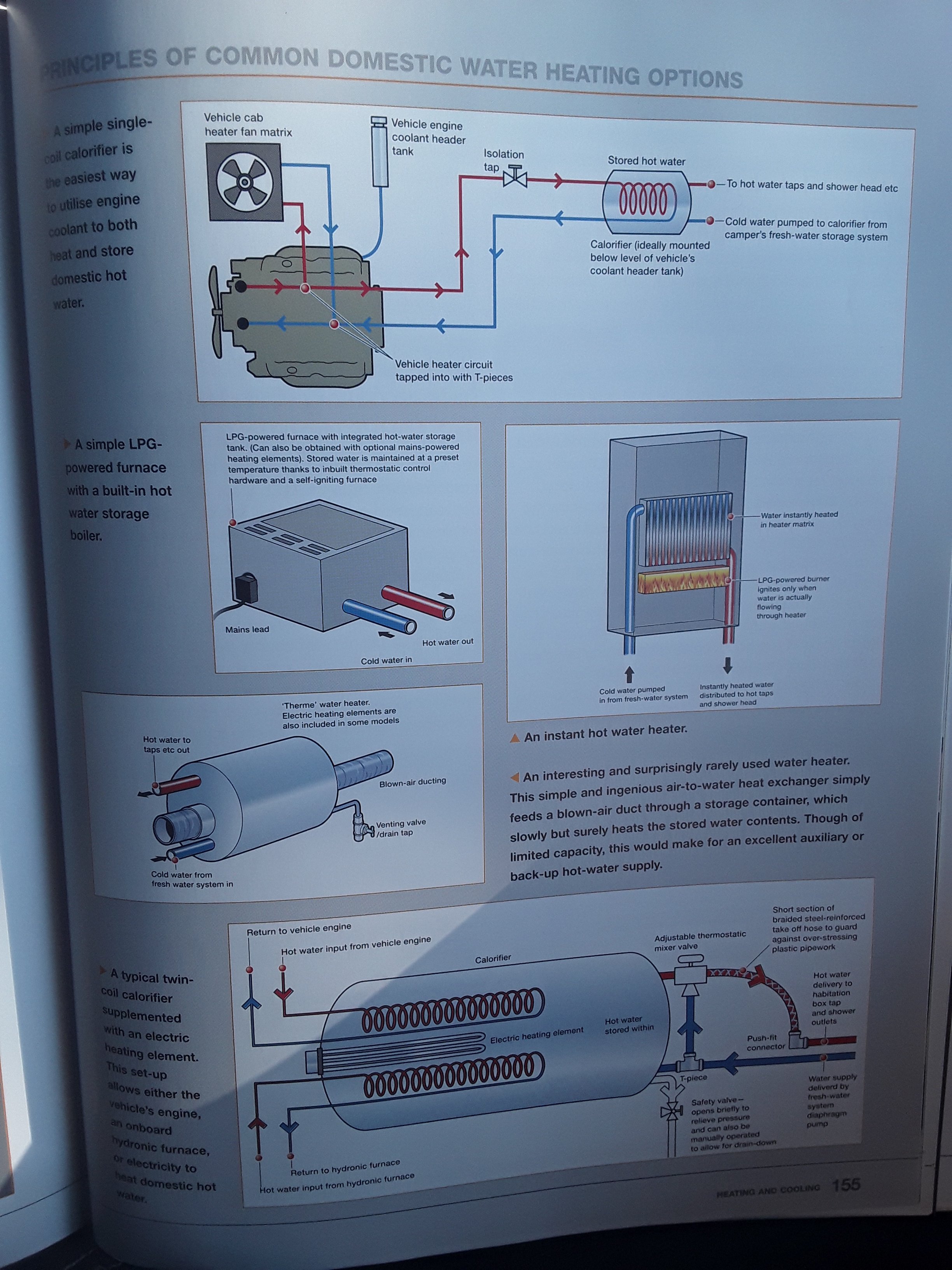

I did abandoned the idea of solar heating. I can't remember if I mentioned this on here, but I picked up a second hand Carver 2 in good condition.
My first thought was frozen pipes but you could drain down. What material were you thinking with reference to longevity due to weathering? I appreciate that it's not ideal for when you are static for a long period but if you are up for a project maybe using hot water from the engine to heat a well insulated calorifier might be more suitable for the UK. Hot shower every few days might be more appealing than regular tepid showers and no shower in winter unless you are 'hard as nails'. I have assumed it's to wash with as it's a lot of work for just washing up
Keep us posted
I'm not trying to put you off a solar project but unless you travel further south frequently I'm not convinced in the UK it's worth your time and money. Engine air or water would be an interesting and rewarding project

I was going to fit a multi plate heat exchanger in the heater circuit (enables temp control via the dashboard heater valve) and calorifier
And a eberspacher hydronic to warm the engine water when the engines off....
Never got round to it so must stick the heat exchanger on ebay when I find it lol.
  • Well Done
Reactions: RAW
We use a calorifier connected to the engine coolant. So when we stop we have a tank of hot water. if untouched it's still hot after 24 hours.
Of grid we can heat the water with an eberspacher. I like Wildbus's idea of using surplus solar to heat the water, but you'd need a big inverter or low wattage element for the calorifier.
