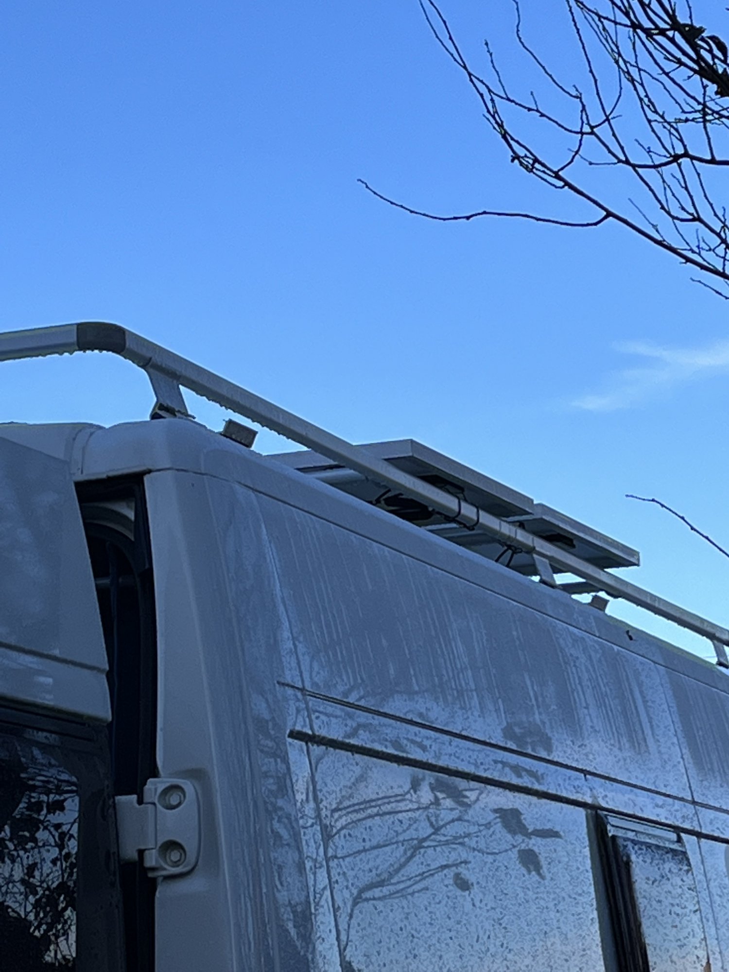

If you have a clear roof to play with, the approach I would suggest is to build a rail system - maybe using unistrut for example? you would then have a super-adaptable mounting system where you could do just about anything you want and if you want to change panels, be juat a matter of undoing a few bolts going into the rails.
I used Aluminium Seat Rails
Roof Tracks Prepped
by David, on Flickr
Attached to the Roof and then any panels just got bolted to the rails - no loads of adhesive to apply (and maybe remove) and minutes to move or change a panel for another - including different sizes.
PV + Fan
by David, on Flickr
Used that principle on a few vans and IMO it works very well.
Roof Tracks Prepped by David, on Flickr
PV + Fan by David, on Flickr
