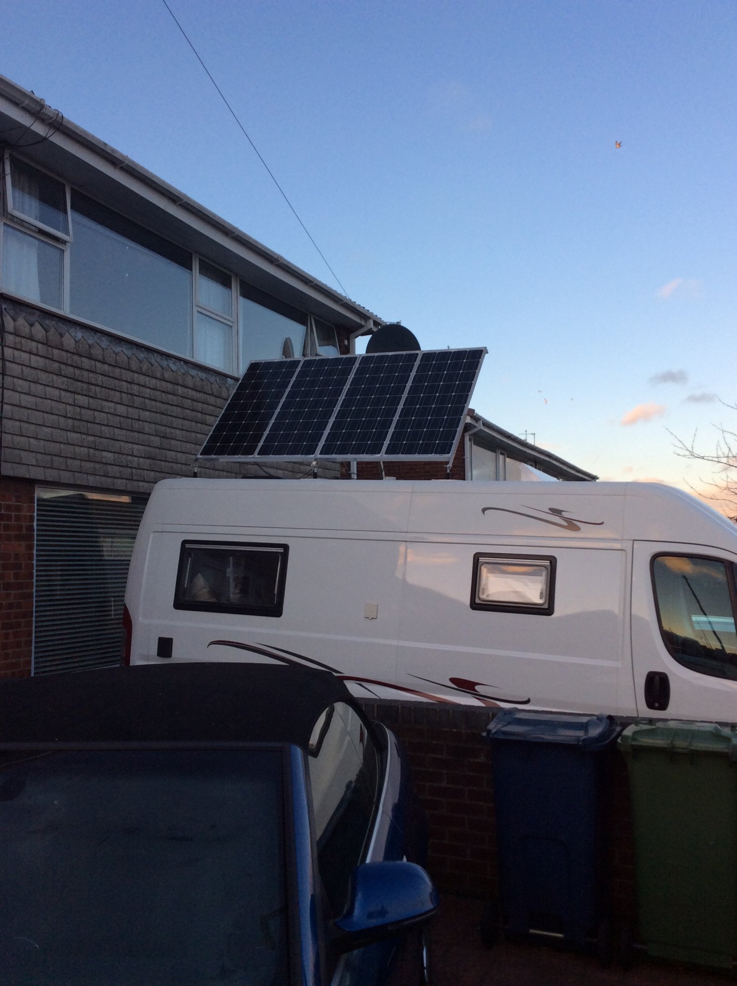

I'm not sure what is best to clean the panels; some of the cleaning stuff these days may harm the glass. Also, is it a good idea to use car polish on them or not? I don't feel I was getting the best out of them, even on very sunny days.
I just use soapy water Kev then hose it off.
In the pub on Thursday I was chatting with a bloke who fits large solar arrays in fields and I asked him how they are kept clean. He told me that most are self cleaning these days.
I don't know if mine are (I suspect not) but I suppose for self cleaning they would need to be at an angle rather than flat.
Yes, the angle will help on a house, and I dare say being black (ish), they heat up and burn a lot of the crud off that gets washed away, but these, like most MoHo ones, are pretty flat all the time.
