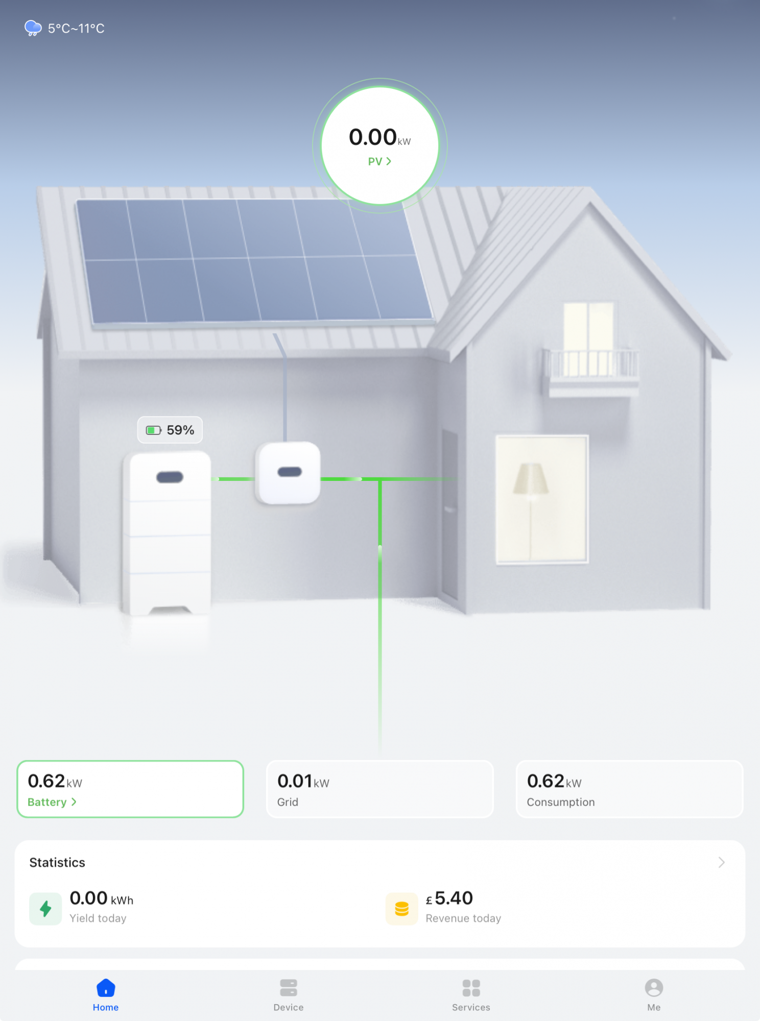

Yep good solar day, ran the house for £0 and charged the car for £0 which was good as I was busy in the workshop and again £0 wind up tomorrow so the turbine will kick in. Reckon I’ll get my investment back about August 2026
Out of interest, how long have you had your domestic system installed? It took approximately 12 years, to recoup the investment on out 3.5 KW system, as near as I can estimate.
This was roughly in line with my own calculations, which was much longer than the installation companies estimate. Still, it will be financially beneficial, If I live long enough.
6 years, but I have 46.53 kw of solar and 30kwh of battery and run 2 EVs (that’s the biggest difference) I also have a wind turbine and the investment was £16.4k total, but that was because I did 95% of the work myself and a very well insulated house.
We also have a 3.5kw system Mick. Repaid in 7 years although the installer estimated 12 years. We did qualify for max FIT though. Did 11 kw yesterday. (y)
A bit like the post above. We have 3.5kw of solar which (before we invested in storage batteries quite recently) repaid in just under 6 years (installer calculated 12 years) but we do have a very good FIT. Although we have oil heating everything else in the house is electric. We have 2 x Powerwall storage batteries and 2 x EV. With all this our electricity provider has just reduced our electricity direct debit to £5 / month (admittedly I was a reasonable amount in credit as £5 /month doesn’t really cover the dreadful standing charge!). I get paid a lot more than this in FIT so feeling relatively smug. The added benefit is protection from power outages of which we have already had 3 this year and we’re still in February!
