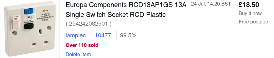

Mins testing plug. on very dry days I would still use a spike or mat wetted, to be sure to be sure. 😂

Trevor, the voltage alternates on an inverter. You don’t have a live and neutral, they are both live. Though not at the same moment. If you ground the so called neutral, you must have a rcd circuit after to offer some protection.

Wrong from what i read, only one side hot, other is ground, also best to run through the RCD unit rather than just an extension lead, your call.
I've got a basic socket tester, I'll try that when I'm all set up. I'll also have an RCD socket on the end of my cable from the inverter. So I assume if my socket tester shows the correct sequence of lights when plugged into my inverter outlet when it's switched on all is well? Crikey, didn't think it was going to be this complicated just to run a fridge for a few days!😁

your bulb will just trip the rcd , they compare the current in the two live wires, or live an neutral, if its not balanced they trip. probably better to ensure theres always a rcd on the inverter output rather than maybe , sometimes, when you remember , can be bothered to using an earth spike or plate. same with generators.

Watching that it says RCD wont work with a inverter, learn something new every day, folks please disregard all the crap I have put on. 😂 (y)
