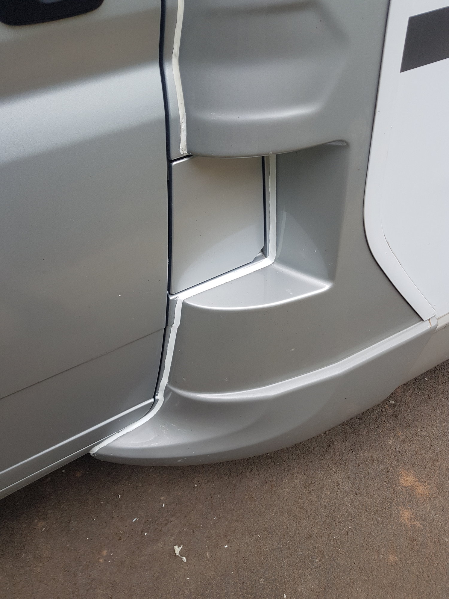

Silkaflex 2 Questions
The reason im wanting to change back to grey/ silver( white had been applied by the company i purchased it from) is the sealant is heavy at points and would look less obvious, it's only cosmetic.
I use a silicon in the coffee van that is quite a close match to your colour. Have a look at Everbuild 225 colour Brushed Steel.
Found this on line. When you think about it a lot of kids animals are painted and they are made of some form of silicon rubber. Your biggest problem is getting the old stuff off without damaging the paintwork or the plastic mouldings. I would hazard a guess that the mouldings are white and then sprayed so any damage is going to be visible.The joint needs to flex as it's two different types of material. Prosthetics have to be painted to match skin colour. Toys have to be painted to appear more real. Might be worth a try and you can probably make it less obvious. Where do they get these idiots from that do jobs like that. Suppose they are just following what comes out of the factory. Phone number at the bottom maybe of use and they may have an idea where you can get the paint from.

My biggest worry in painting silicone is wont the flexing cause cracking to the paint. When the time comes i'll use a scalpel and remove most of the silicone first.
On my acrylic windows and pollycarbonate headlights I use good old T-Cut and a bit of elbow grease...... works a treat!
I would not try it on metallic paint .. It has a lacquer over the base coat. If you rub to hard you will go through the lacquer and finish up with a right old mess.
The reason im wanting to change back to grey/ silver( white had been applied by the company i purchased it from) is the sealant is heavy at points and would look less obvious, it's only cosmetic.View attachment 83544
Have you had the van from new or bought 2nd hand only asking because if you bought 2nd hand you may find someone skimmed more sealant over the old sealant
I'd try a plastic razor blade... less chance of accidental scratches.
Failing that, please don't wield the scalpel on Sunday after Zooming with the rest of the reprobates on Saturday night :giggle:
Purchased from RS 2nd hand, evidence of original sealant which has been removed.
I cant see any garage seller spending a lot of time to re-sealant a van probably more likely to dug out what was necessary and just re-skimmed - those joints always fail after time anyway some quicker than others.
Try looking at at mastic joints on cars vans that can have been painted might give you additional options if you decide to reseal
