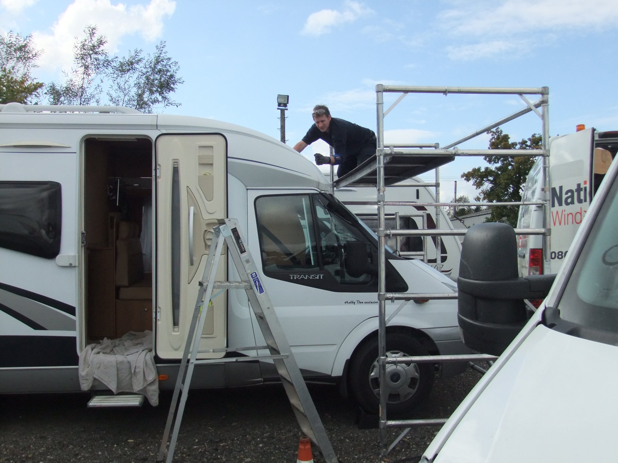

Never attempted myself, but there was a recall some years ago on large numbers of Hobby motorhomes due to this issue. The action was refitting by dealers where this was possible, otherwise refitting by the coach windscreen units of National Windscreens. I managed to get the latter.
