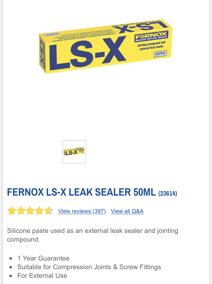

I’d try Fernox LS-X which you can get at any plumbers store or Screwfix, it’s a special silicone in a small tube to use where PTFE tape used to be used and can be used on sink bowls when adding pipe work
