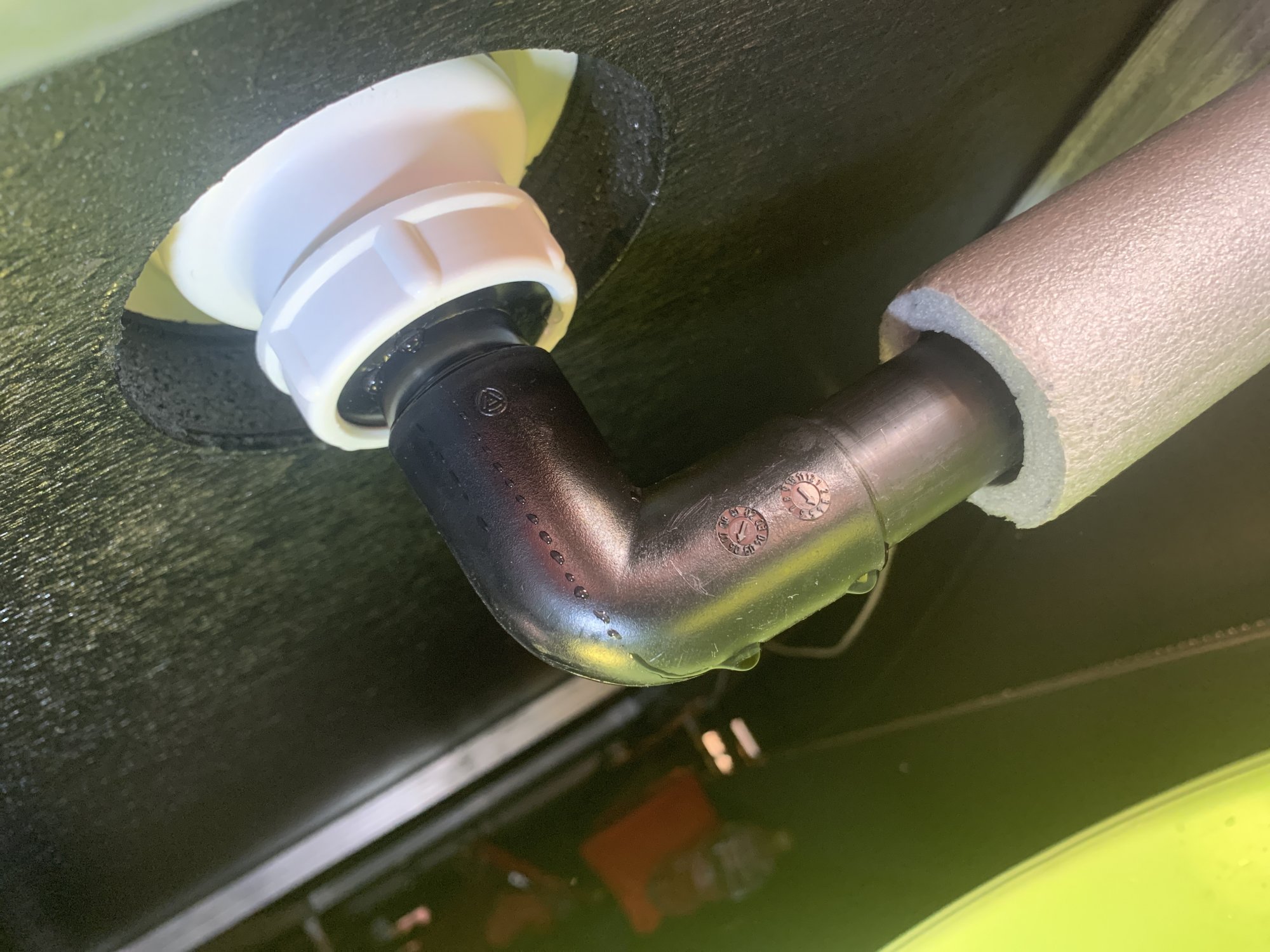

image.jpgLatest update. I think the blockage is clear. Somewhere in the process I have caused the connection between the shower waste and the waste water pipe to leak. I’ve been back and forward to hardware shops, Screwfix and Toolstation trying to find a suitable replacement washer. I can’t get a exact match and every one I’ve tried still leaves a small leak into the Motorhome garage from the threads onto the shower waste

Try some PTFE tape on the thread.
Thanks. I will try that.

Your leak was probably cause by using a the plunger and may just need slackening, pushing home and retightening.
