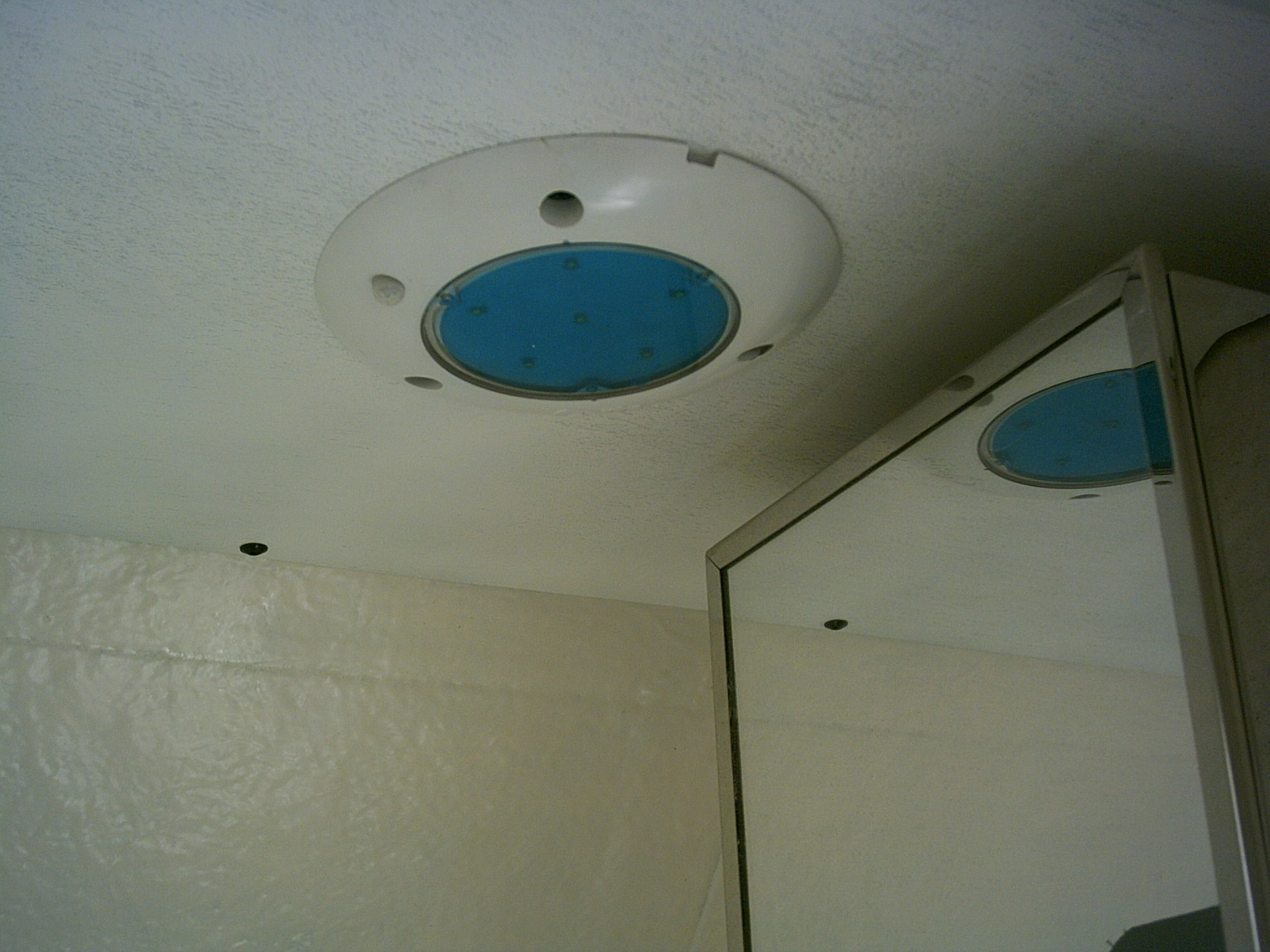

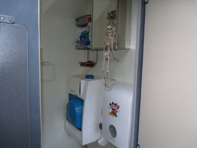

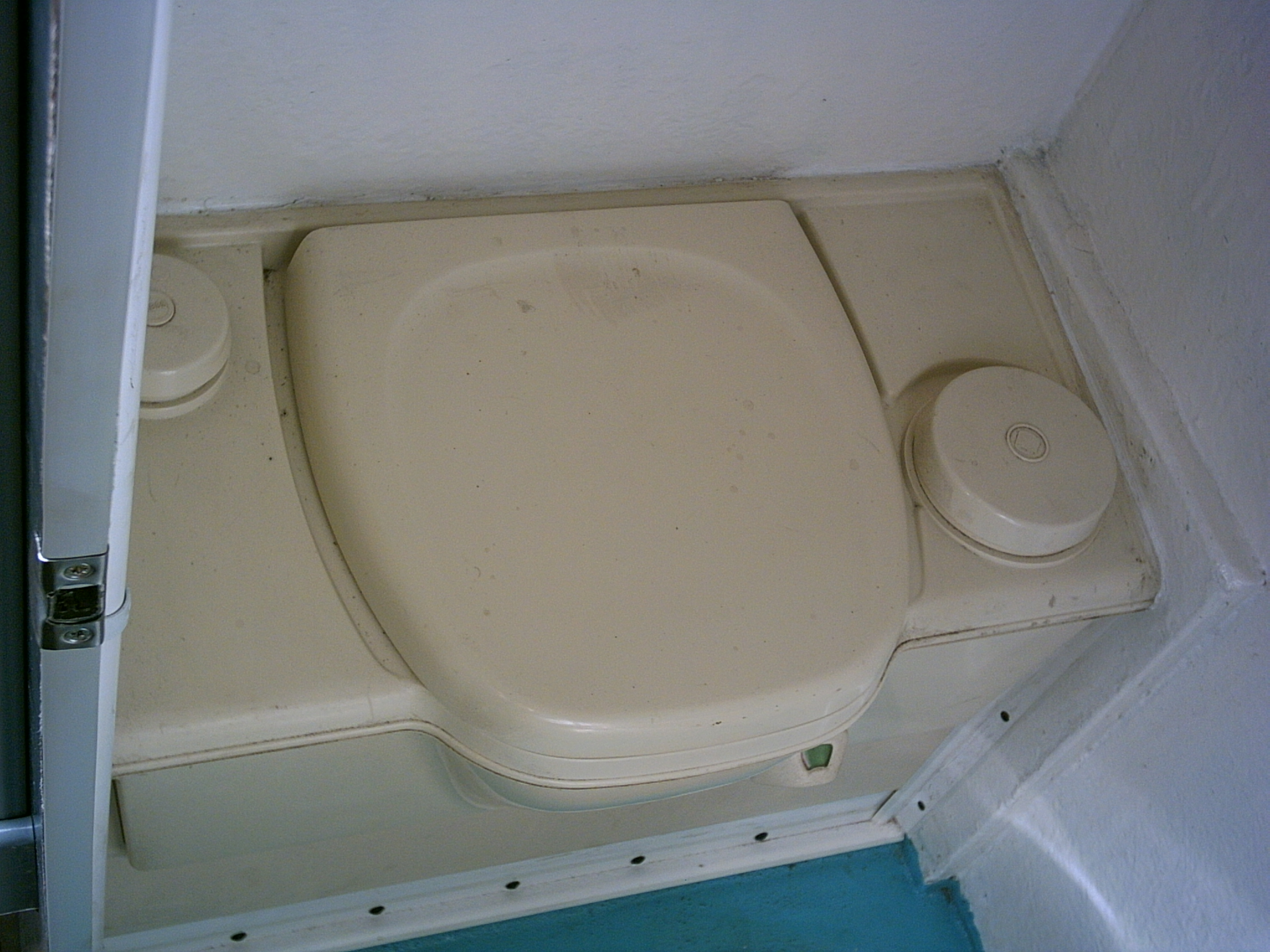

I built my toilet wash room in wood and then covered with GRP with a light cream colour mix.
