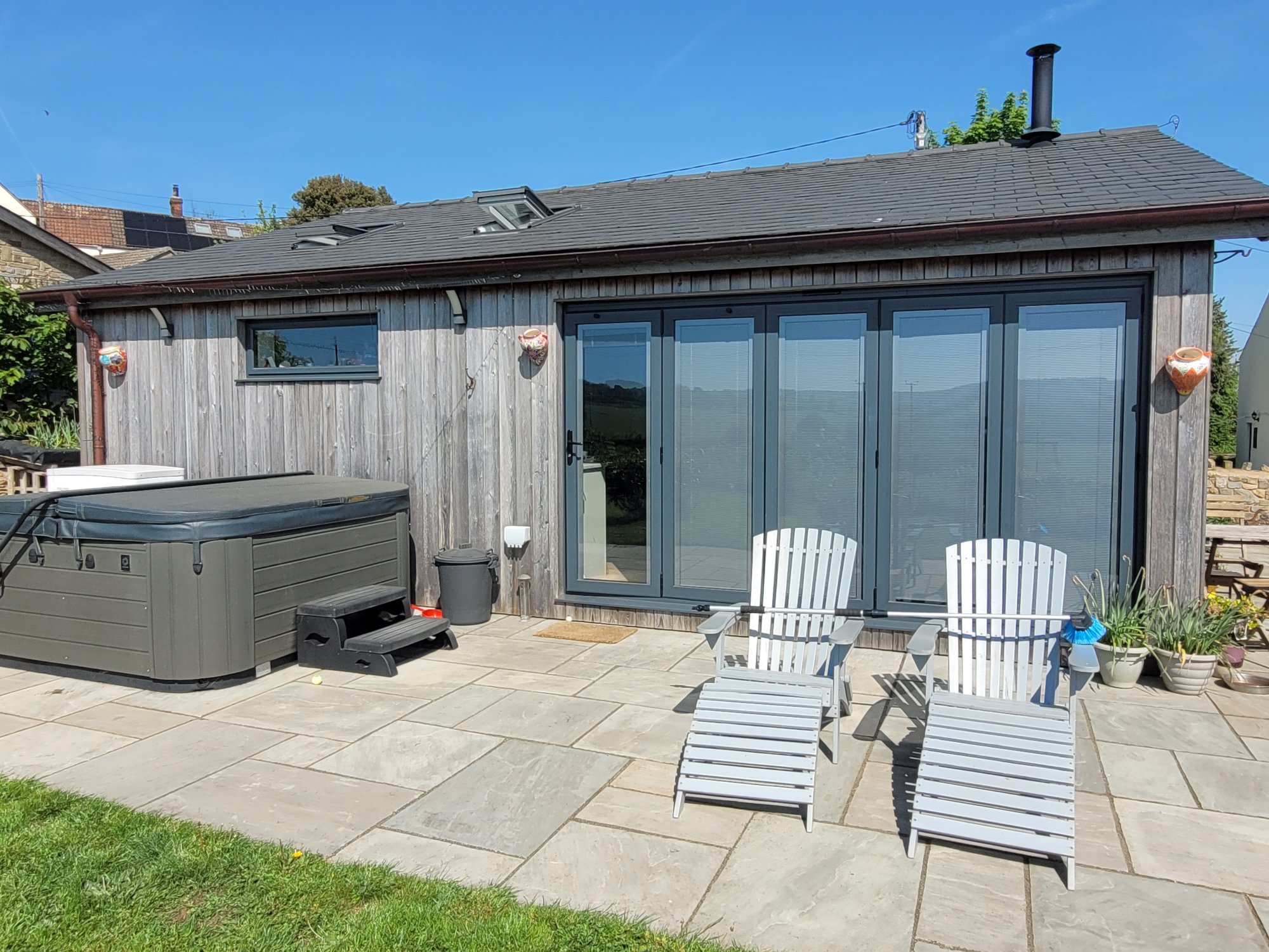

We used untreated 20mm Larch when we built ours. It's supposed to last to around 30 years. Built using stone with Larch cladding on 50%.plus the view is nice
