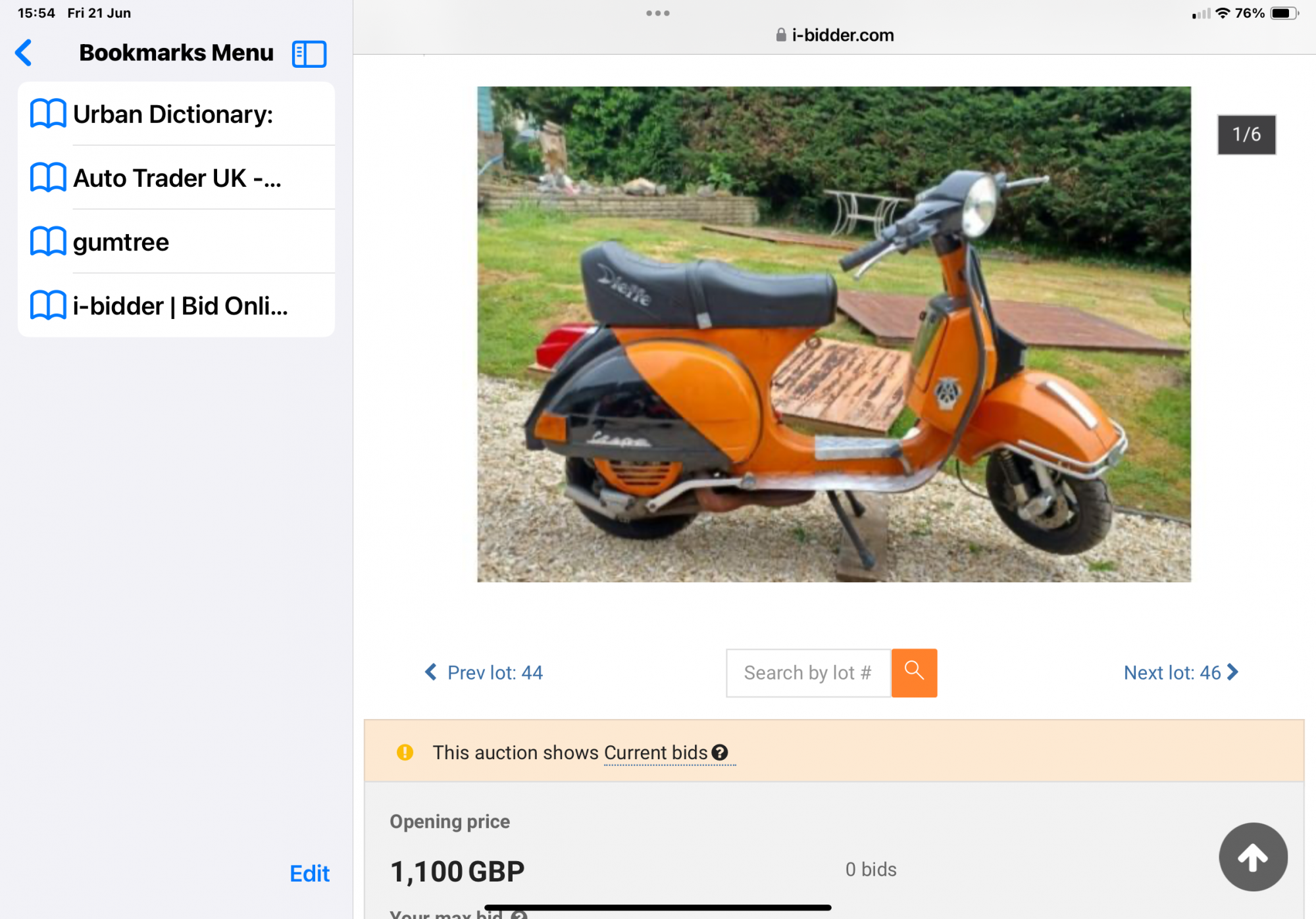

I do love the look of the Vespas. I almost bought a 300 GTS once but ended up with a Piaggio BV350. Not for use with the van, just for having fun on. We have a Honda Vision 110 now. Love it.
IMG_1196.pngYou’ll like this
