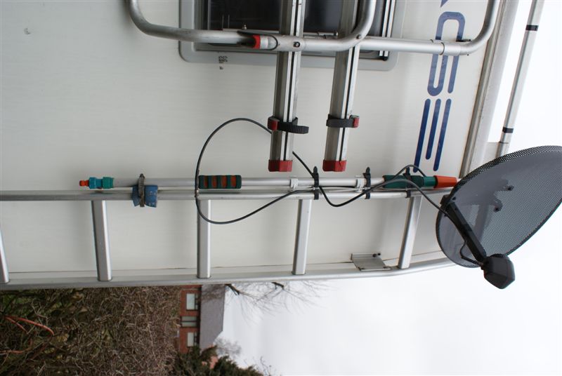

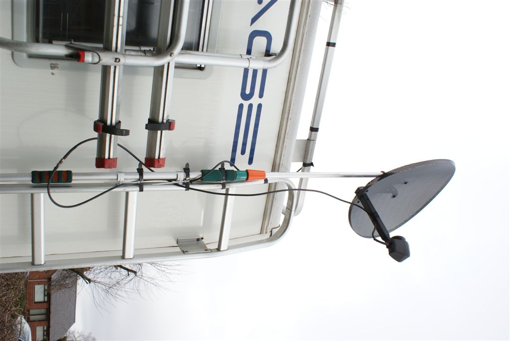

I've got a redundant sky dish clamped to a redundant aluminium extending brush pole clamped to the rear ladder. This has worked as far south as St Tropez.
Allen

Hope the attached pics explain it a bit better. The pole was approx £ 10 from a hardware stall, jubilee clips & plastic pipe clips from builders merchant.
regards
Allen

Thanks Allen, thats just what im thinking of.
When you push the sateilite up higher and point it the right way, does it take long to align it with the sateiliete.
Do you use one of them meters?
thanks again.
Craig

does it work at that angle:eek:

The receiver I use is the 12 volt comag (maplins, lidl, maxview...they're the same). It has an in built sat finder sound generator. I switch the system on, press favourites, press say bbc1 north west, I then can hear a loud low hum 'cause I'm not on the satellite. Open the rear window, then go outside and spin the pole a bit (use a compass to approx locate 28 deg E astra 2 sat). Within seconds (never more than 2 mins) the low hum turns into a high pitched shriek and gorden burns (preferably ranvir) will be talking to you.
I'm amaazed every time, it's that easy. Of course you have to have the dish at the right elevation. From leyland up to the lakes, and onto york I didn't alter it, but at whitehouse I had to elevate it by 1 degree.
A meter is usefull to prove that the connection are good, as it lights up or the arm deflects. This shows you are getting power from the receiver to the lnb and back.
There are a couple of steps I've missed out from above concerning switching on the comag sat finder but are simple to follow in the manual.
Allen
