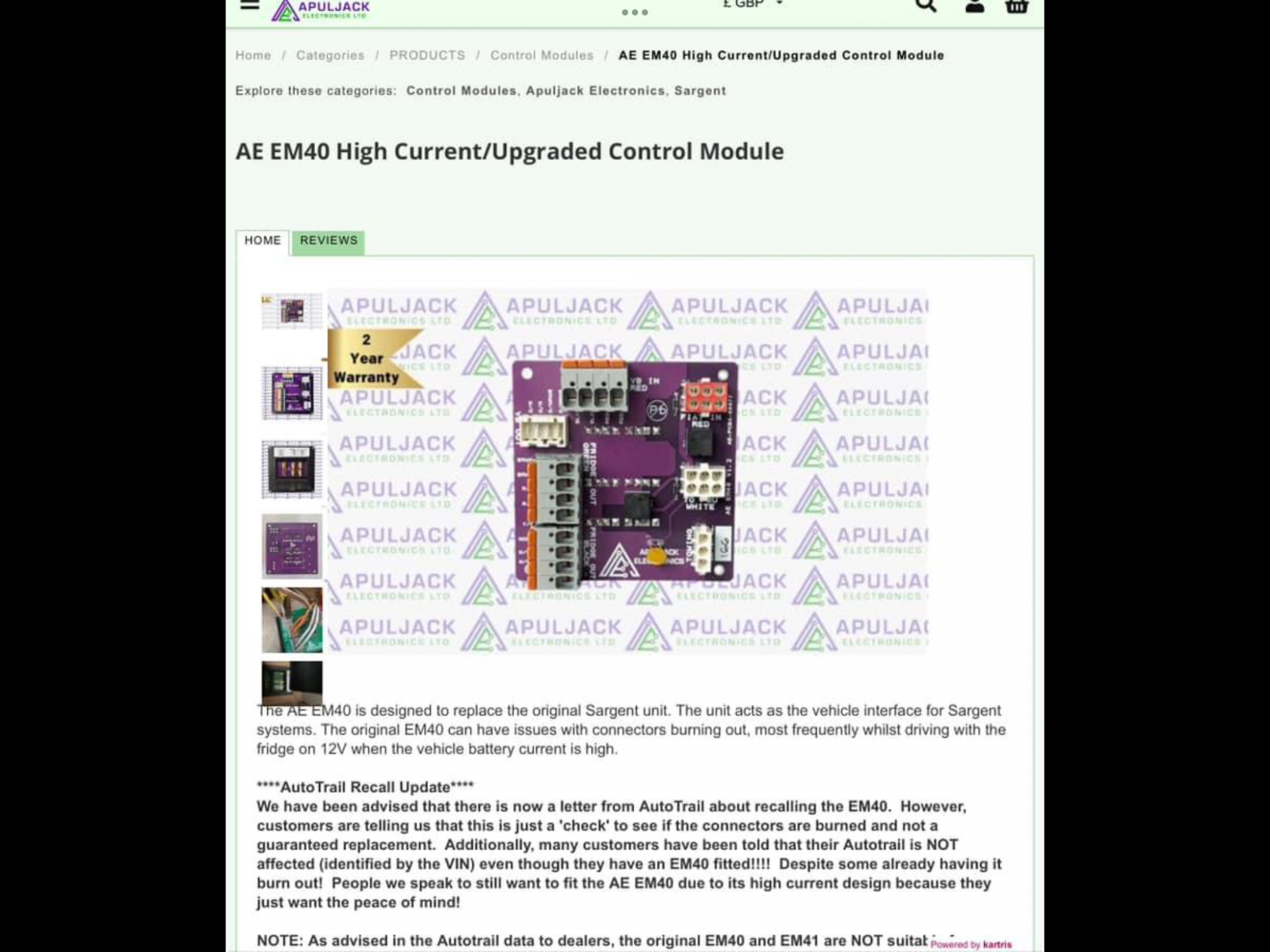

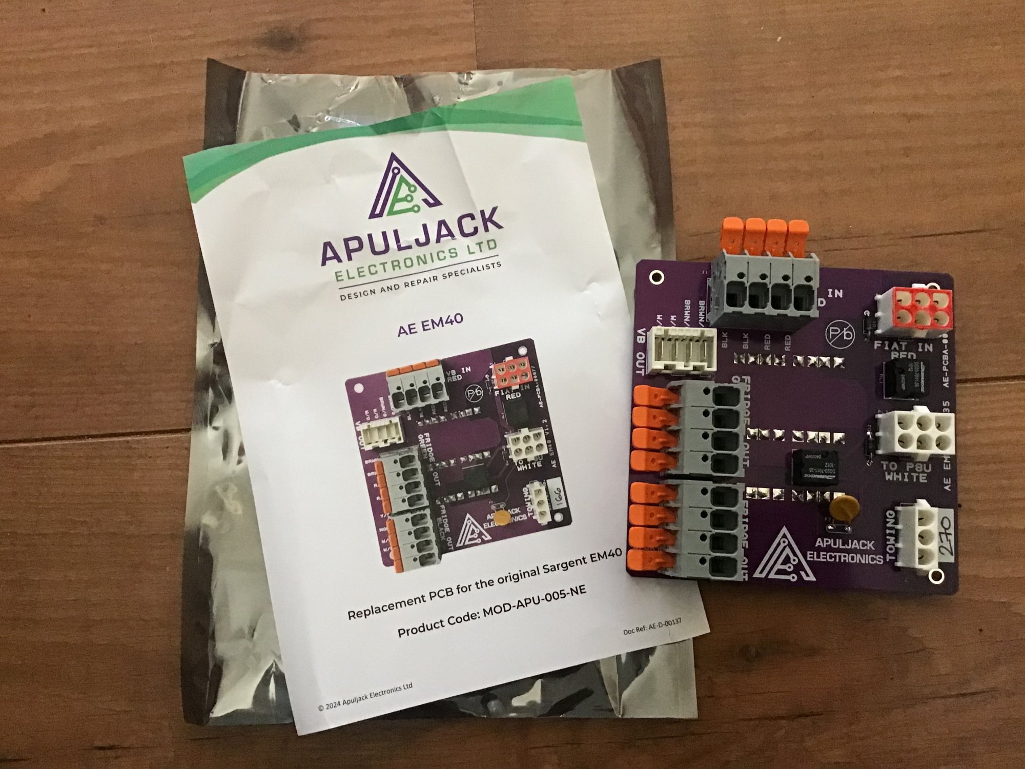

If it was myself I'd have removed the board and fitted a couple of decent connectors onto the cab battery and fridge connections, better still do away with the connectors altogether and wired directly to the board. I guess that sort of work isn't for everyone but it's simple enough with a few appropriate tools.

Another example of Sargent electrics: attempting (and failing) to insert two 1.5mm mains wires into one pin. Result: sparks, things not working, alarms, fire.
