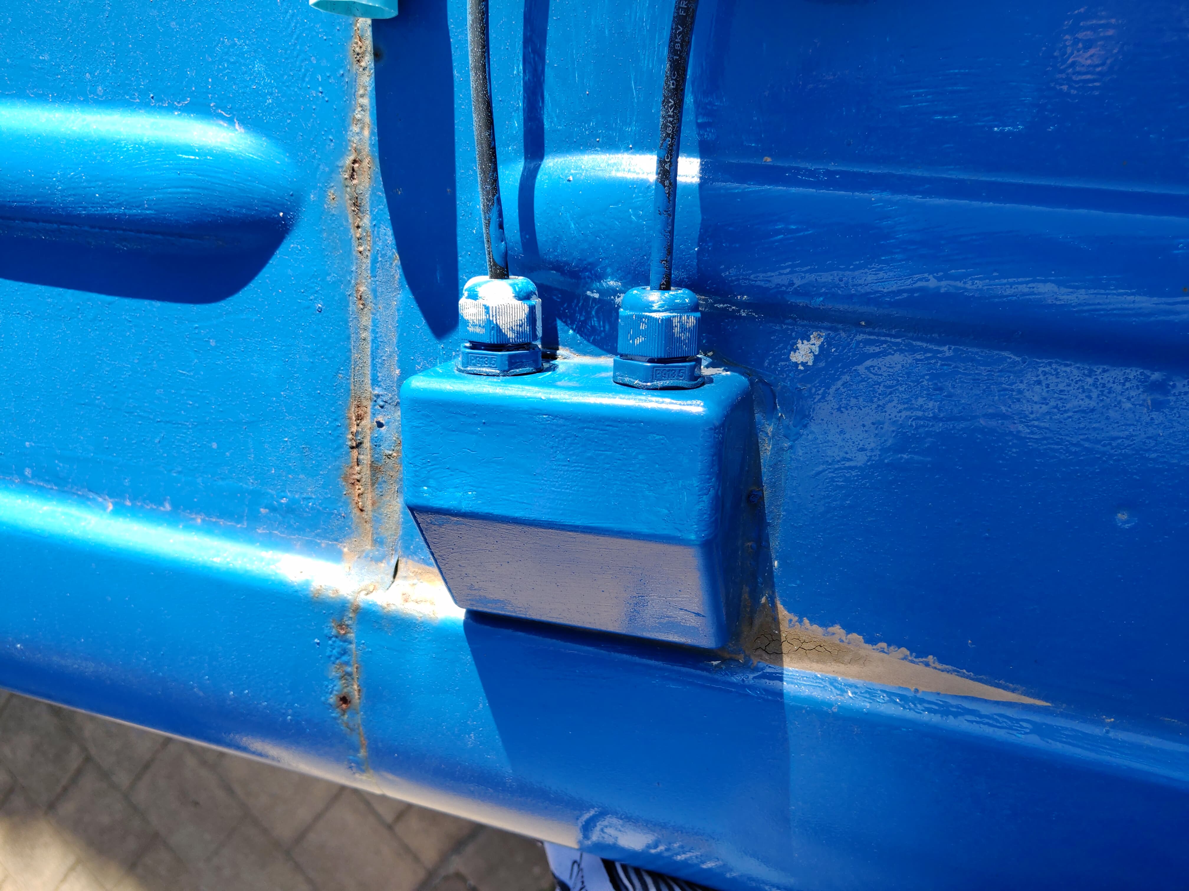

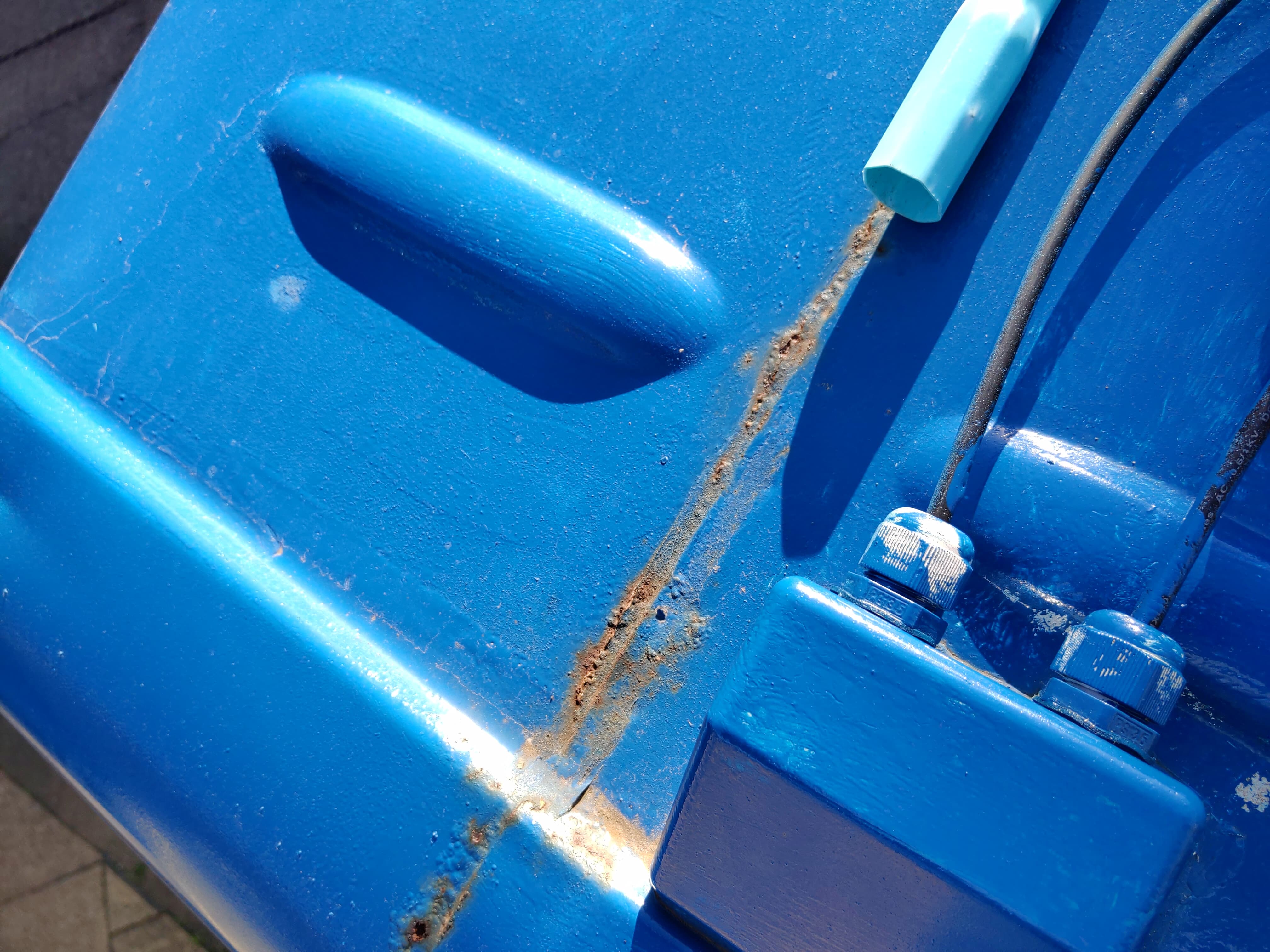

What's the best fix good people - Merc Sprinter Year 2000

My guess would be that the van was repainted and the rust was painted over and now is bubbling again.
not too bad considering the age of the van, especially for a Sprinter! (the roof paint is generally meant to be terrible on those)
What I would do (and maybe will on mine as I have a few bits of rust on my seams) is the following:
1) sand off the paint on the seams to expose the rust
2) apply some Hammerite KRUST. This does a good job of stablising the rust (it claims to convert the rust back to metal I think but that is a bit of hype). After a short time, the area goes from blue to black as it works, and then you can overpaint.
3) overpaint with solvent paint, not water-based (for old vehicles like ours are, I go for Cellulose-based paint that doesn't need any top coat)
