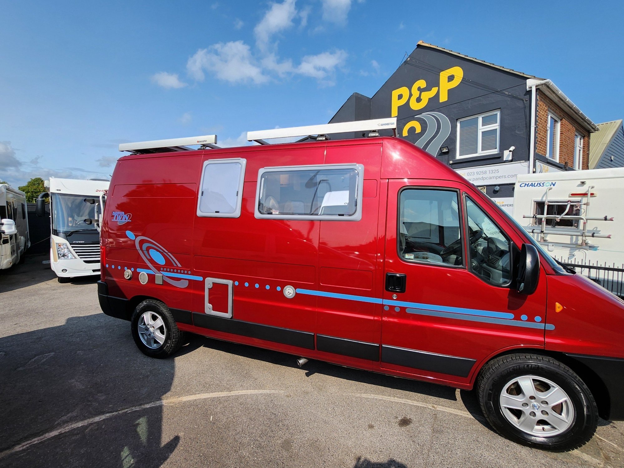

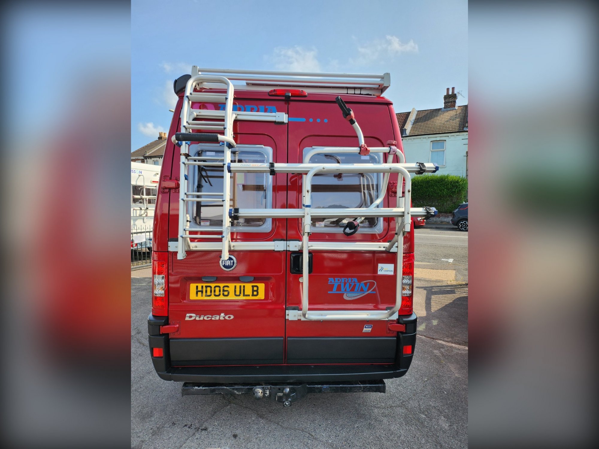

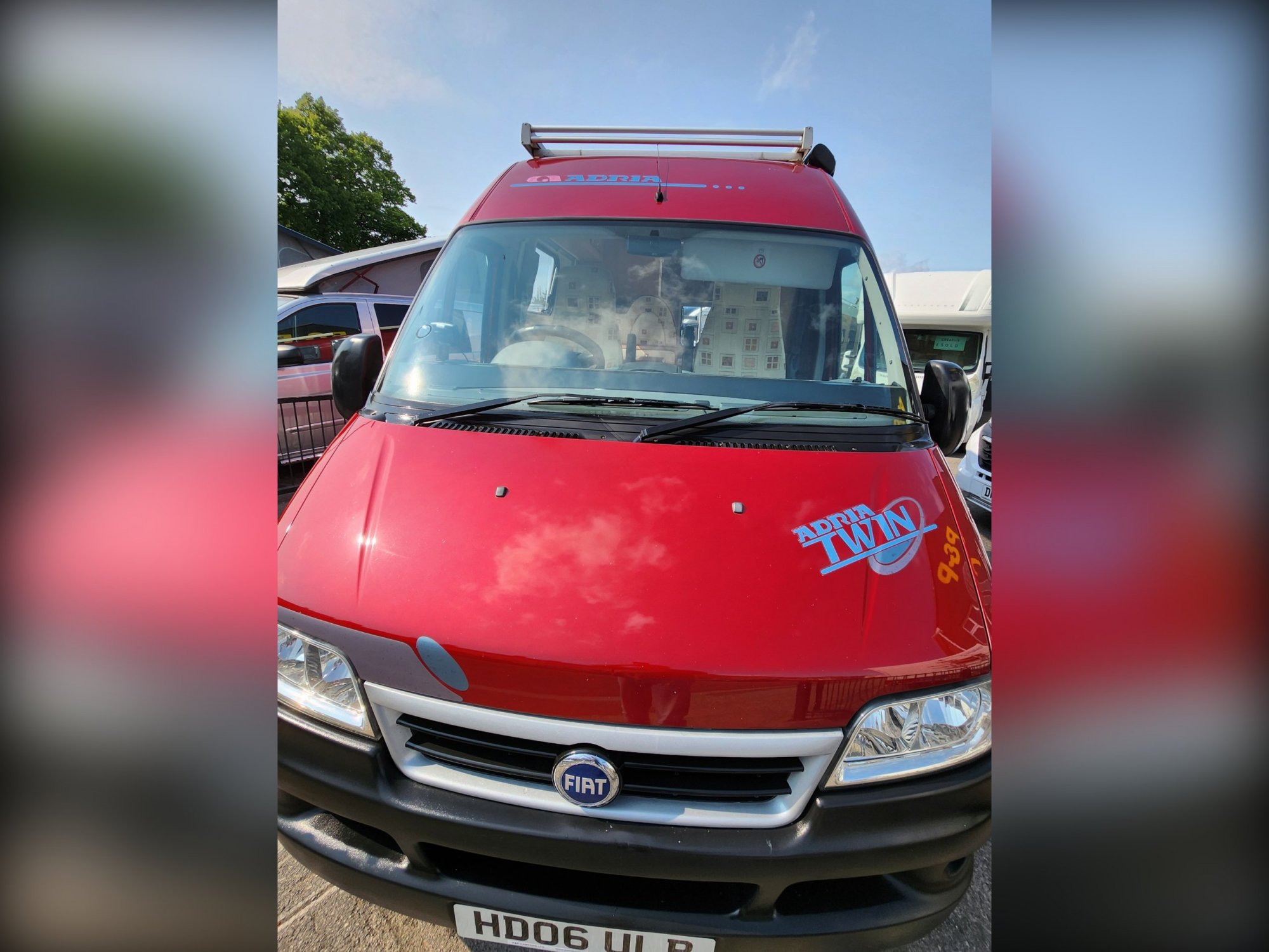

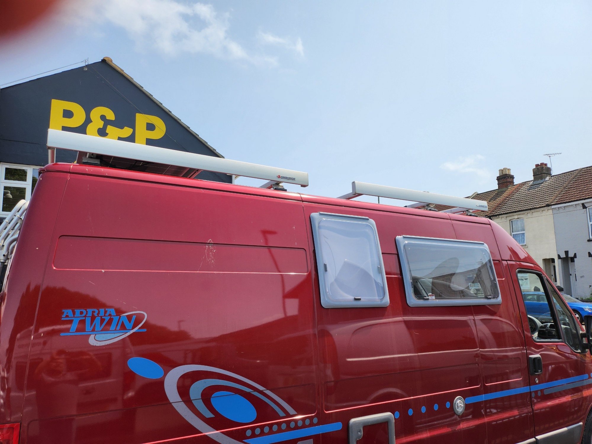

Getting a Ducato Campervan shortly and it has roof rack ,bike rack ,and ladder attached and I will be removing it all and putting it all up for sale I believe it all to be OMNISTORE ??
