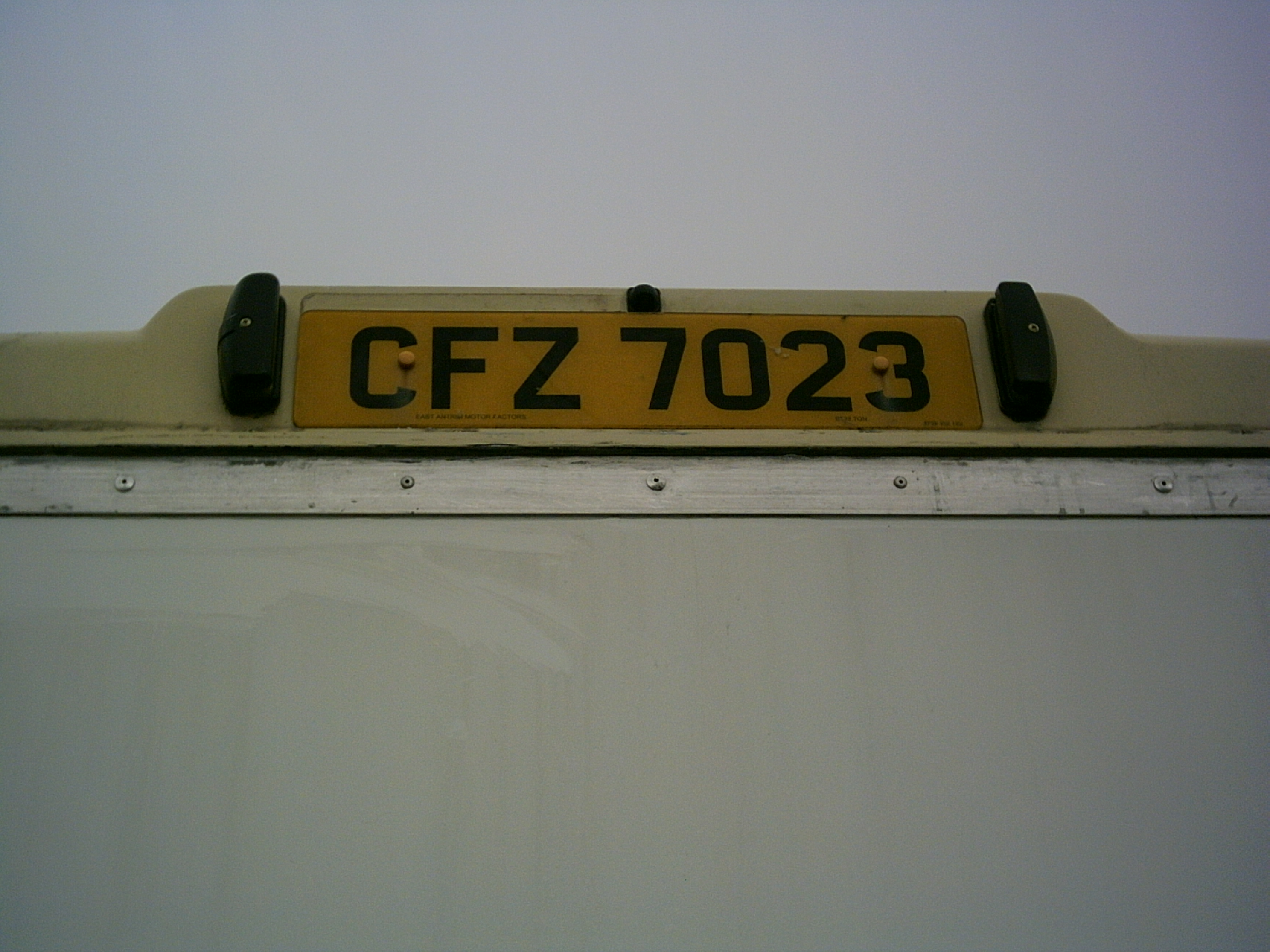

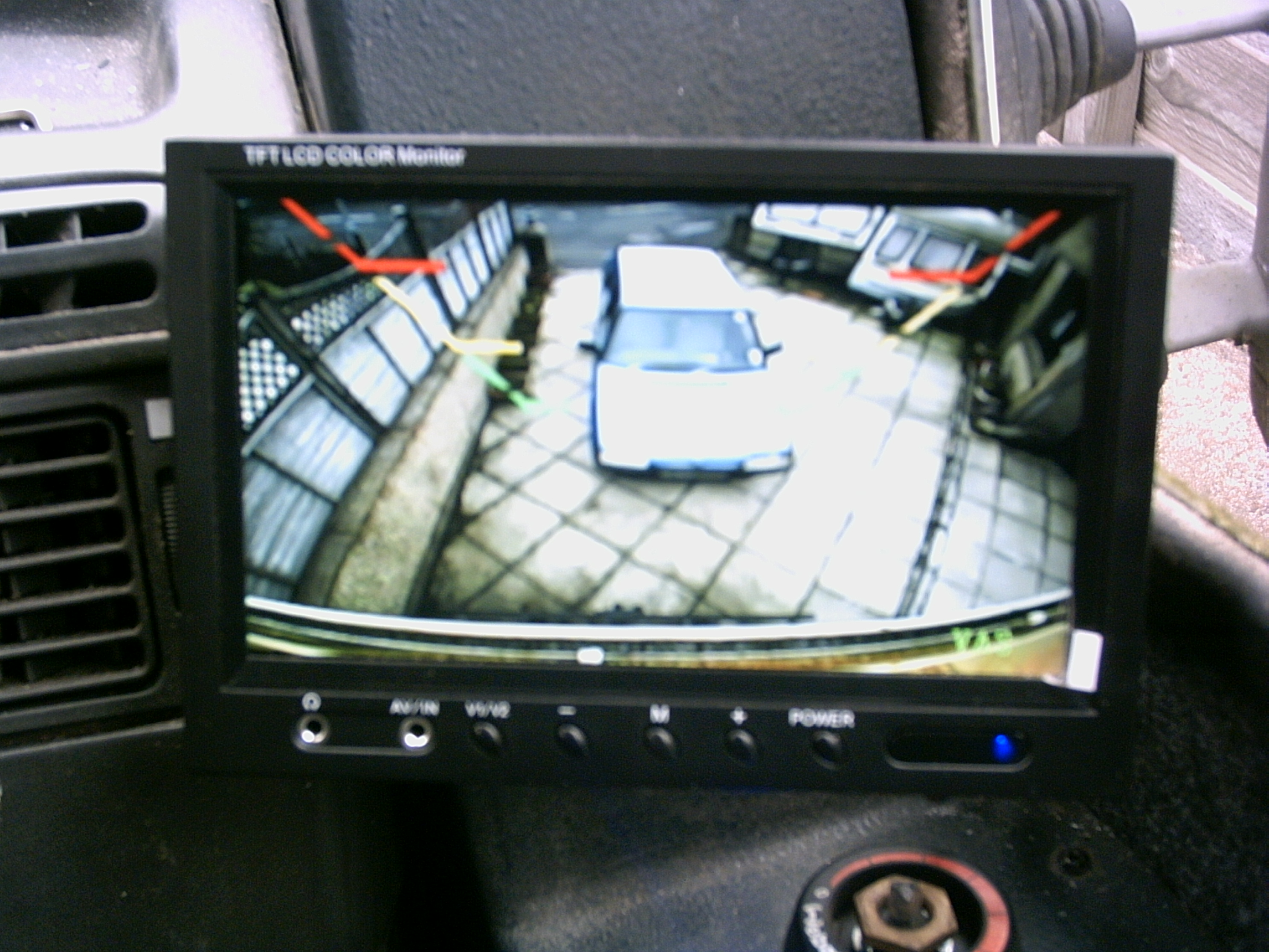

one from china ebay 25 bucks,working over 5 years no bother

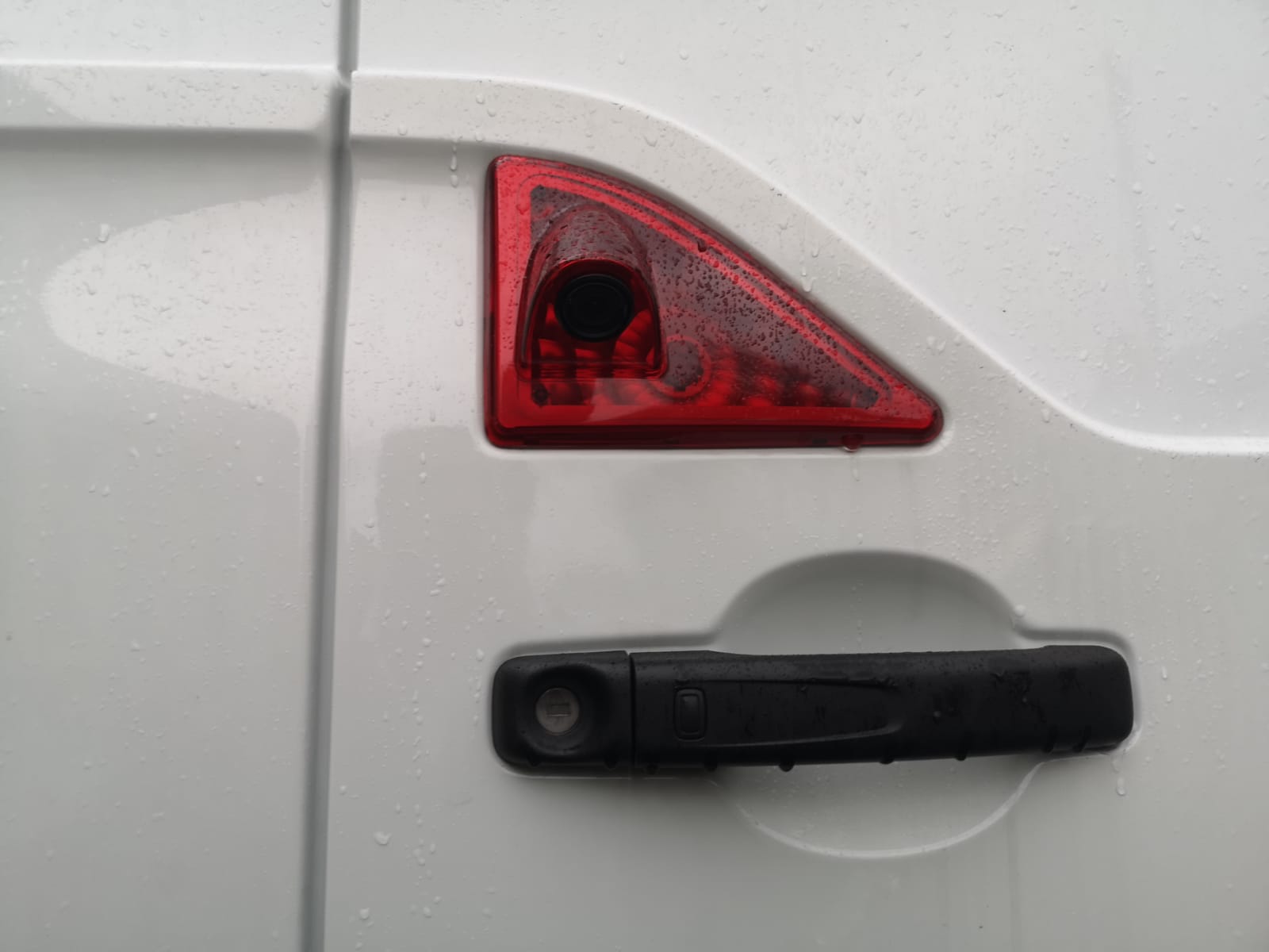

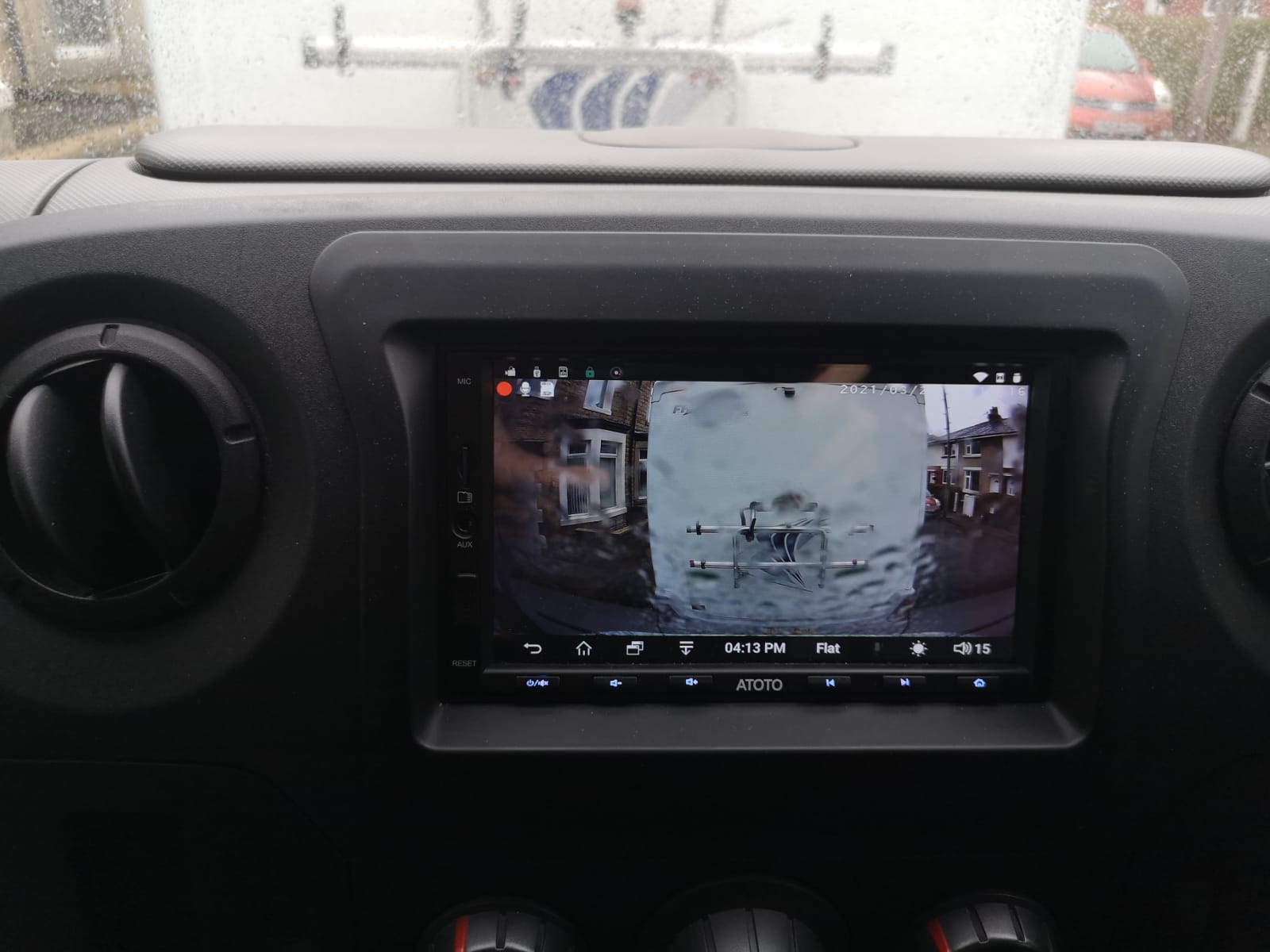

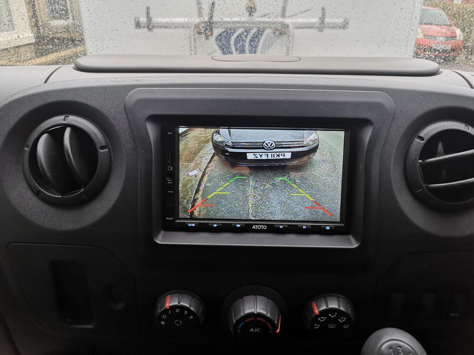

I fitted the the Renault Master door brake light/reverse (didn't buy from Renault) camera but rather than have separate screens for satnav, reverse camera, dash cam I converted the radio from single to double din head unit and will use copilot for navigation and have the dash cam and reverse cam on the one screen.
