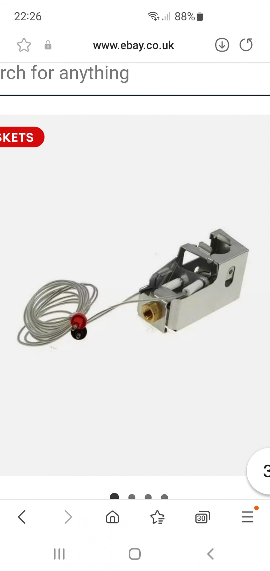

This is the burner it is an integral unit jet, diffuser, thermocouple and ignitor.

Ah.
The thermocouple cable is sometimes a co axial Jobbie, if so it's a pain and a bodge to cut and join. The ignitor could be cut and joined but you need to be careful with the joint because it's carrying several thousand volts, it needs insulating well. Depending on where the spark generator is you simply may be able to remove and replug the HT lead.
Can't you simply remove the jet and burner and replace just those bits or remove and reuse the electrode and thermocouple off of the old unit?

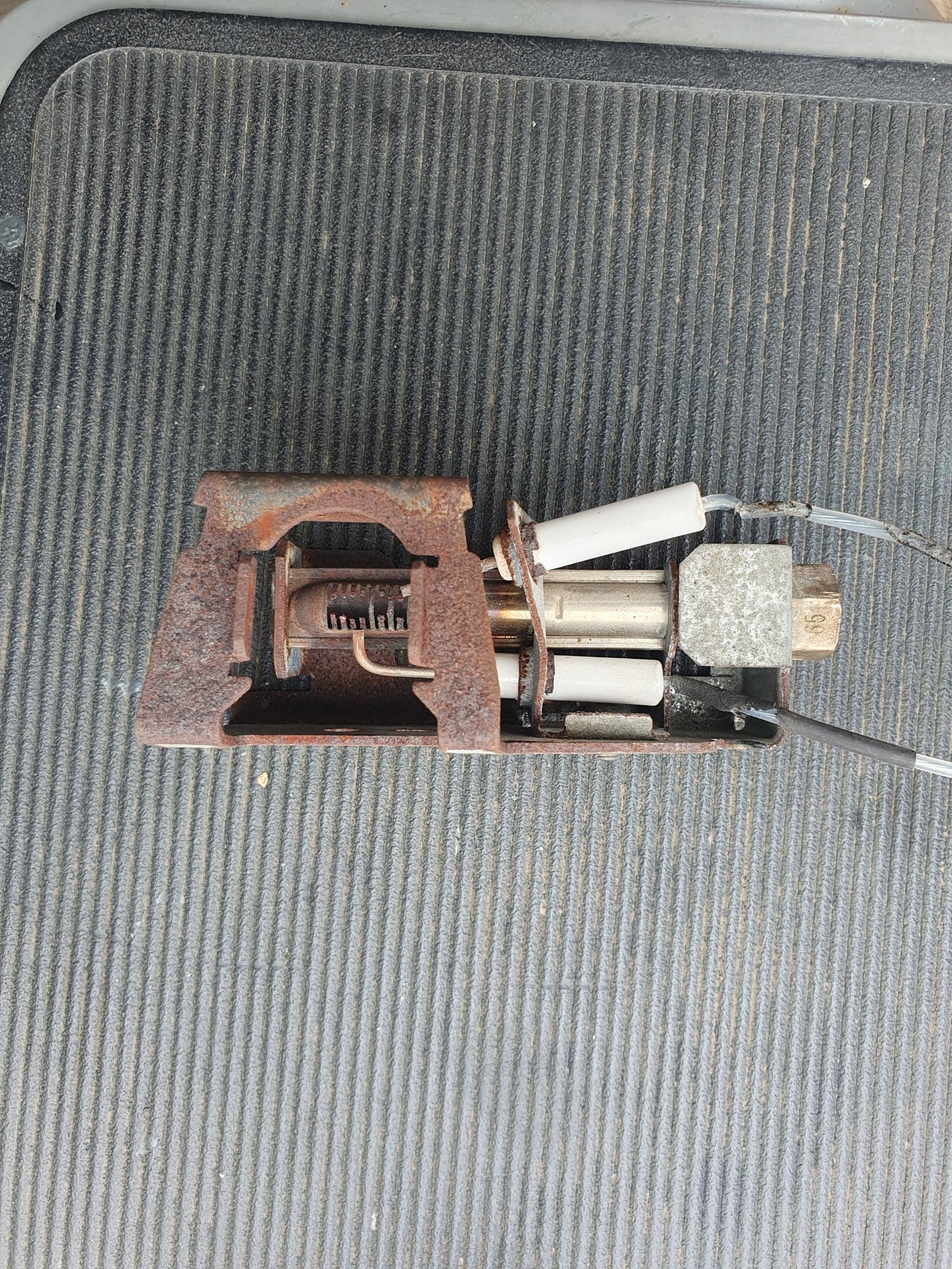

This is the old burner It won't let me up load video of noise It was making.
New one is in and been in fir an hour vanes are cold and registering -10 on heat gun

Follow up Hymer 544 year 2000 fridge RM8501 new in 2020 control panel at front failed twice recent Euro trip gas cooling failed, on inspection burner corroded and very noisy flame
Gas burner replacement straight forward undo nut that hold burner to gas pipe undo screw holding burner to chimney
Pull out thermocouple and ignition wires from control module and remove.
I did undo gas supply and pull forward fridge halfway for access. Could have managed without doing this
Fitting was reverse of above
Total time about an hour
Beautiful quiet flame and very efficient cooling now
