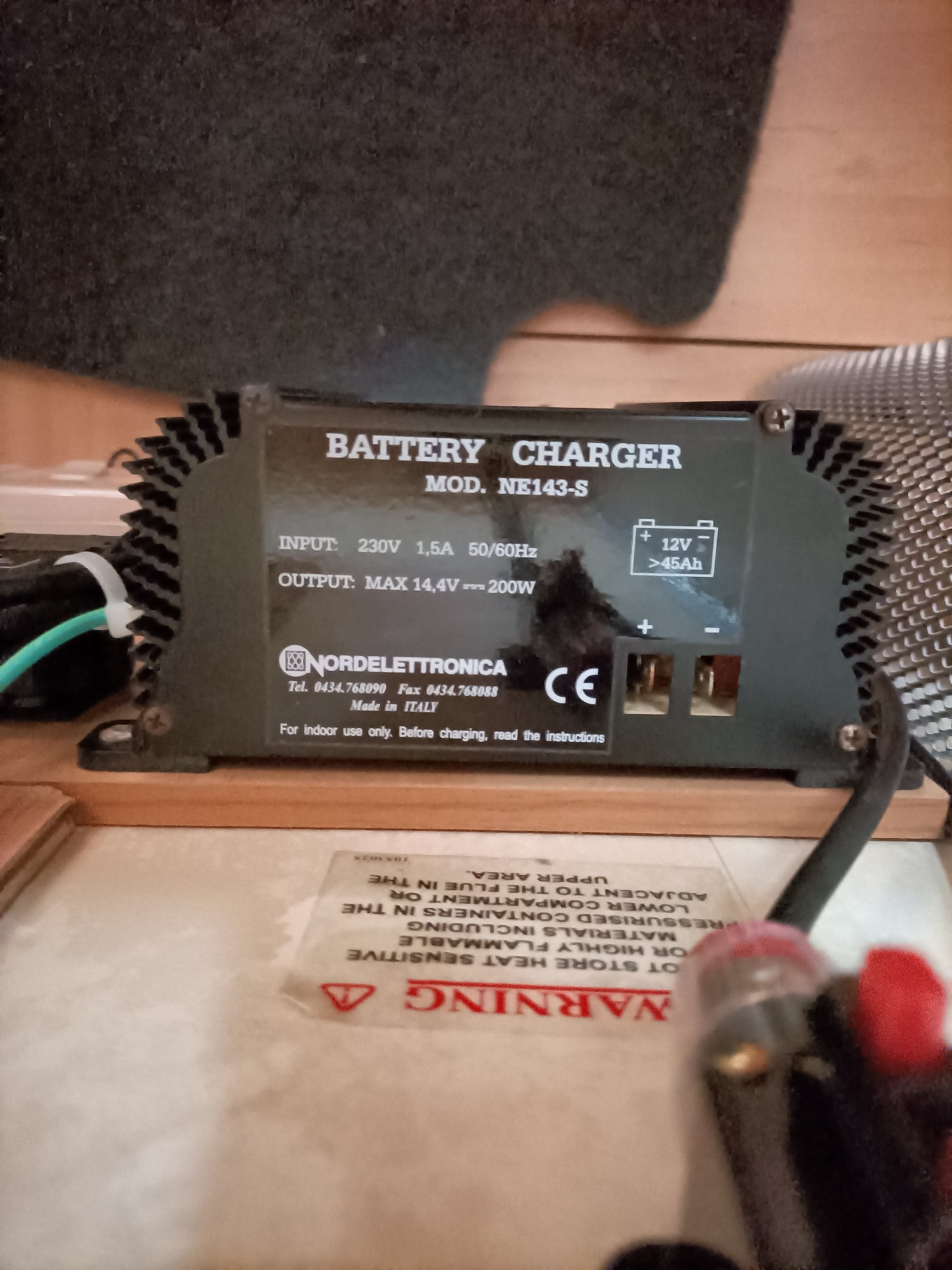

Called into storage to check on van. It has a nordelettronica 143-s. Rated 14.4V 200W, which means 13A. The charger fuse by the battery + terminal is rated 20A.
So I would be happy connecting the 15A, but 20A might be upper limits of wiring loom.

I think 14.7 is the voltage, 14.4 is for lead acid batts
sZFWnM-vt2HcR0zE2hPqQLRv3nXNk7VrWCPSfO1tcO_qYWO7jZa0iO1R1iYmg6BeTI_Z7gZ3CjqfrNAlvi0xmQOvB7DlOMrG9COlqO_Xv-mW53HHlzJYeIqus9TG69g8zLc-5snrEcfipkvEaYPWqT2ODjAdVei4jrQUPeDQNOoP5Ctd36upGQbDiqFiyZHFNN_fuVb2kDFI3eGK2WVp_y6ZtRUOnLI1FrVeeApq1gBvvuiVFwXWCYCrET8FuzOkKf1hw92vxxSf4LDKDreOQHLqVyChWdozljO1fovvcRYwDq2-IEg2S6QAlkr5f0Ai_KVf_WkOgRAPw_gPPTZnm6ldhxb6Rxt2snYVXf1j7jD1d5KBri4JM8IMnCscrvKvl35mAAS-iX5hCdTuFryJ0DiuLbMI1XSB0wmNhkazTmy_Ld5qoWjRUylK27vzQY8Io39Gr1UxrGl4zODTqtU1-YPHyUDa74KK6XlkMzS3TqI6PtdLnIZsoIJ9FyLV1yzSH8Lylz_h1F1jD9cM8LAEjRfFhW7q92nXnlcyOmJeA9ly-fesvbFBbqE4eK6MeNPI5C2tI-ai69cQRB5fRfwReji9iyDEr-qQuTP1BPUq2DLtCaXXSs-_ynmtPDNVEBwAc2RfrmGhyhcPLD0Vihv1KhI4L5ScVam9Ep98ya8VwQYGFpANwUfoB-z2Po--DNrXBwHIXIzBYRDXuE0J0Uyxtq9M=w469-h625-no
Probably why it is not AGM compatible needs to be 14.7VIMG_20211103_203134.jpg
