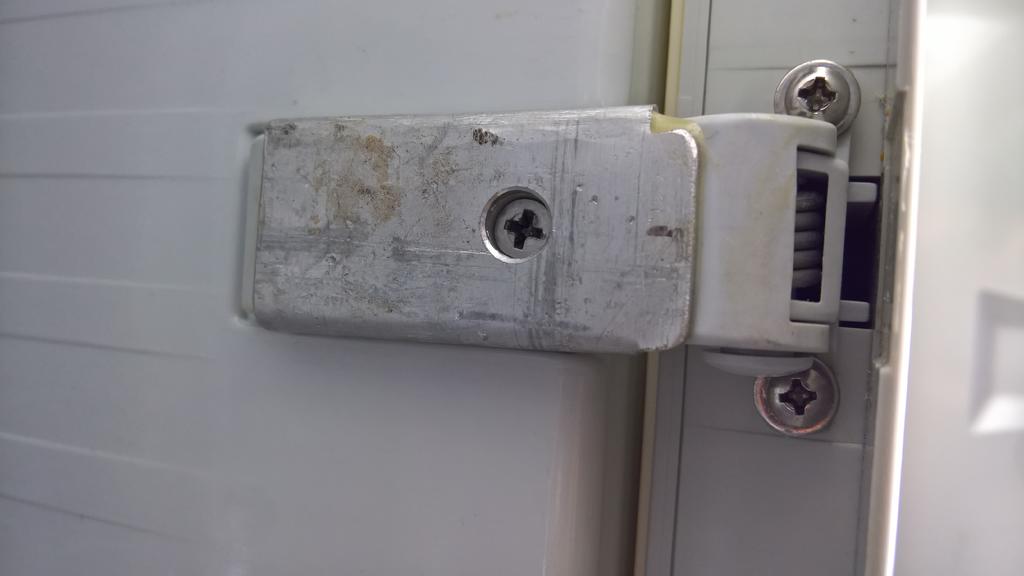

When I bought my Autosleeper Palermo one of the hinges was broken through and the other badly cracked across the plastic surrounding the retaining screw hole. The dealer replaced both hinges but within 2 years I noticed that both hinges had started to crack.
I removed the hinges and bent up a couple of pieces of aluminium sheet to cover the hinge part running under the freezer compartment. This was then fixed in place using two-part Araldite epoxy resin (the original version NOT the rapid cure version!). I decided to leave a hole in the aluminium for the original fixing screw. So far the modified hinges have held up very well. I'm aware that this doesn't help the OP but perhaps others may wish to inspect and possibly modify their hinges as preventative maintenance?
