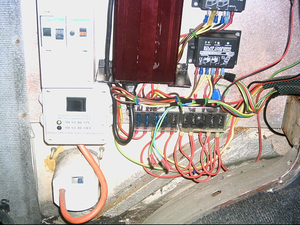

Have to agree with above post,you could have changed to a numax charger and a battery splitter plus new fuse box and rcd for about £150 all in.
W hich if one unit goes down easyer to replace that a whole unit.

I have sympathy for this approach and also for @Donnie having the Calira repaired. The Calira EVS charger is a great unit, but it doesn't seem to cope well with unusual charge loads (dead leisure batteries, for example), so they have been known to blow.
Using separates such as this is certainly flexible and probably cheaper than a repair, but you have to have the space to locate them all, and the inclination to do so. Forking out £200 for a plug-compatible replacement can often seem a simpler / quicker to fit / less risky option.
Having said all that, I have a degree in Electronics, so if my Calira went pfutt, my first approach would probably be to try and fix it myself (no guarantees, as my electronics is pretty rusty - I've been a software engineer most of my working life), if I was unable to fix it myself, I'd probably go down the separates route.
My Calira is under a bench seat in the lounge, and takes up very little space. I certainly don't have wall space available such as in your photo. So, I'd have to construct something that kept it all together into an enclosed space.
If you have a lot of space and the necessary experience then individual parts are probably more cost effective.
My charger is under the drivers seat , easy to get to and replace but it would be a nightmare to re run cables and find the additional space- horses for courses i guess.
