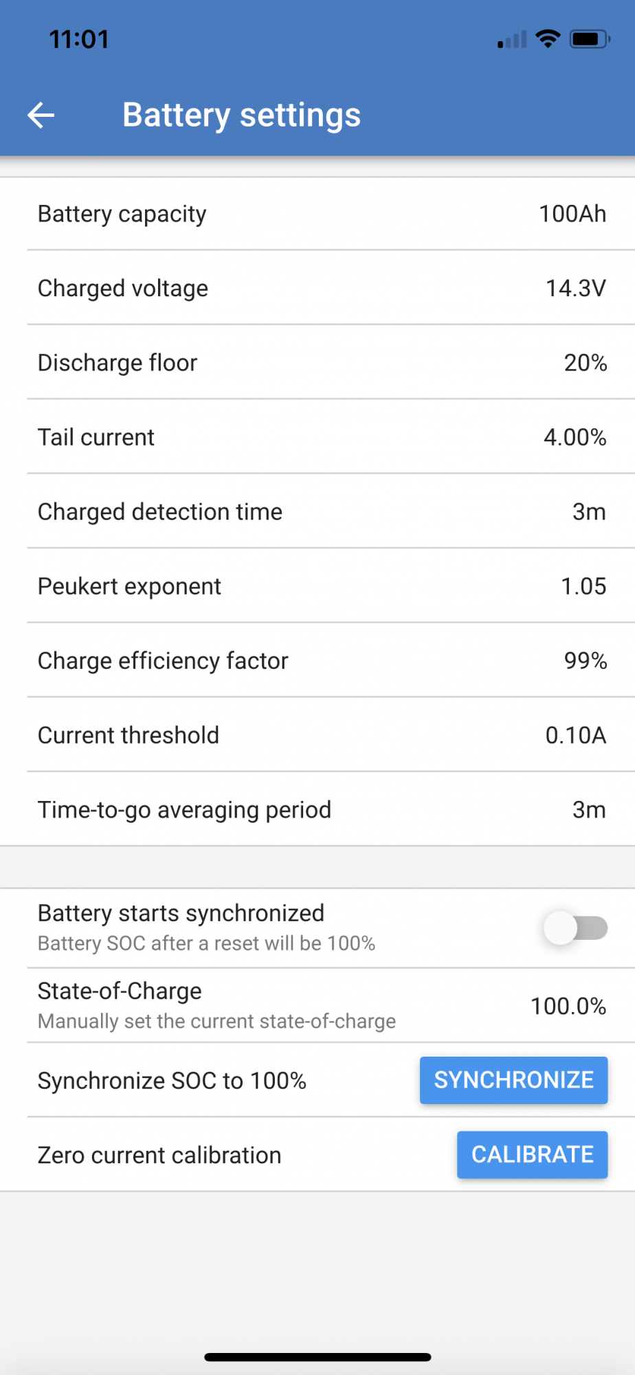

I've stopped looking at the percentage and now look at the volts whcih I assume is always correct even after losing the connection with the batteryOne great (or really not so great) feature of the Victron BMVs are if they lose connection to the battery, when it is re-established, the SOC is reset it 100%. This can be very misleading, like possibly in your case if that happened. I usually change the behaviour in the settings so instead of resetting to 100%, it resets to "- -". At least that way you know the SOC is no longer accurate and needs attention.
Going back to the SOC, if I plug into EHU and charge my batteries overnight is safe to assume that they are fully charged? If I put a meter across the battery what should I expect to see?
