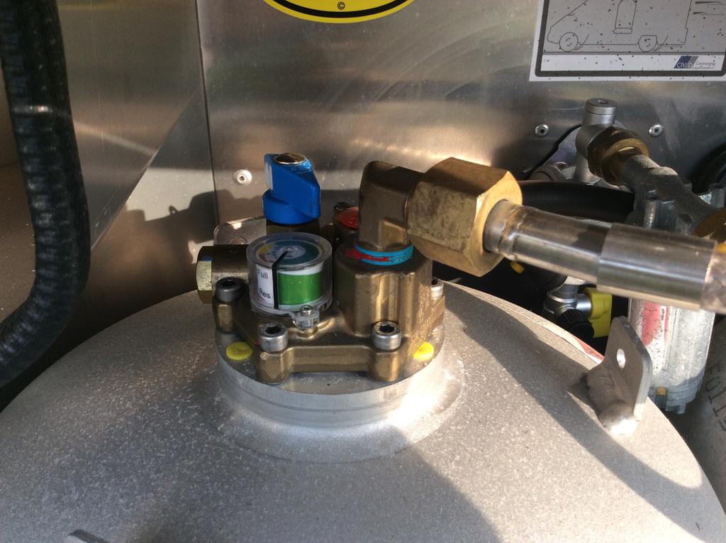

Ok, no problem, the first pic shows the external view with the filler point fitted into the skirt. The internal view shows it is a tight fit but you can get a twin 11kg system in. The third pic shows the top of the cylinder with the accurate gas level gauge. The same system is on eBay at the moment supplied by Autogas in Thirsk:

There must be a mobile gas fitter in your locality who could install it, or have a trip to Yorkshire!
