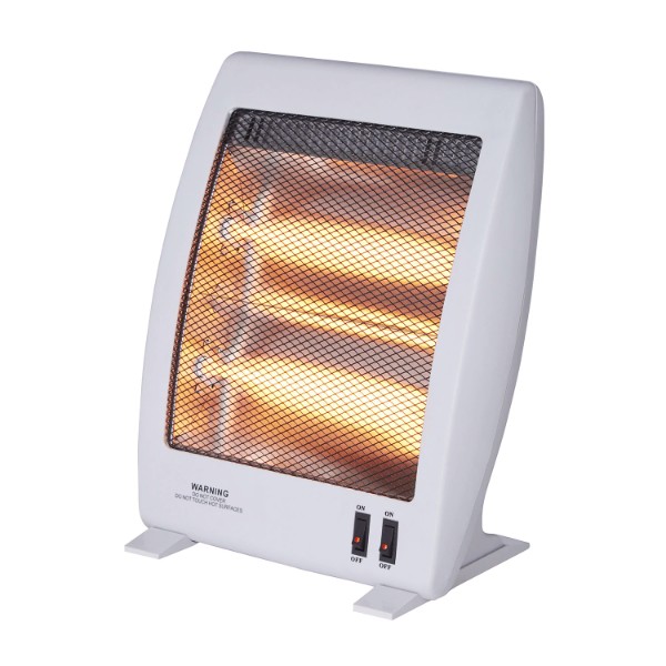

Also on the Van for electric I have one similar to this, left by the last owner, also around 1KW and with No Fan, the Inverter can power it though obviously kills a 230AH battery bank in pretty short time so don't use on battery
