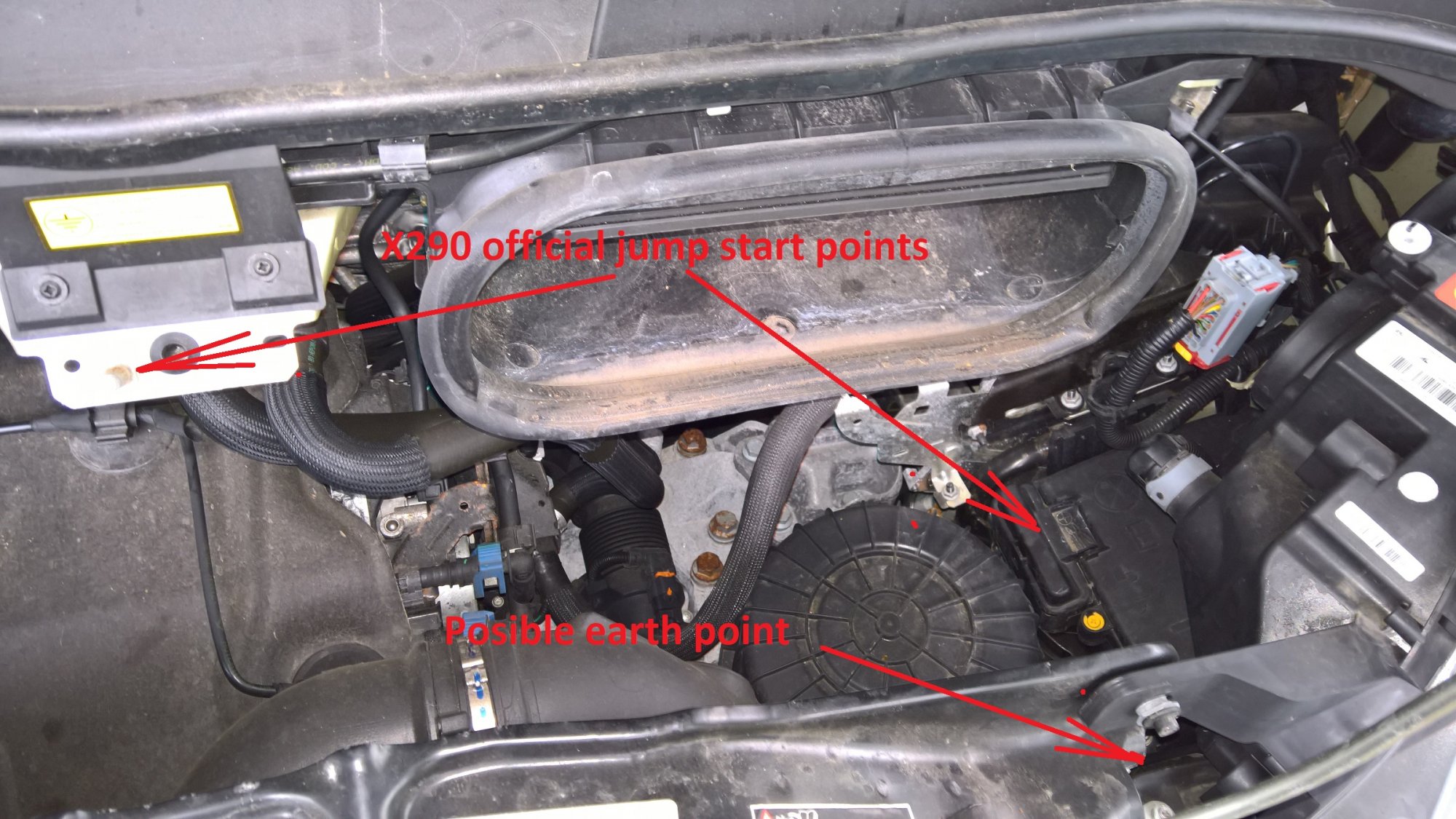

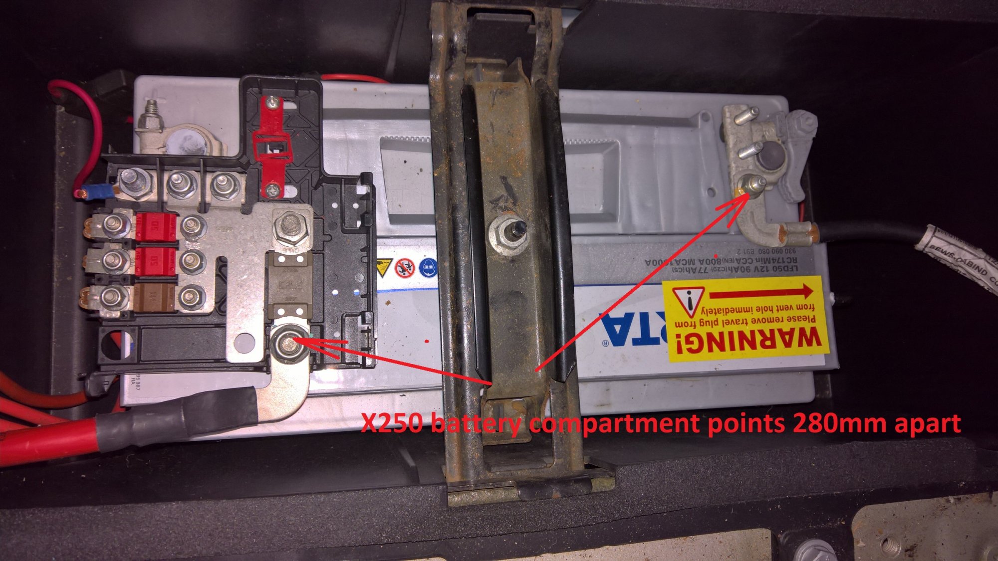

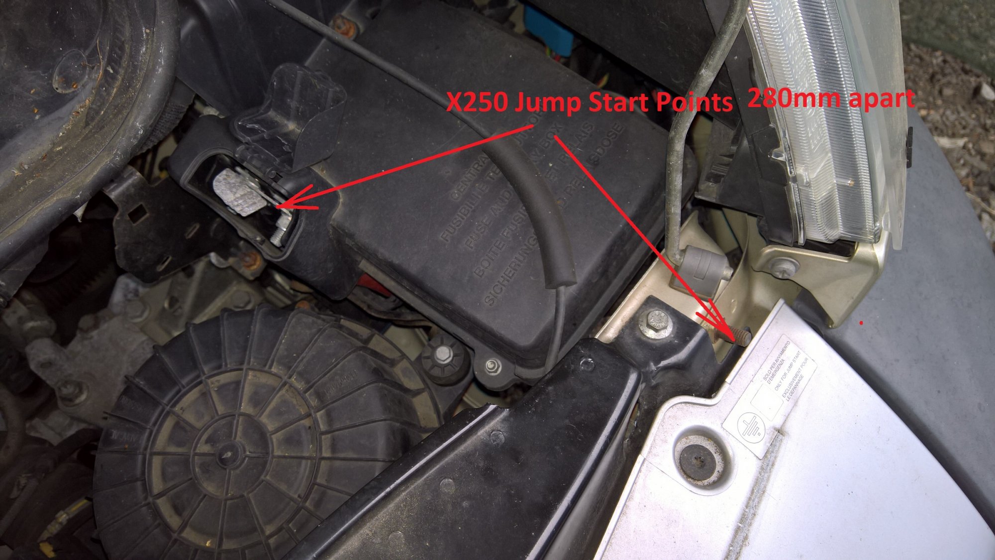

Was 'having a play' with the vans this afternoon and cross referenced the jump start points on the X250 and X290 and the battery on (our) X250.
As I thought the jump start points on X250 are actually closer together than the battery terminals, but with the 'gubbins' clamped to terminals the points you would clamp to are as near as dammit identical distance apart.
The X290 is very different, the 'official' jump start points are quite a way apart, but there is a bolt/screw on the top cross member which looks like it would make a good earth point.
